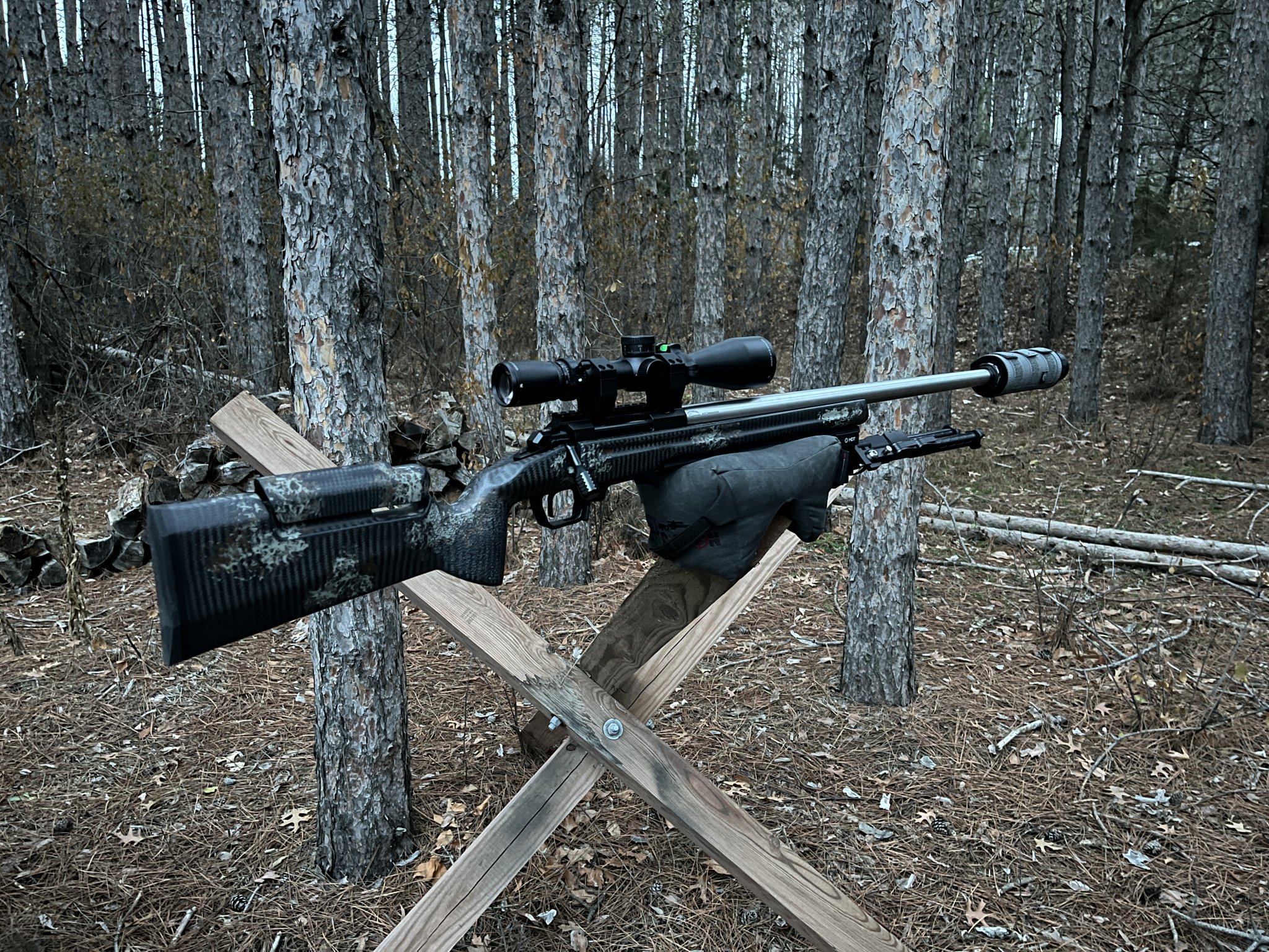

    Got my PVA Solus out to the range today for its first test. Picked up one of their $1,100 barreled action deals with a 24” M24 contour in 6.5C.
    Build list:
    Manners LRH
    Sawtooth ARCA rail
    MDT Precision Bottom Metal
    AW mags
    TT Special
    Vortex LHT 4-22
    1.26” PMR rings
    MDT double pull LW Ckye pod
    Nomad Ti w/E-Brake
    Intent is to be a <16 lb NRLH build. I undershot and it’s sitting at 14.75 lb. I’ll probably add some weight to the inside of the rail &/or forend.

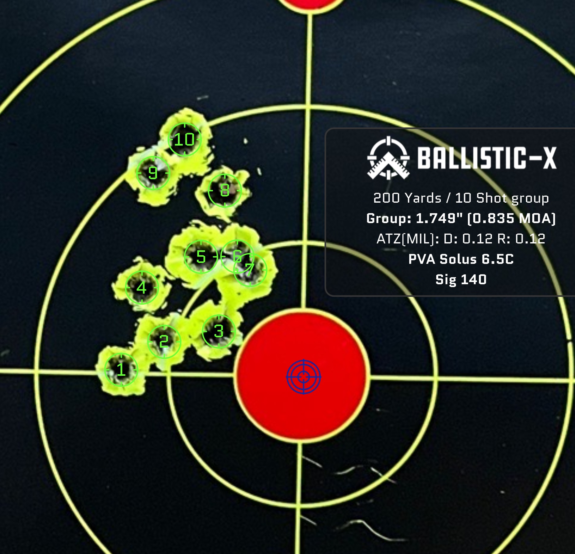

    Then 200 yards with the Sig 140:
    Ballistic-X-Export-2023-12-21 17:43:10.296855.jpg

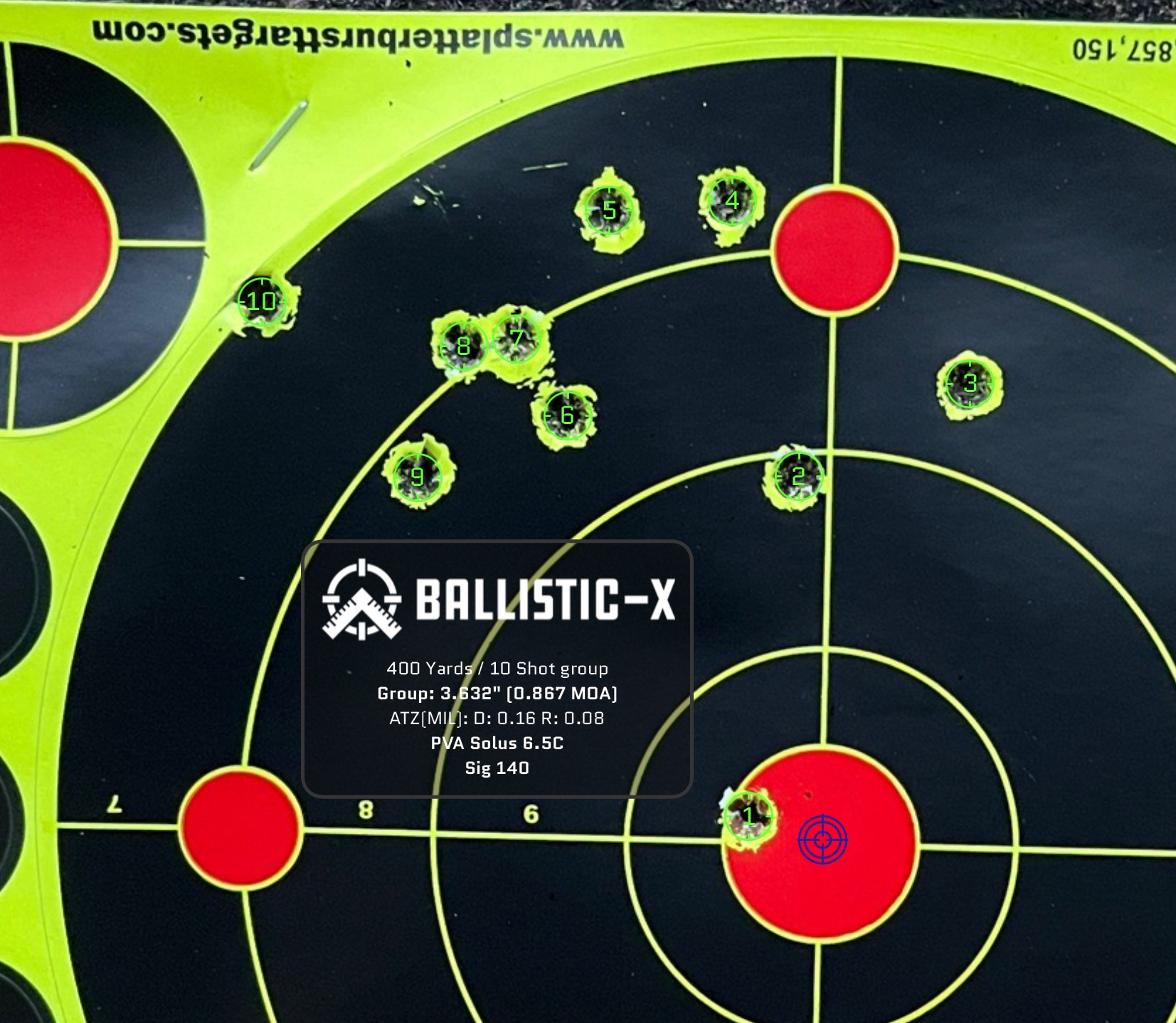

    And finally 400 yards with Sig 140:
    Ballistic-X-Export-2023-12-21 17:40:57.978594.jpg
    I had to rush the 200 & 400 yard groups due to dwindling daylight, breaking shots when the mirage let me see clearly rather than watching my heart and breathing.
