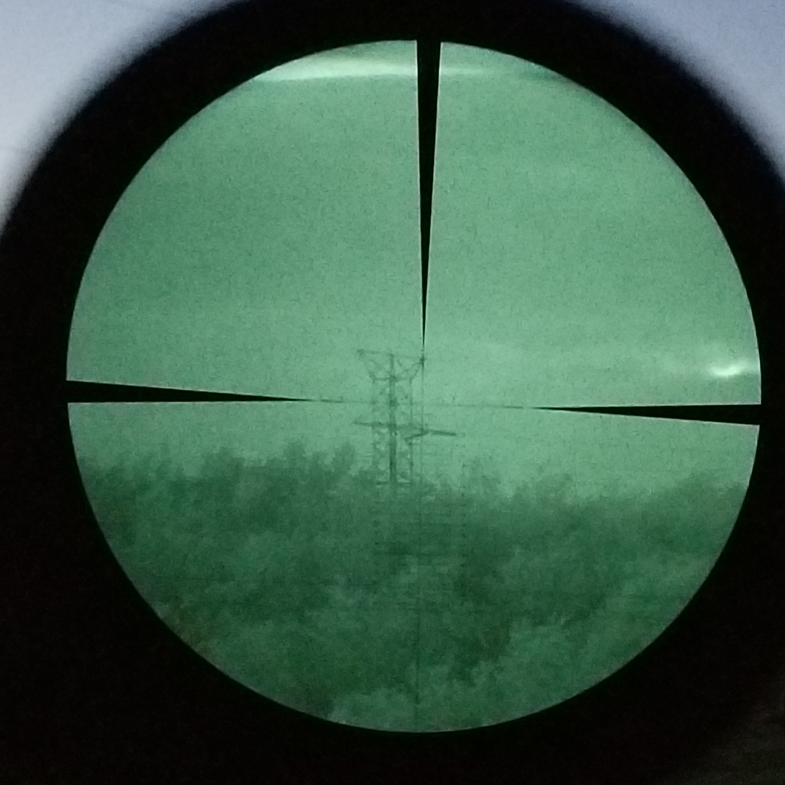

Can you give me some details on your picture? What magnification are you on in this picture? What distance (estimate)? What were the lighting conditions? What tube specs do you have? Just trying to gauge what the average is vs what you have.
I thought that WP units weren’t available from L3 to non-mil/leo.

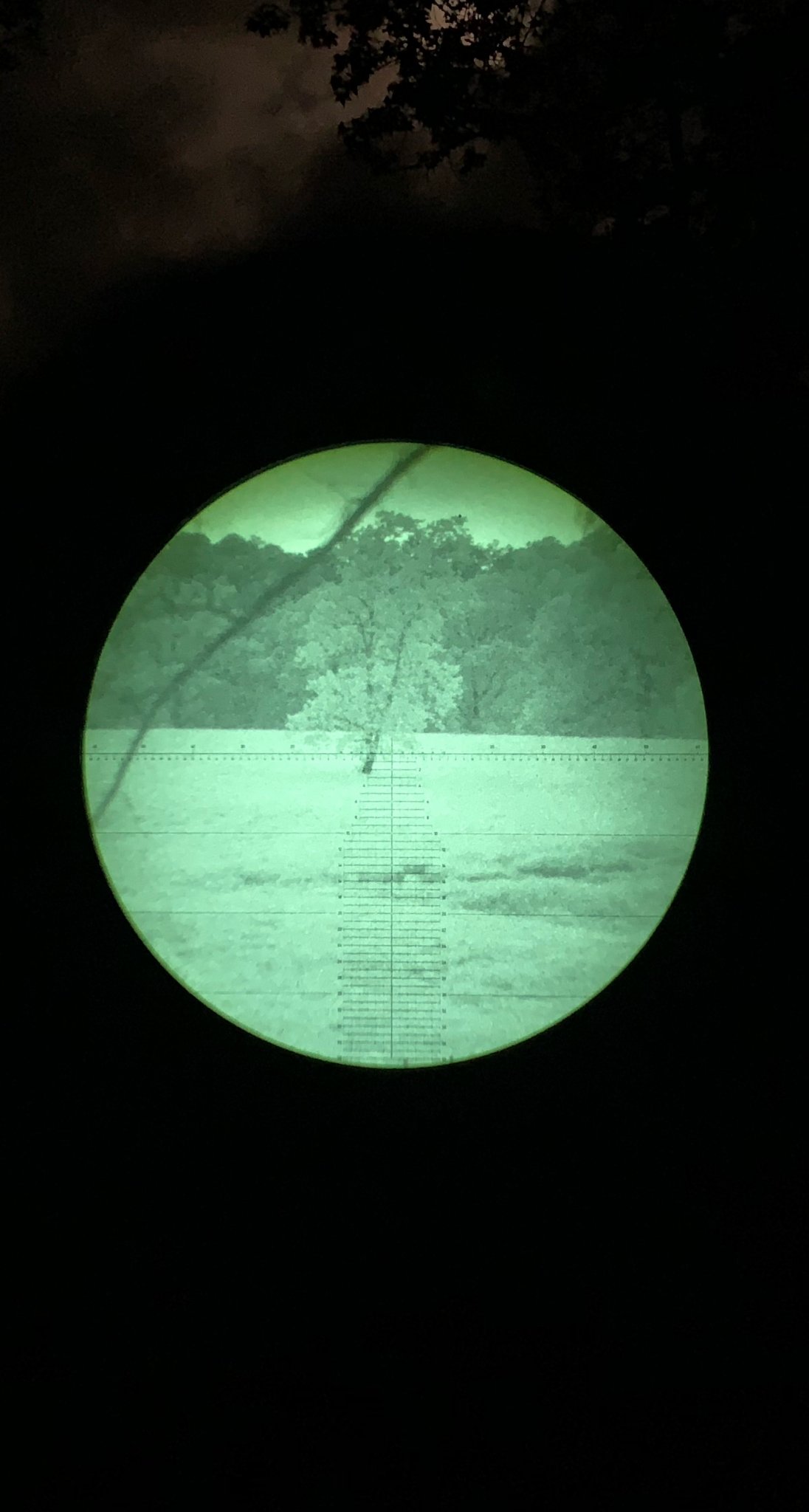

It's a filmless white 24LR (not regular ole 24) with 2376 min FOM.
Distance is about 550~ yards to the base of the tree. No idea what magnification I was on, but probably something around 6x.
Lighting .. you can sort of see the moon glowing through the clouds at the top of the picture. I remember the night as about 50% coverage and I can't say if that pic was taken in full exposure or not. My guess would be full moon exposure. Zero IR supplemental light needed.

Thanks for the specs.
Anyone else have any through the tube pictures? Skyscrapin’s tube is really nice, but not the average tube in most units.

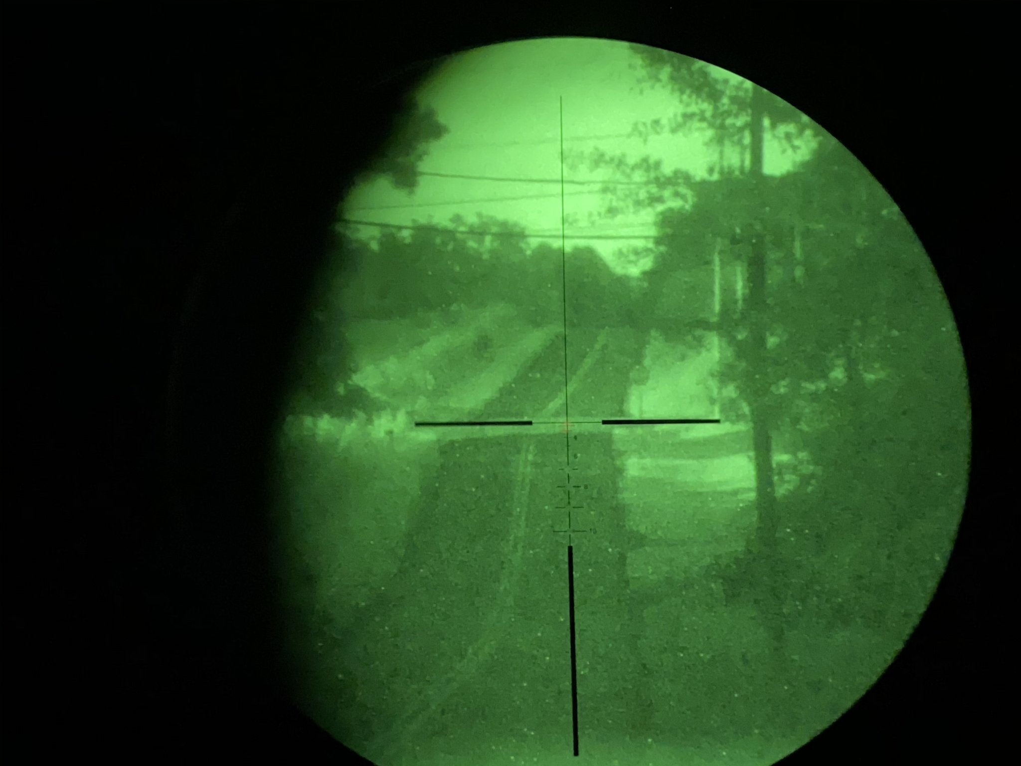

Here is my Best of Suck iPhone TTL ACOG/24 Faux Toe from last night. Will try again.
FYI, the illumination you see at the intersection is >200 yards away and is from what I’d estimate as a ~50w porch light. We’re in rural Cowtown Alabama. Zero street lights anywhere and moonless night as thick as spent motor oil.
This is the full monster pic for download eval.

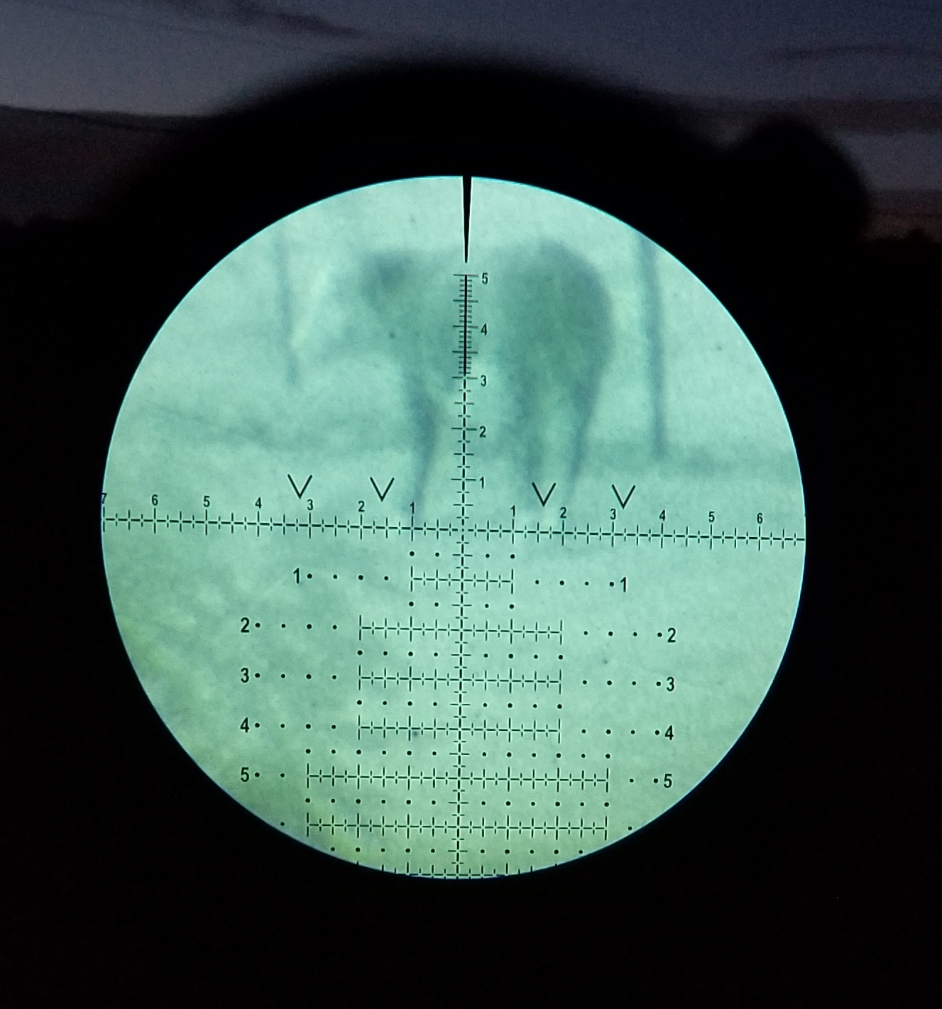

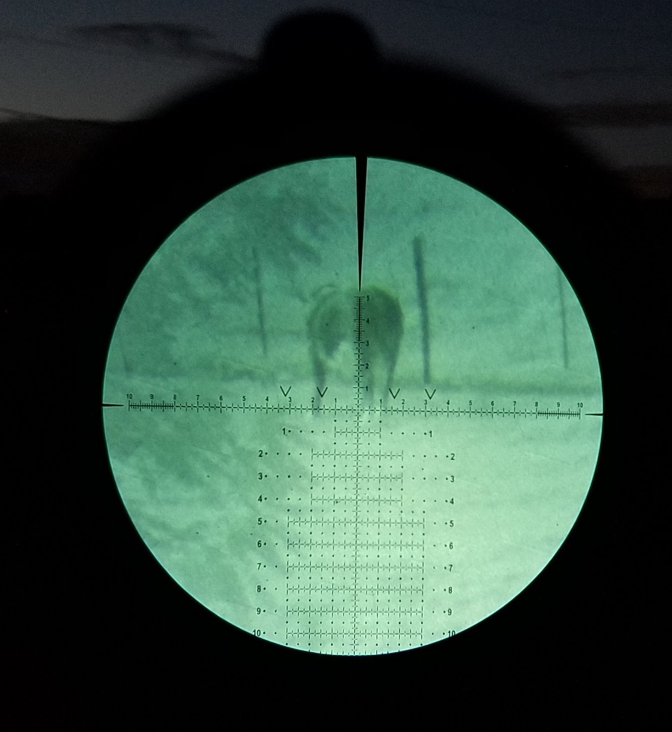

How much ambient light is there in those pics. Looks like maybe just before it got dark.
Yes WP LR unit. As it seems with most phone NV pics it does look better and clearer in person. The " greener" pics are from the gain not being turned up high. Sorry was exited with the new unit. See OP was looking for std unit not LR.
