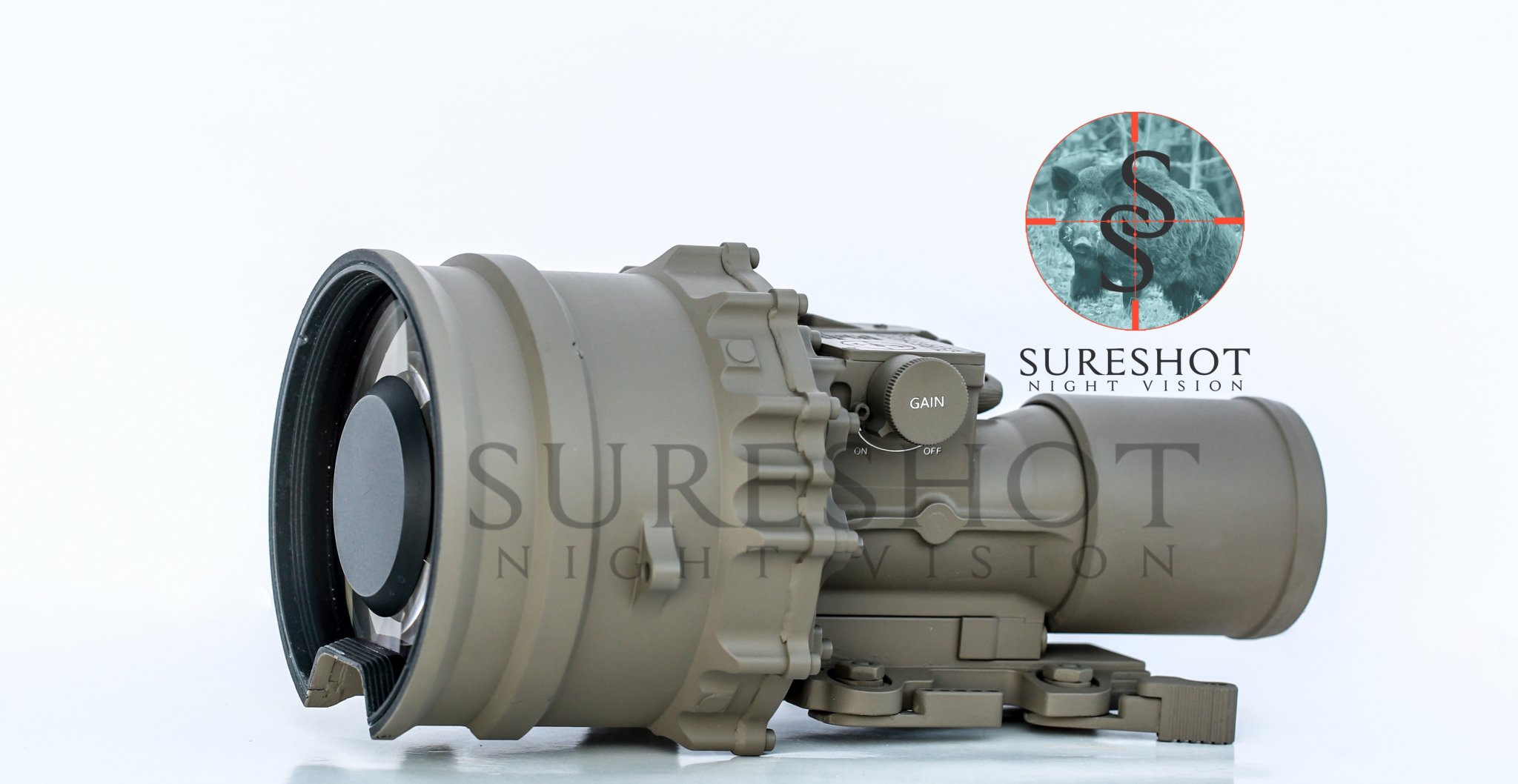

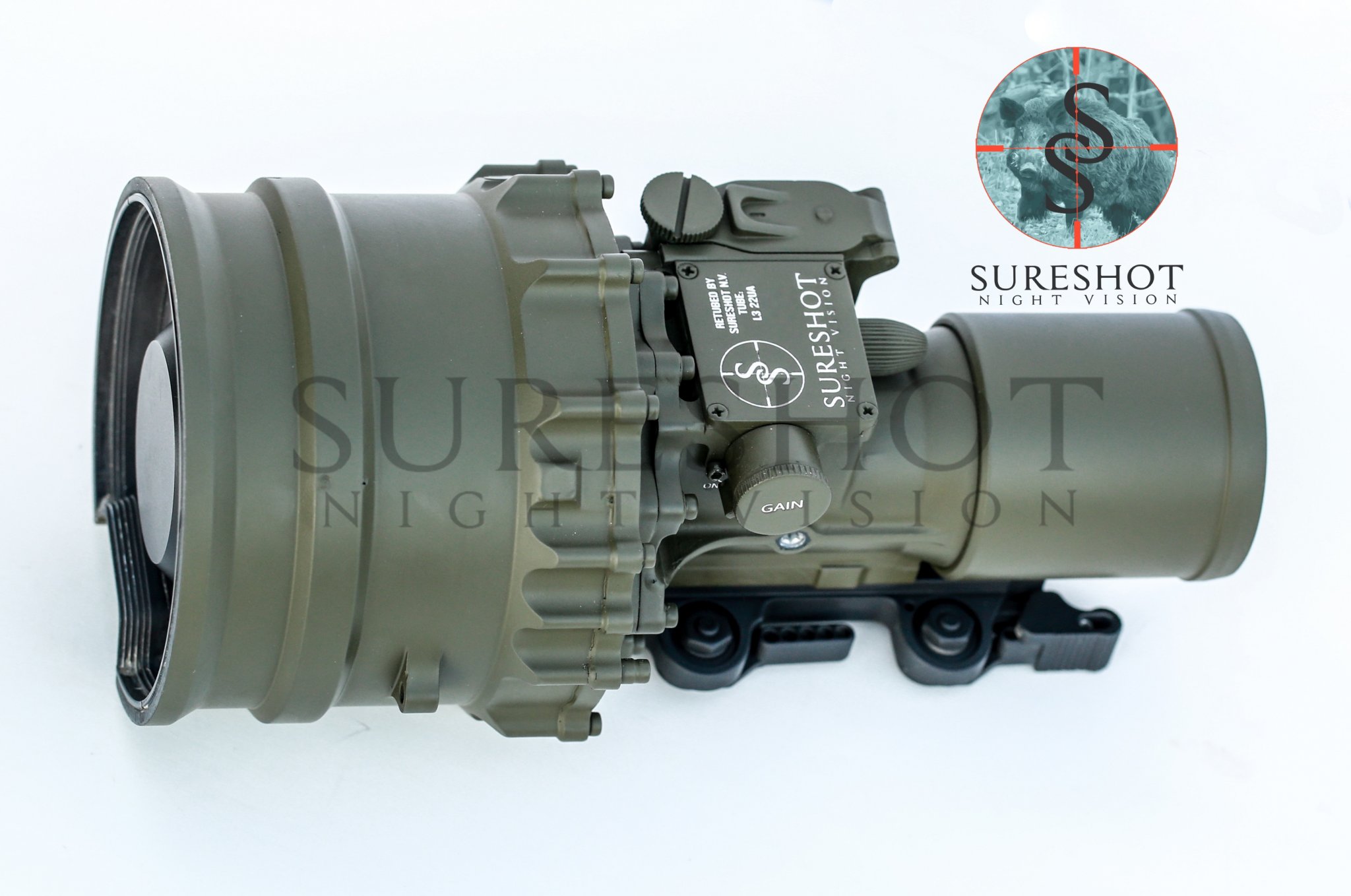

    Now after countless hours of building and collimating. We are proud to announce that we will now be able to re tube and properly collimate our customers Pvs-27s!
    The current L3 filmless 27 that we have been testing has 1/4 MOA shift (if any at all) and it hasn’t moved after 300 rounds of 168gr FGMM that have been fired under it. So collimation is well within Flirs claimed 1MOA standards.

    Complete unit with hand picked tube, custom coating and collimated.
    $10,500
    Send us your 27, we pick you a tube. This includes collimation.
    $5500
    Send us your 27 and your tube. This includes collimation.
    $2650
    Collimation service.
    $1350
    Most units have to be broken down completely to loosen the prism set screws. This involves several hours of labor to do, which is why this price is what it is.

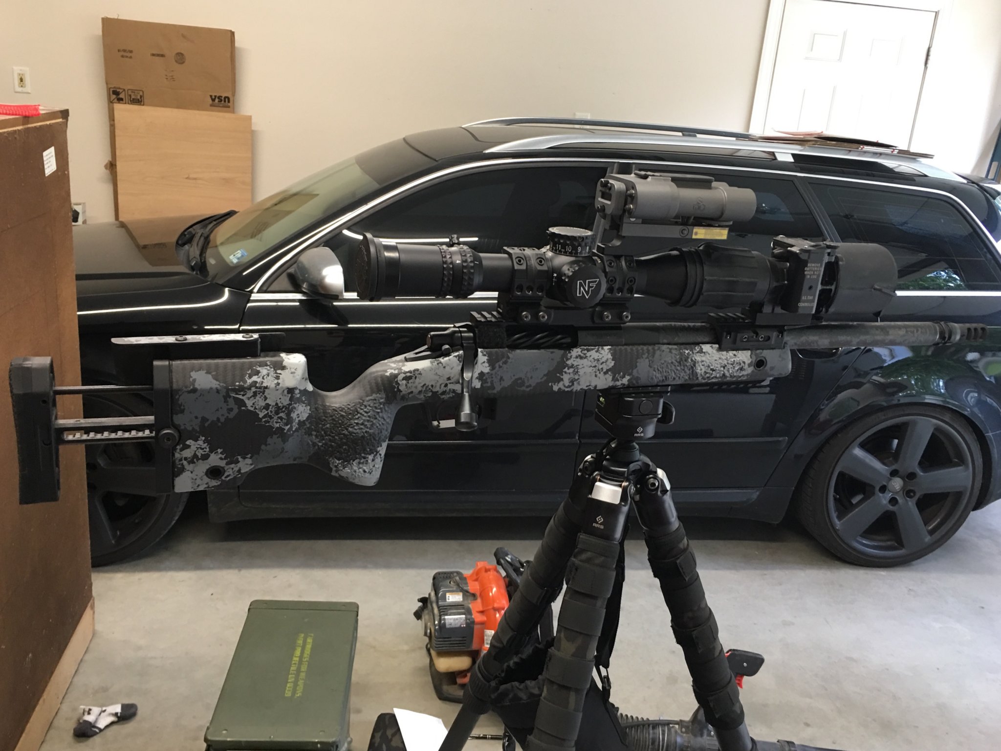

    So, one of the above units is mine, and I wanted to post about my experience with it so far, and with Jay on this project.
    First, as far as the customer service and communication, they are great. Tubes are hard to get right now, and this is a new project, so it isn't the kind of thing you can expect to send in on Monday and have back on Thursday. That said, Jay met every deadline he promised me, and was fully communicative throughout the process.
    As far as the end product goes, it is freaking amazing. I ended up with a 72/34.9 tube in mine. There are no blems, it is totally clean. It took me one session to get the hang of focus and parallax on the unit, as I had never really used a 27 before. I had used a 30, but sold it to buy a 27 for this upgrade. Without doubt, the 27 is an easier unit to focus up, but I found the parallax setting on my day scope needed to be different from what I was used to with the 30, but no big deal. Anyway, my first nights with it were with very little moon, and without illumination I could get a crisp picture through the whole range of the Kahles K318i I was using. I would say there was no degradation up to 18, but the easiest mag to shoot in was 13-14. Probably a personal preference thing. Mostly I use 18 max scopes, but as it got more to a half moon, I decided to put it on a 4-28 Steiner. Again, I could run the whole range, up to 28, without significant degradation. Would I run it this high? Not where I was using it as FOV was more important in dealing with steel targets tucked into forest, but on a longer shot I would have had no issues going into the mid 20s.
    Everything else about the unit, the finish etc is done perfectly. None of that really matters to me, but it clearly matters to Jay, and you can tell.
    So, in comparison to other units how does it compare. Flat out it kills other i2 clip ons i've used. Yes, the 2124 has better ergos, but the 27 is better in every other way. The 30 has worse ergos and a worse image. There is absolutely zero reason to consider any other i2 clip on when Jay is doing these, and given the collimation guarantee and communication, that goes double. Now, what about vs thermal? I would say that the unit is, as a clip on, far superior to the LWTS-LR. Clearly a lot cheaper. The LWTS-LR is a great stand alone scope too, so there is that. Compared to the UTC-xii, I would say that the 27 post mod is the UTC-xii of i2. One is not better than the other, they are simply a little different in what they offer, and in a lot of ways it comes down more to personal preference than anything else. The 27 resolves better at the highest zoom, the UTC is more ergonomic. The 27 kills it in the bright half of the month, but the UTC is better in the darker half. Just marginal differences, though. More than anything, it comes down to whether you like i2 or thermal.
    I can give my highest recommendation to Jay and this product. I will snap some on rifle pics later, but I don't know how to take through the tube shots. The image looks like Jay's pictures and video, but without the short shorts. Just too cold around here, and I don't like to shave my legs.
