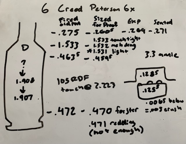

Ok, so I ended up isolating it as the shoulder by comparing it to a piece of fired brass. Interestingly the brass will still not chamber unless I crimp the neck slightly.
If thats true then your first statement where you compared the diameters was incorrect.
Share the actual measurements of factory, fired and sized. The answer is always there. Write them down and sharing em will always highlight what the conflict is.
I this example I was having issue with the base sizing, redding die i was using with the old barrel wasnt sizing old brass out of the old .472 chamber enough to fit in the new barrel, the forster die allowed it to by going an extra .001.
When comparing those above measurements to the brass after it has been fired from the .471 barrel it is clear that prior sizing of the base to only .471 wasnt small enough.

No, my initial info was correct. However I purchased new RCBS dies yesterday at Sportsmans. I used it to bump the shoulder back and then resized.
Ill just let you read what you wrote and let you explain how its correct if making a material change in the brass fixed it. If it didnt change the dimension in some way then you fucked up your measurement because it cant both be and not be.
