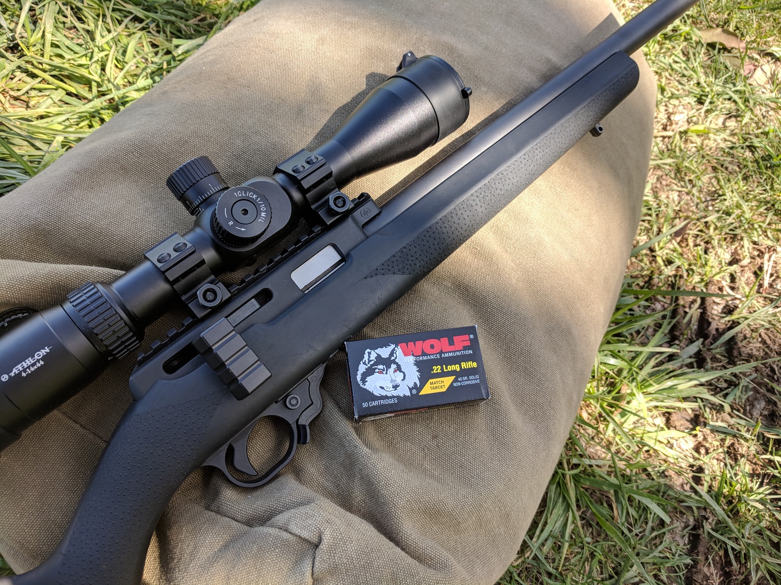

It took longer than I had expected. But I think I've got this one dialed in.
Today I got rough drops to 190. Also printed a few groups at 153, and 112 recently. The athlon talos 4-14 is here to stay. Good, repeatable clicks. The feddersen barrel is doing its work with wolf MT. Surprisingly, it's about the only ammo it shoots. Tried some high dollar lapua and eley to terrible effect.
Action is smooth and reliable. With a can it's just stupid fun to shoot. I a love to try out a titan Victor on it. Other than that, it's nails.
