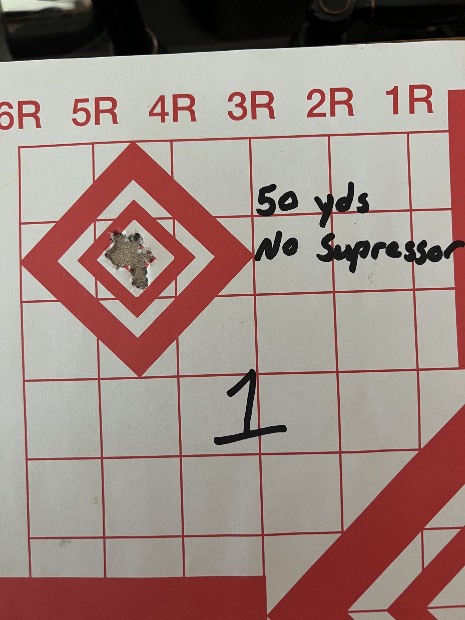

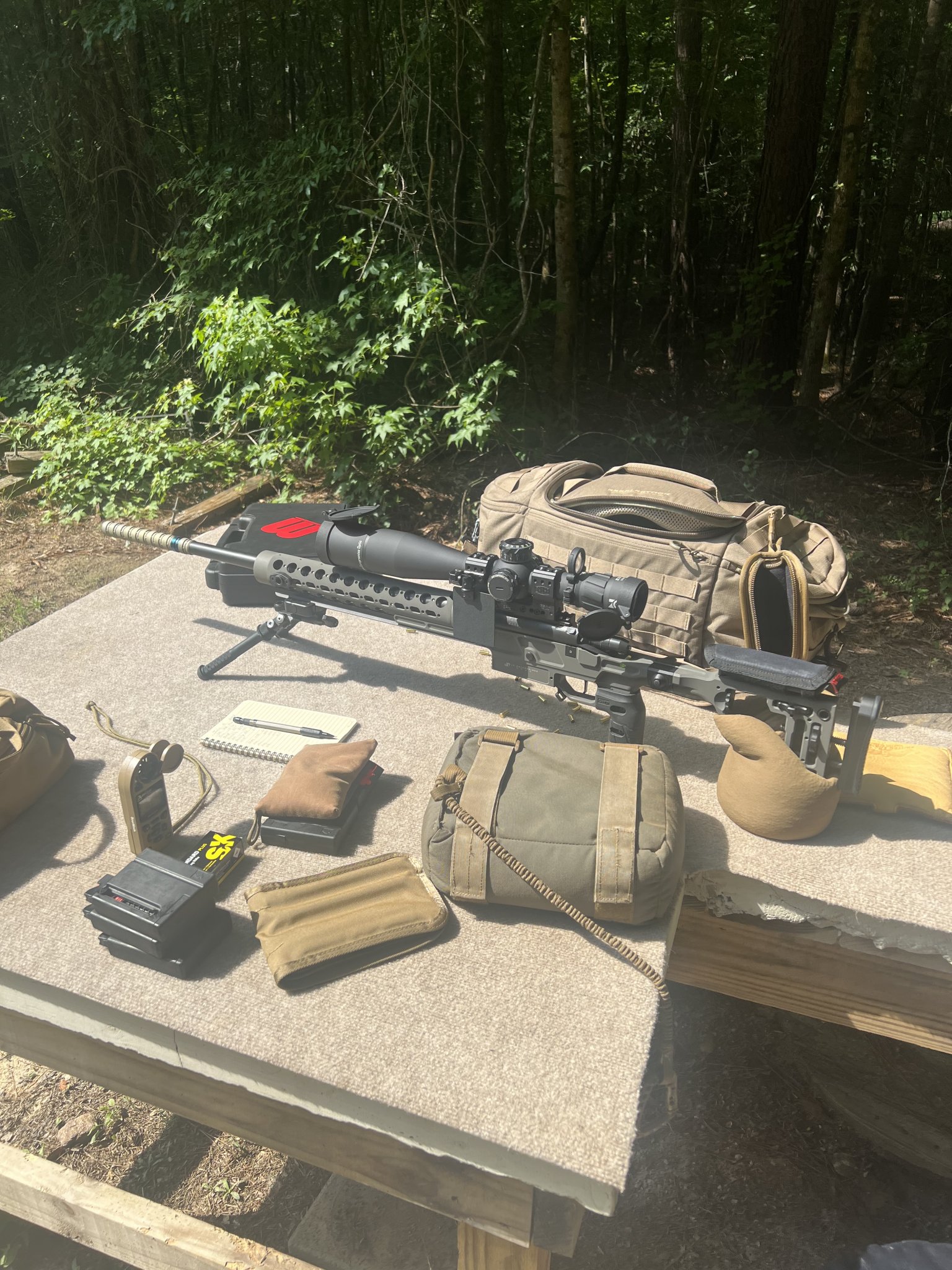

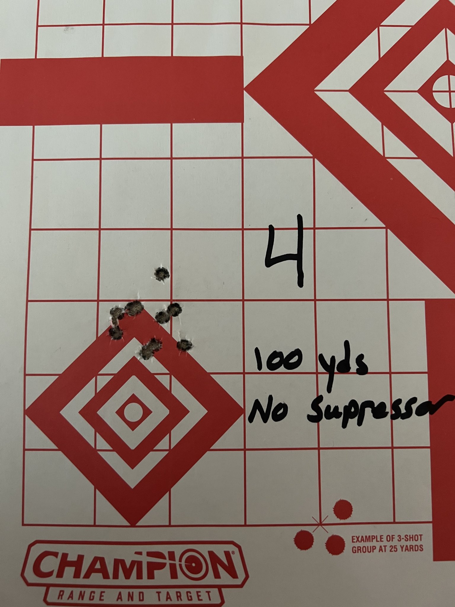

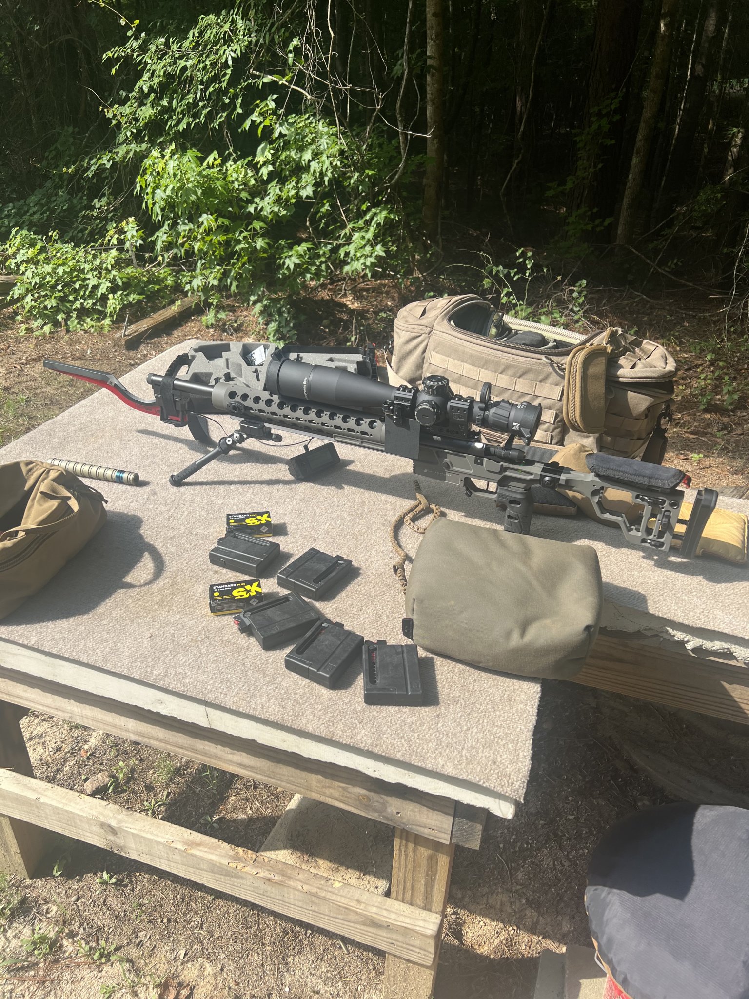

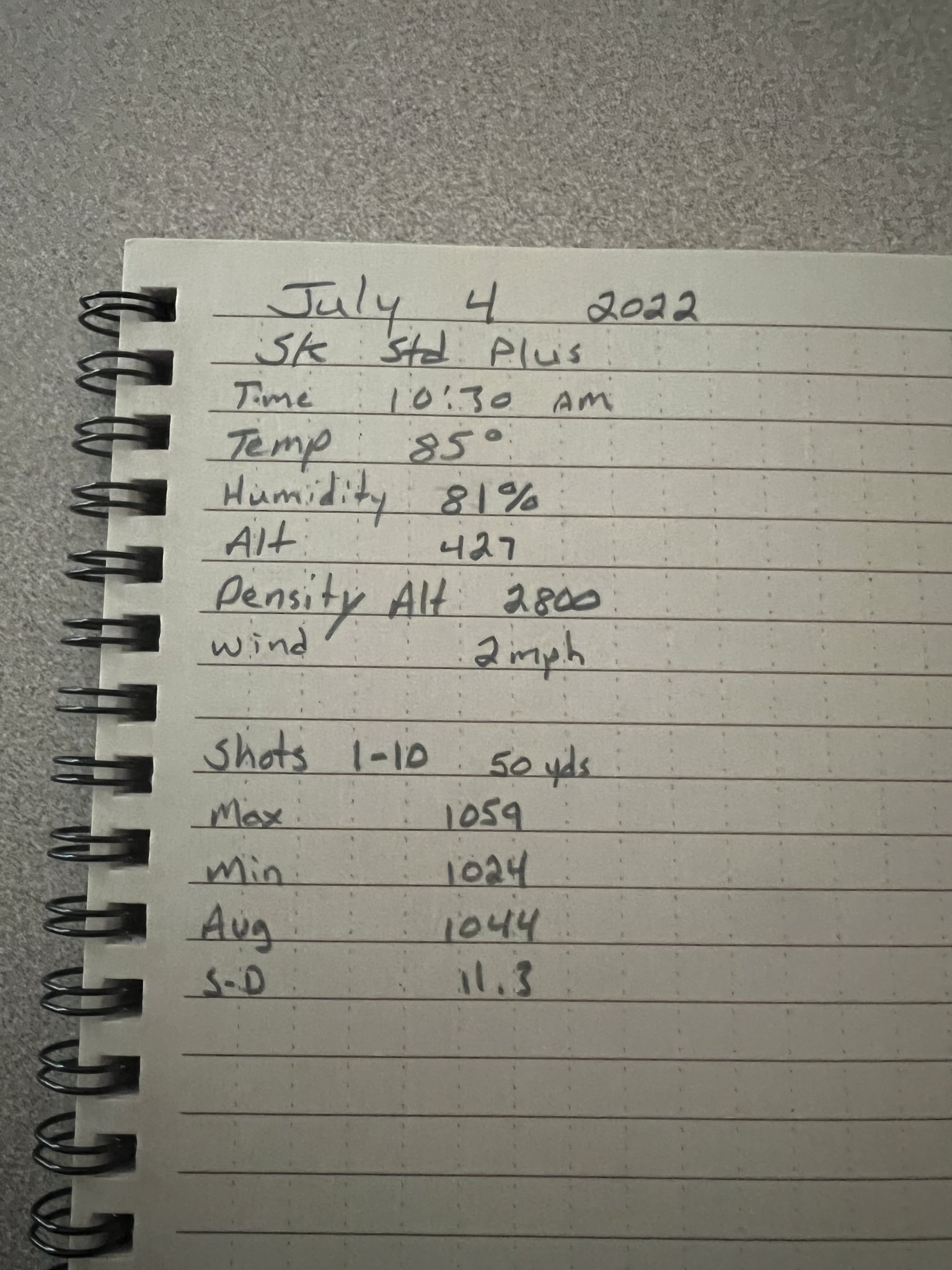

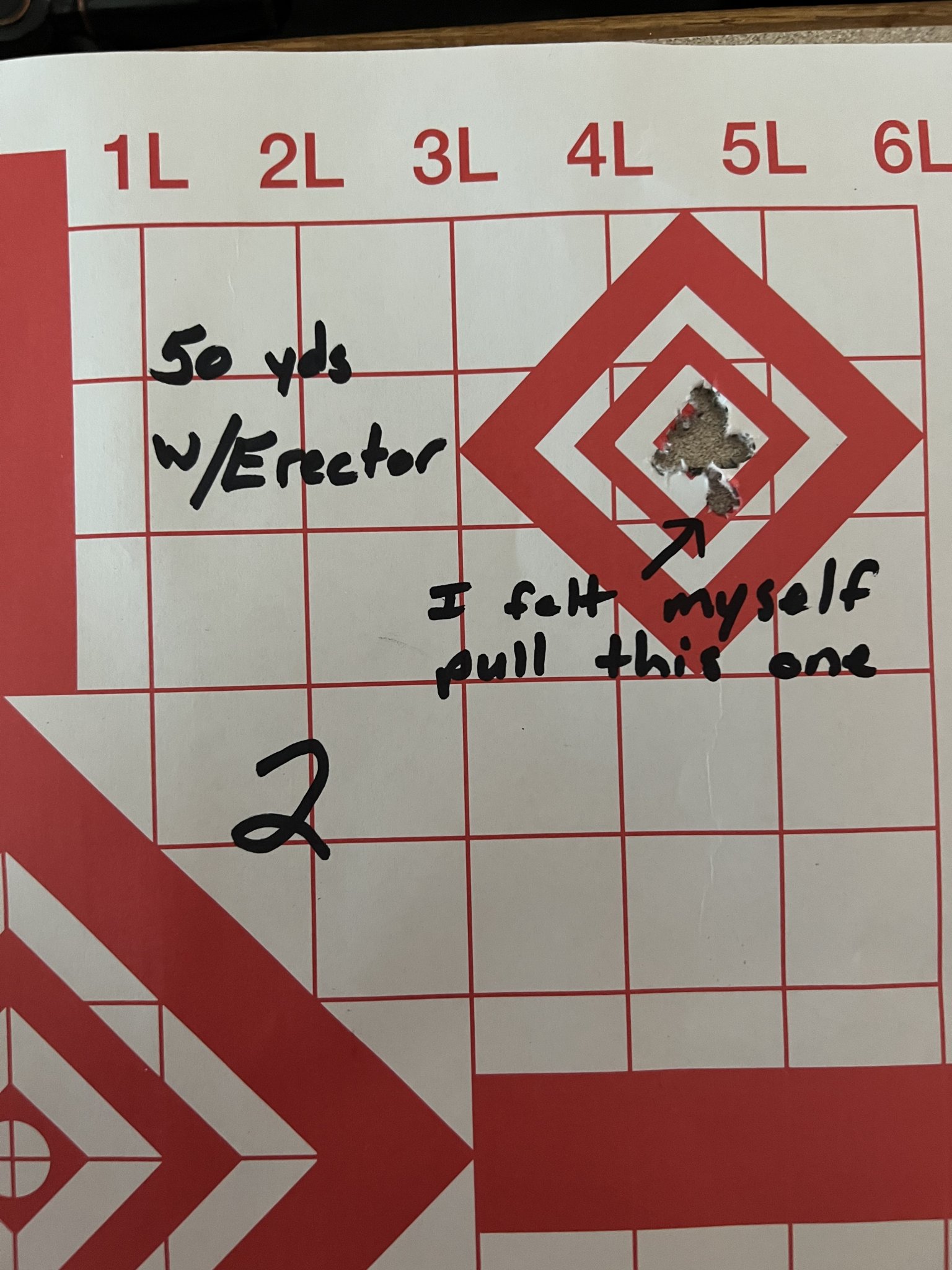

    Ok, I shot a box of SK Standard plus this morning (that’s all I had time for). My elevation was a little off since I’ve been shooting Eley Tenex for a bit and forgot/couldn’t find my 100 yd dope for the SK. Again, I’m not as good of a shooter as the rest of y’all so forgive the sloppiness of my groups. The pictures should explain what’s going on and in the #2 I knew it was a bad shot when I pulled the trigger. If it matters, I shot them in numerical order of the pictures.

    I don't know why #2 didn't come through on the regular post. It shows as an attachment, let me know if you can't see it.
    Sorry I couldn’t shoot better or even a better box of ammo. Maybe next time I can have a little more time to play. This just gives a rough estimate of what we all know I guess.
    were all the suppressed groups above shot without a magentospeed attached? Have you tried groups or grids with various configurations of the cones?

    @FimRire RongLifle correct, I did take the magneto off because I was being a little bitch and the humidity down here sucks balls and can go to hell, therefore it made me hurry up. I'll do better
