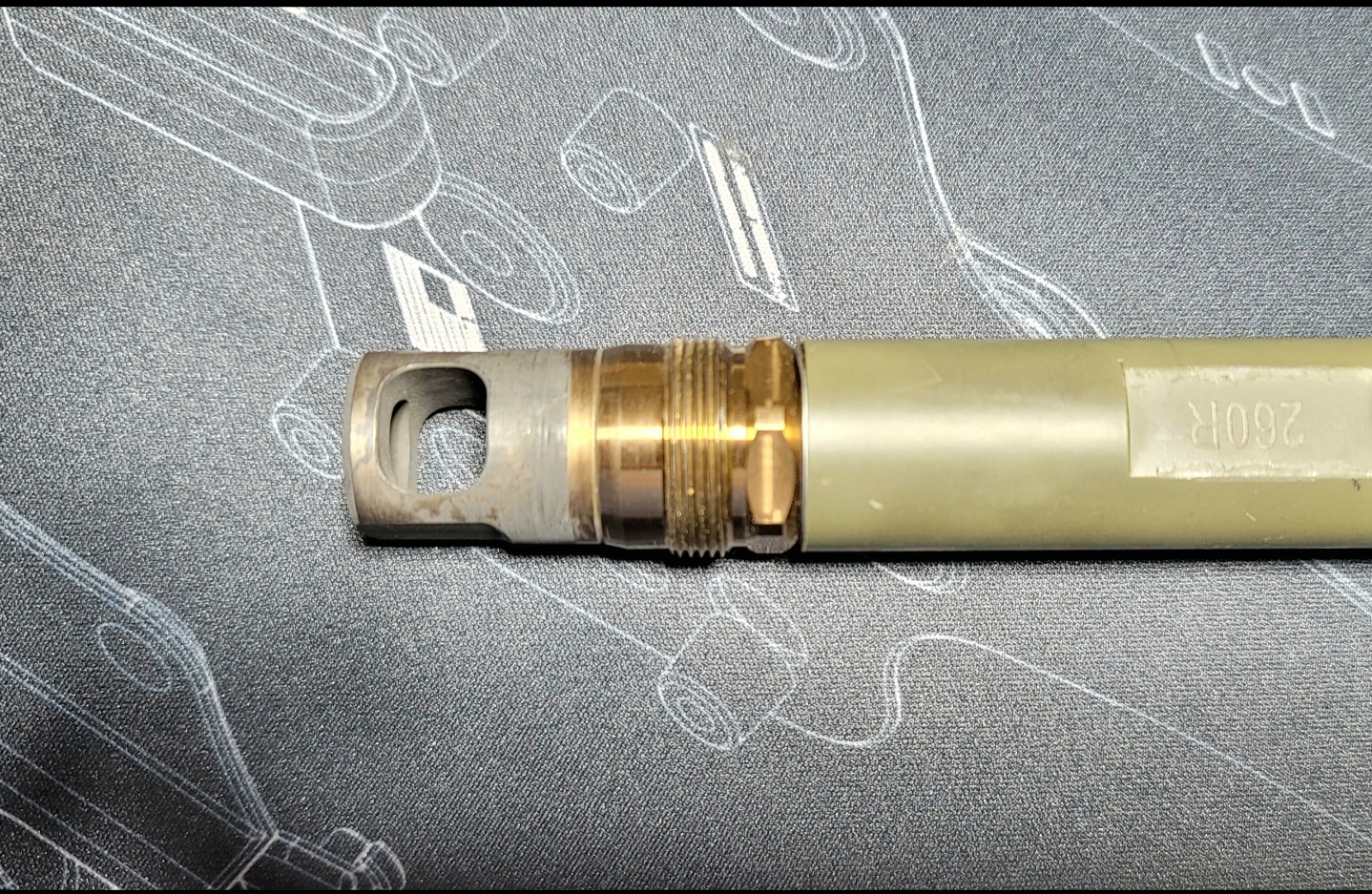

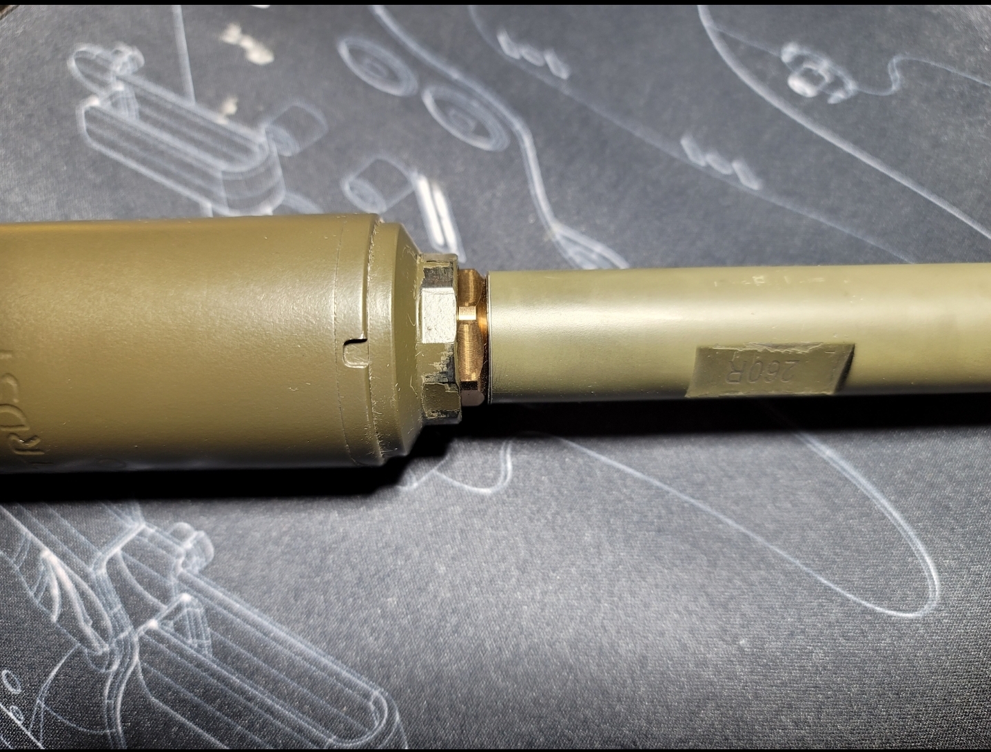

The issue with the cherry bomb mounts is there is no wrench flats, so if they get stuck (whether it's carbon, over tightening, etc), there is no easy way to get the mount out. Perhaps you can do some trickery with a left hand thread bolt and nut, but that's going to be a pain in the ass.
That's why I prefer the Rearden MFG mounts. They use the Plan B thread pattern (which I personally think is the most elegant out there), but they put wrench flats on the mounts. So if it does get stuck, there's an easy way to fix it. Plus their stuff is really well made.
When carbon and mounts are involved, there's always a chance for things getting stubborn and stuck. No matter the mount. That's why it's smart to have an engineered in backup plan (like wrench flats).

Another vote for the Reardon Plan B compatible brakes over the cherry bomb. I use them on all of my bolt action barrels.
ETA: couple of pics of the Reardon SPB brake & Reardon Atlas mount. Easy to get to the wrench flats if needed.

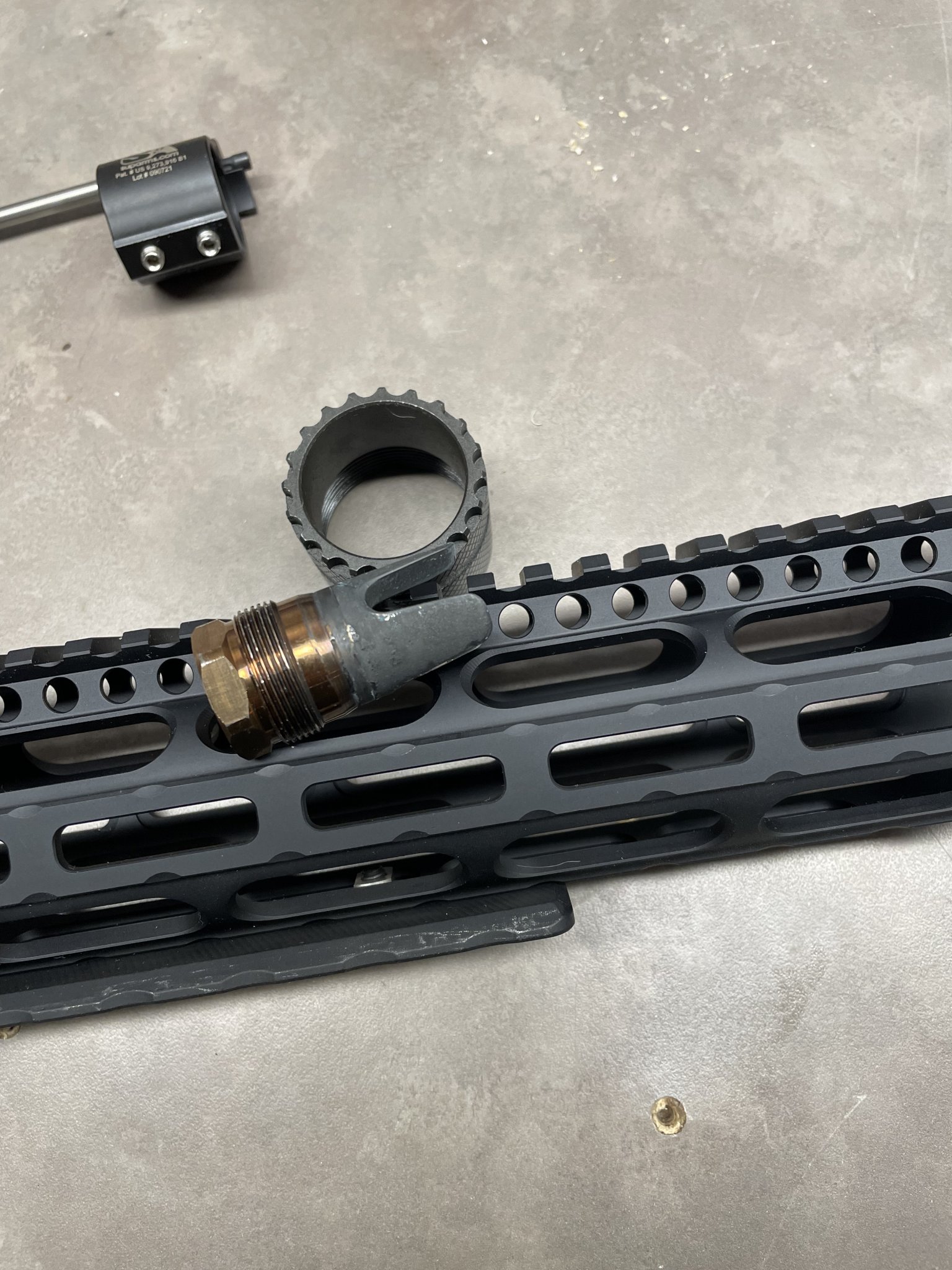

Left hand threads on the outside of the plan B would probably prevent most of the mounts stick in cans issues but Q is too smart for that. Because science or something is what they’d say I’m sure.
Reactions: Smith1 and kthomas
I have a thunder chicken. Q gets a bad rap from Kevin B. The suppressor is fine and does what it is supposed to do. But, I really don't like that the cherry bomb doesn't have wrench flats. It is very minimalist, so much so that there is a warning right in the instructions not to thread the can onto the cherry bomb without first installing the cherry bomb correctly to a rifle. You WILL get the thing stuck. Their words, not mine. Then, without wrench flats, you now have a direct thread can. My 6.5 grendel shoots tiny little groups with it on or off, though there is a POI change with it on. I torque it to 20 ft lbs using a torque wrench because I had it loosen up on a 6.5 creedmoor when hand tight. I had poor results with it on my RPR in 6.5 CM, though that could be because it was not staying tight. The TC works really well on my 300 BO as well. There are other options that do the same thing for less money, and are more functional because of the 1 3/8x24 rear end cap threading. I've never heard of the cherry bomb betting carbon locked, and the taper before the threads should prevent it. Mine shows a really clean line of separation on the cherry bomb where the taper interfaces with the can and seals carbon away from the threads. But, I don't shoot 1000s of rounds between mounting and dismounting the can, so take it for what it is worth. I'm not selling my TC and will continue to use it on the rifles that have a CB mount. But, I have moved to other suppressors that i like more. A YHM Resonator 2 is a lot of can for a little bit of money. My favorite right now, and you can use the Q Plan B if you choose.
