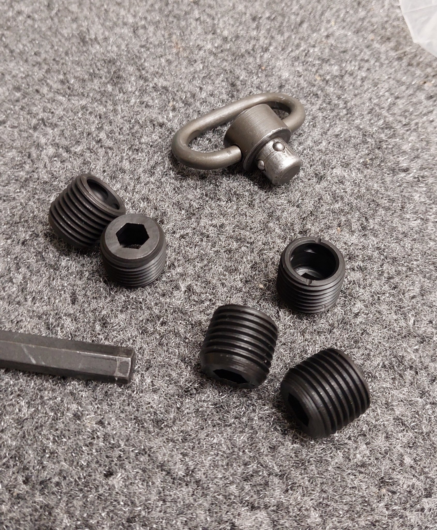

I buy the 279 in larger quantities. For clarification, this is what they look like on one of my benches right now.
