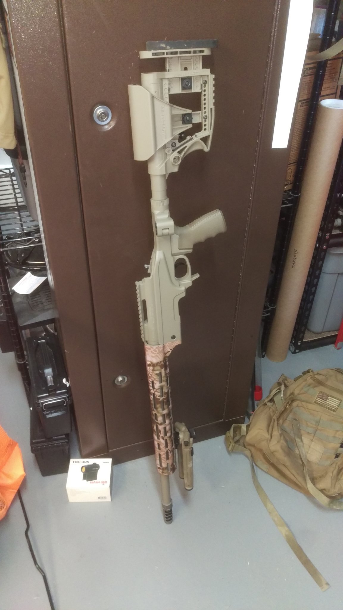

    So, I can't think of a better way to waste several hours of several days doing some not-so-meticulous spray paint camo on one of my rifles. AMIRIGHT?!?
    As far as pattern goes, I saw the A TACS Arid Urban and that looks pretty good for my general area and areas I frequent
    I visualize a desert tan base coat, with lighter tan, sage, and other sage/OD mix colors as accents to he applied with a sponge or some shit.
    Here be my colors I'm gonna fuck with. The base color is circled in black, and the accents to be sponged are circled in red.
    Before

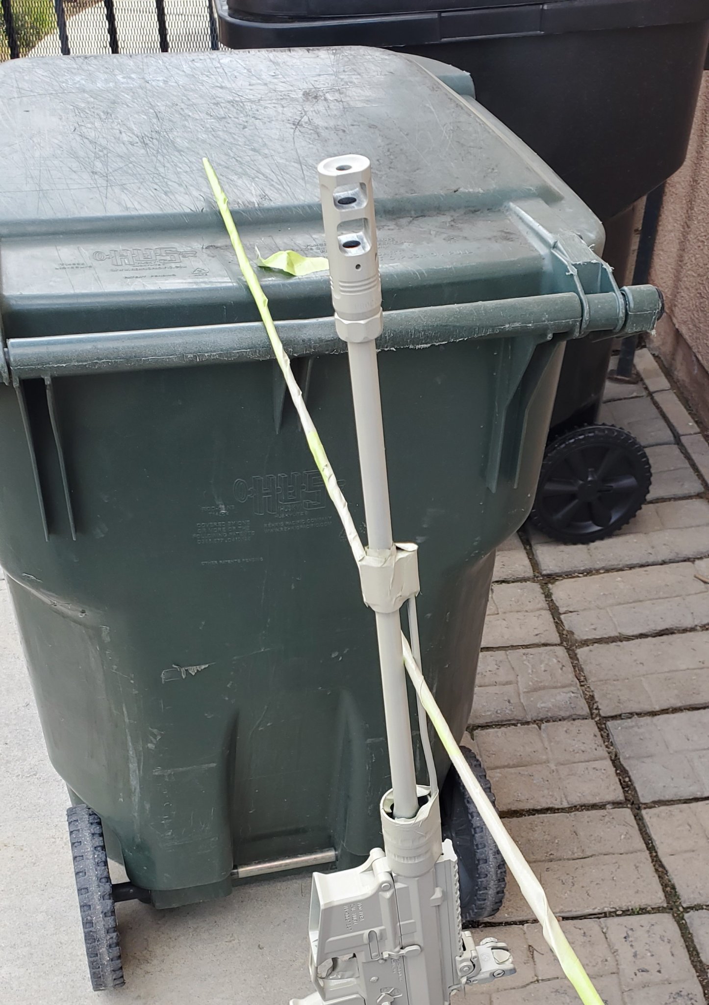

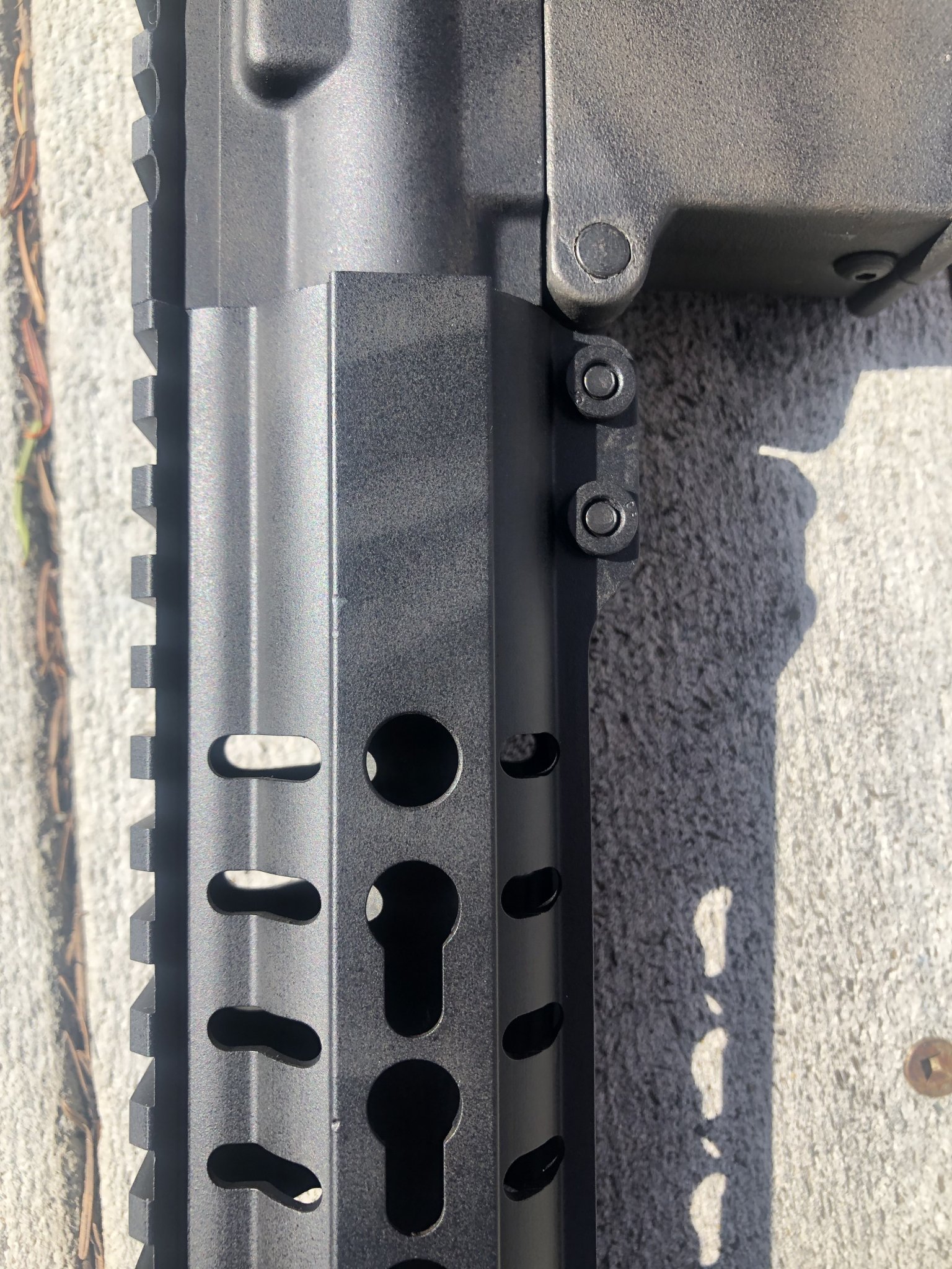

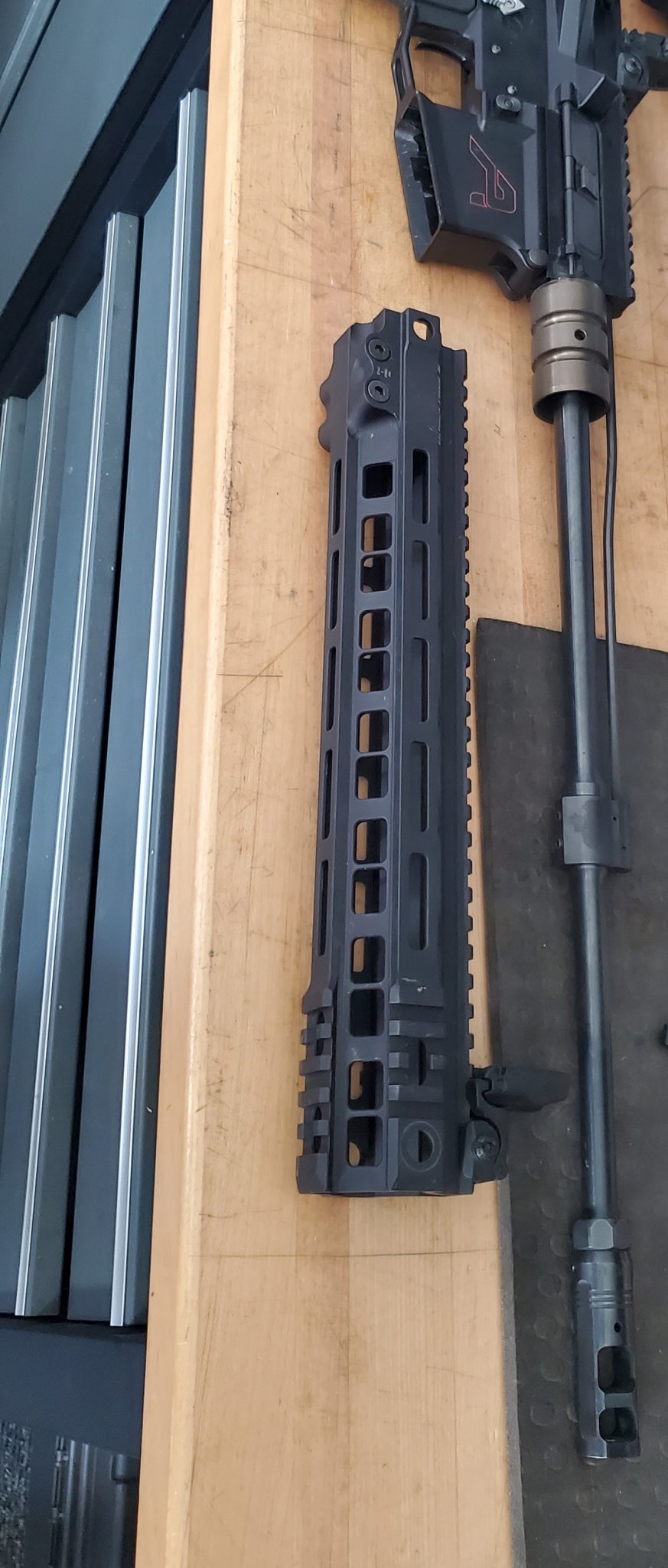

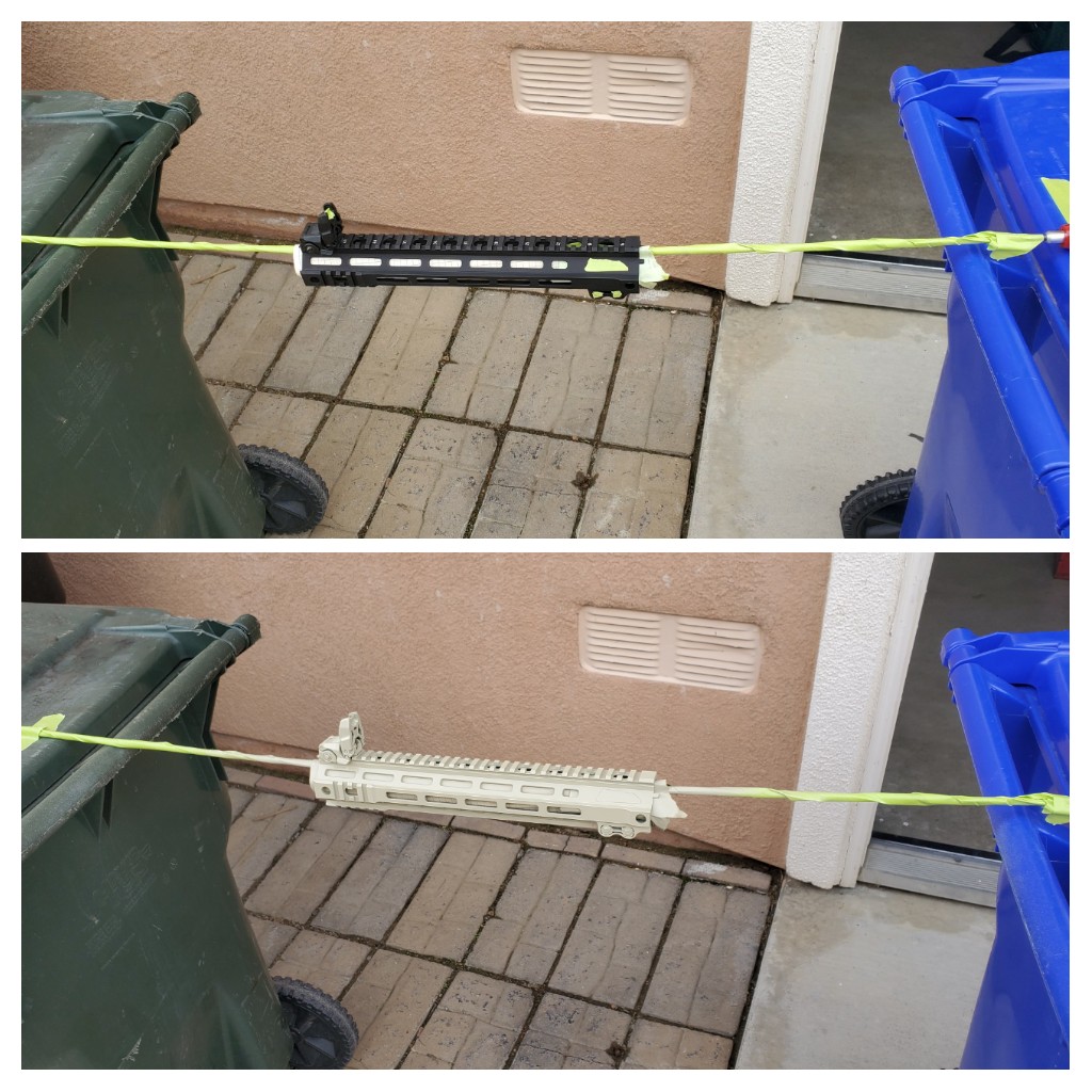

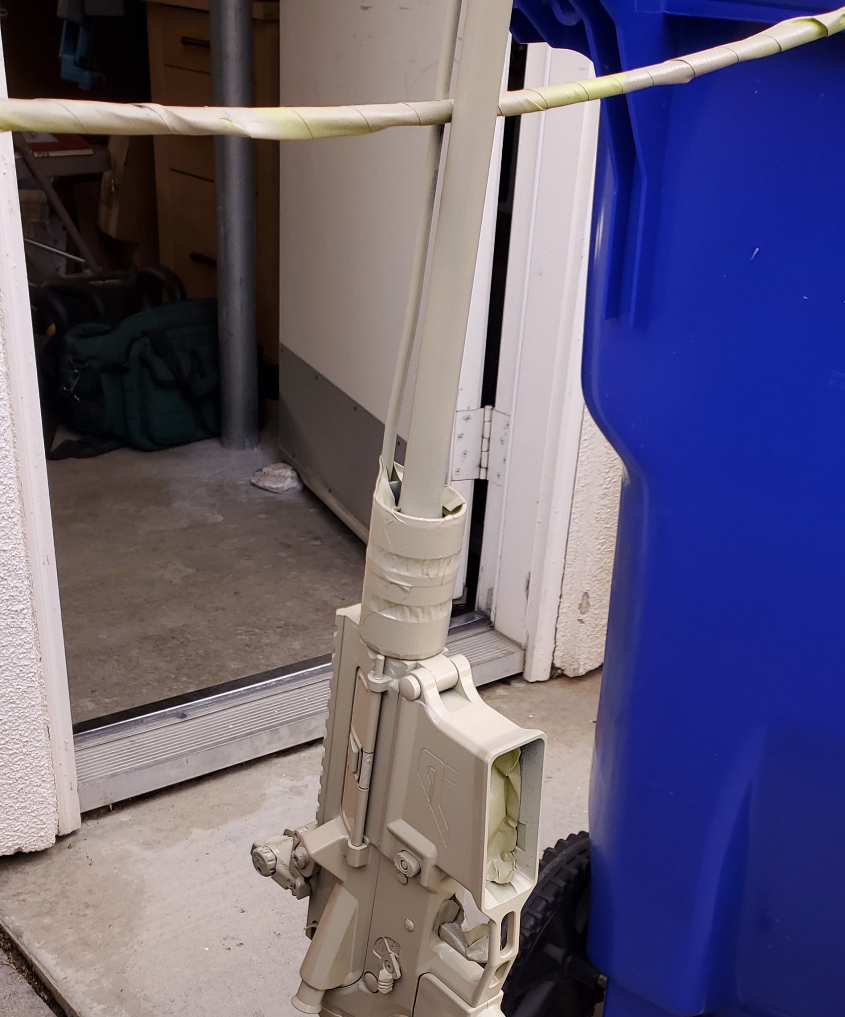

    Masked off all the surfaces of my Geissele handguard that touch, rear sight aperture, front sight post, trigger, charging handle channel, magwell, and a couple other spots because we have to think all if 1 step ahead to reassembly and dont want my iron sights to anything other than black.

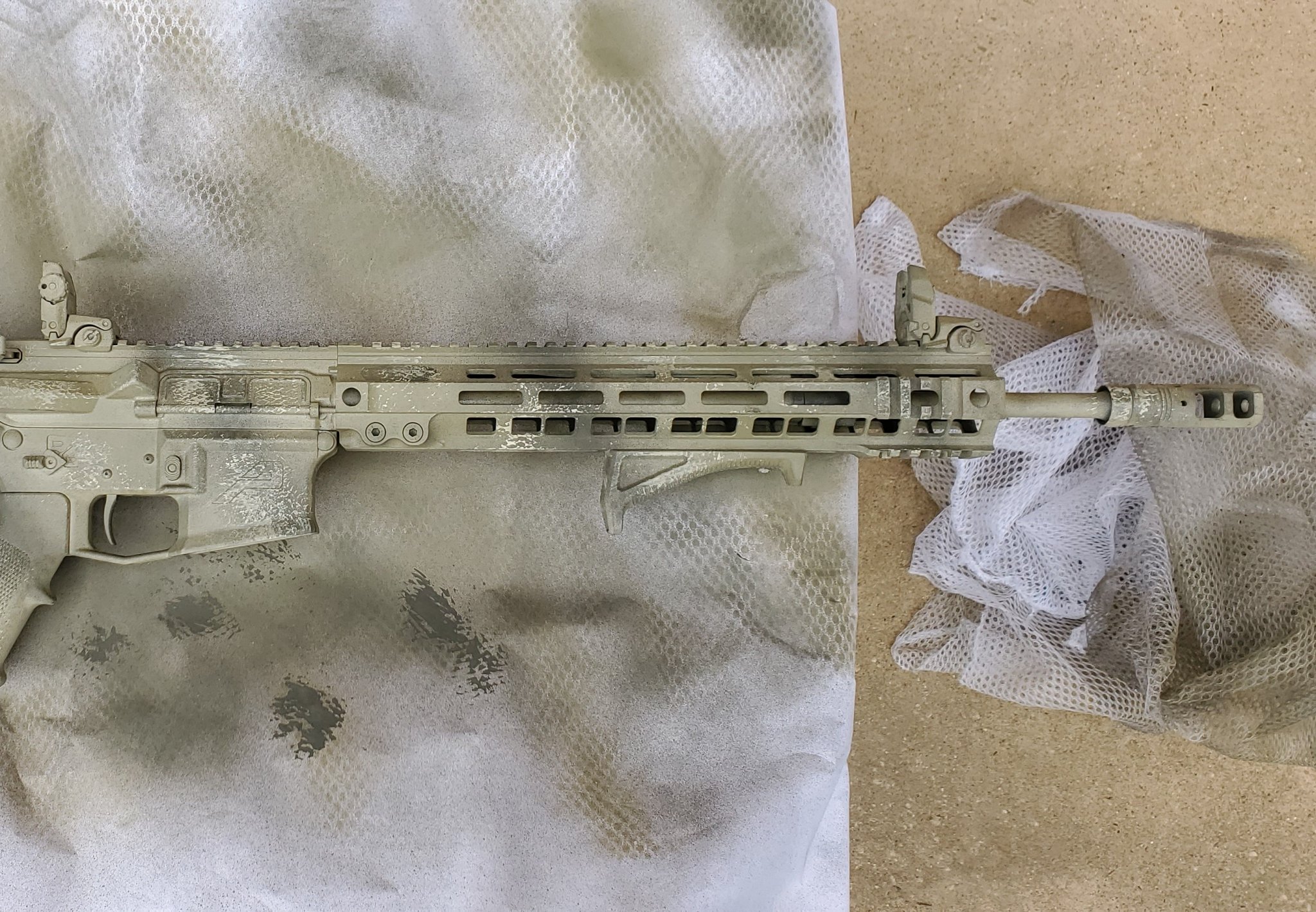

    Thus far, got the base coat on the main parts.
    Done with paint for today. Gonna let it set until tomorrow. That's where I gotta figure out how to actually mix and sponge on the other colors.

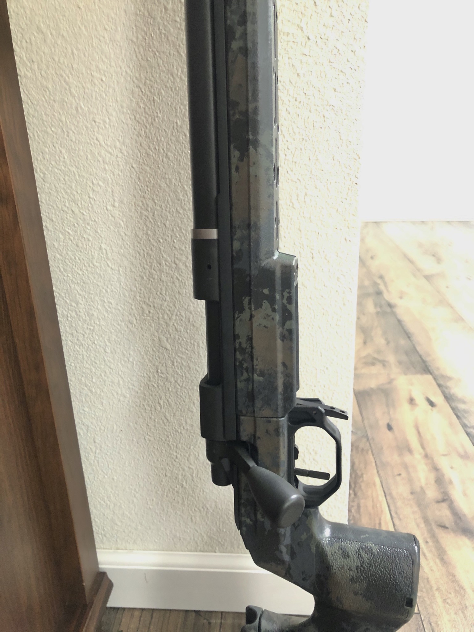

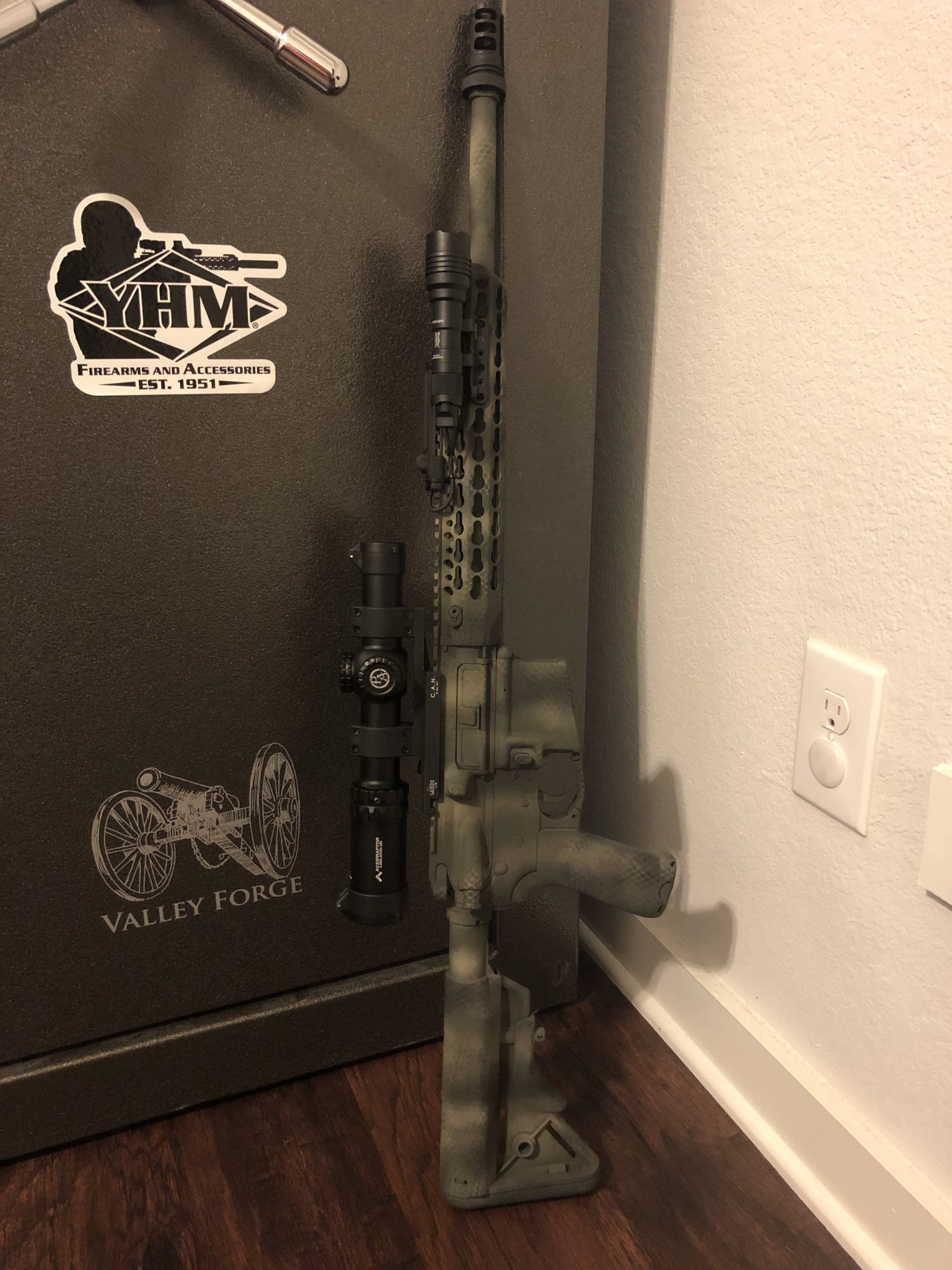

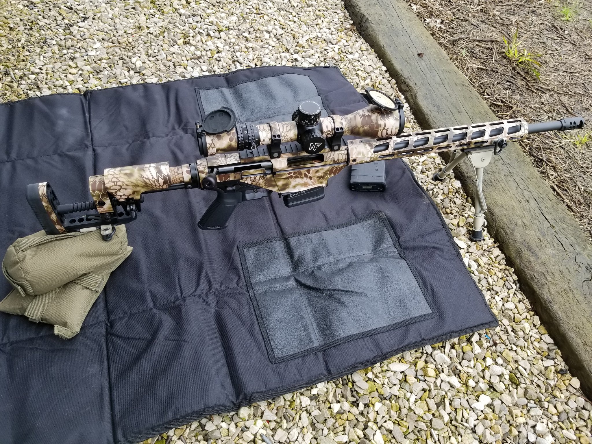

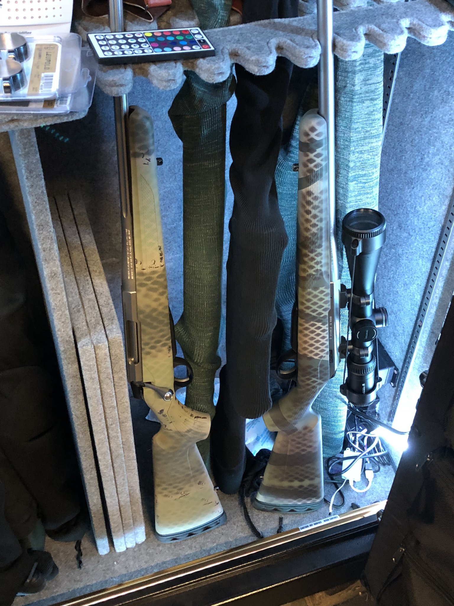

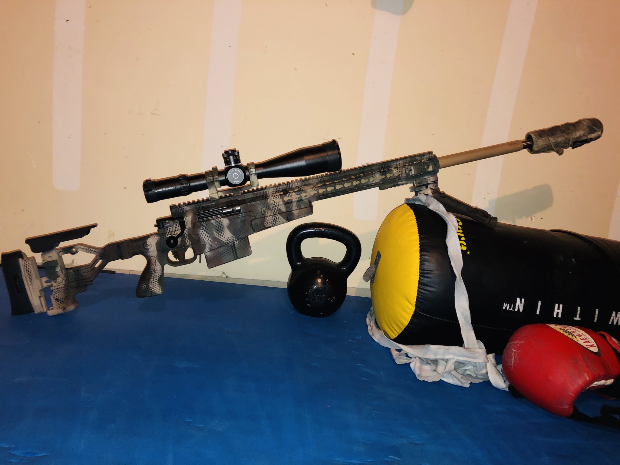

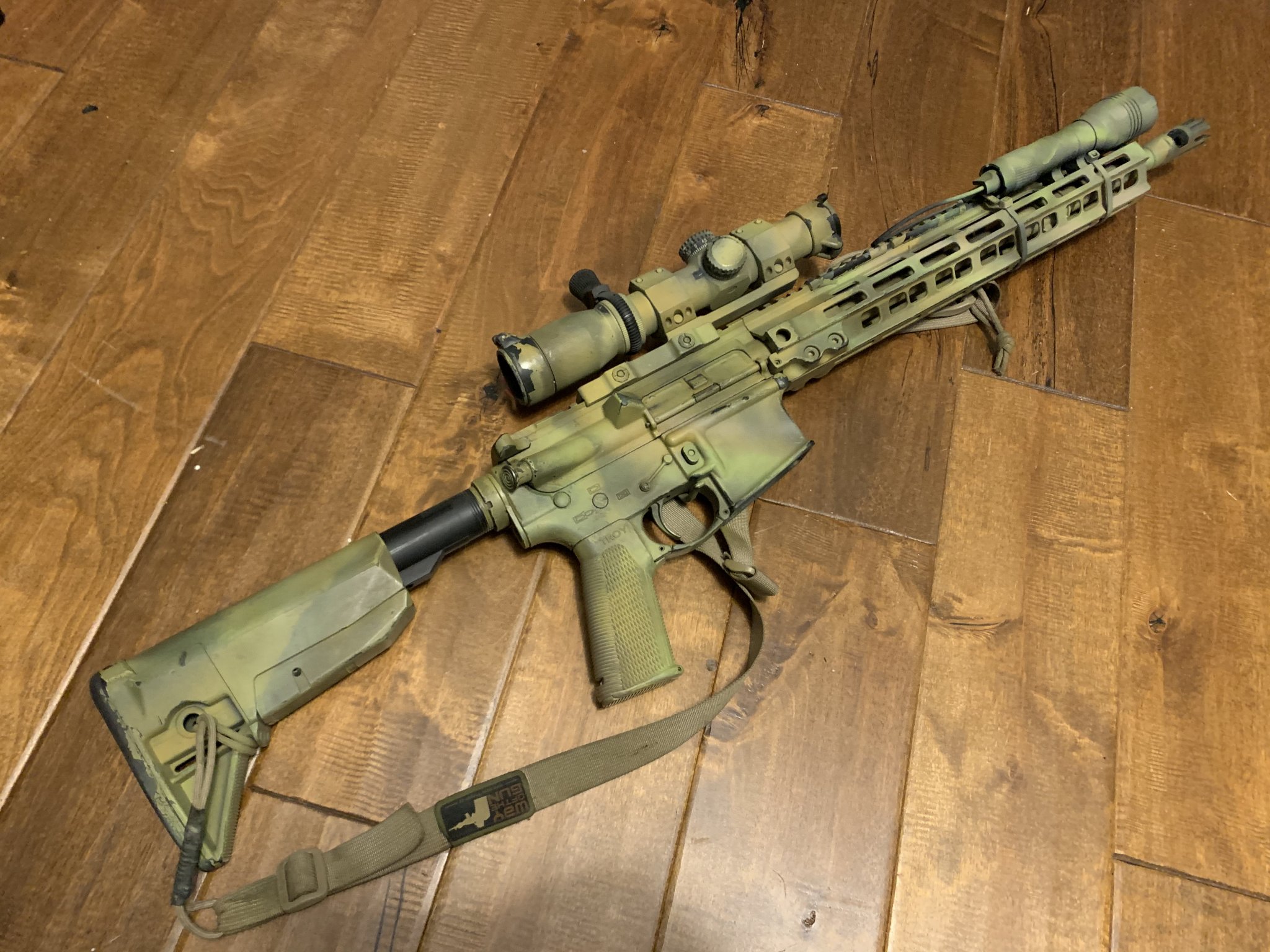

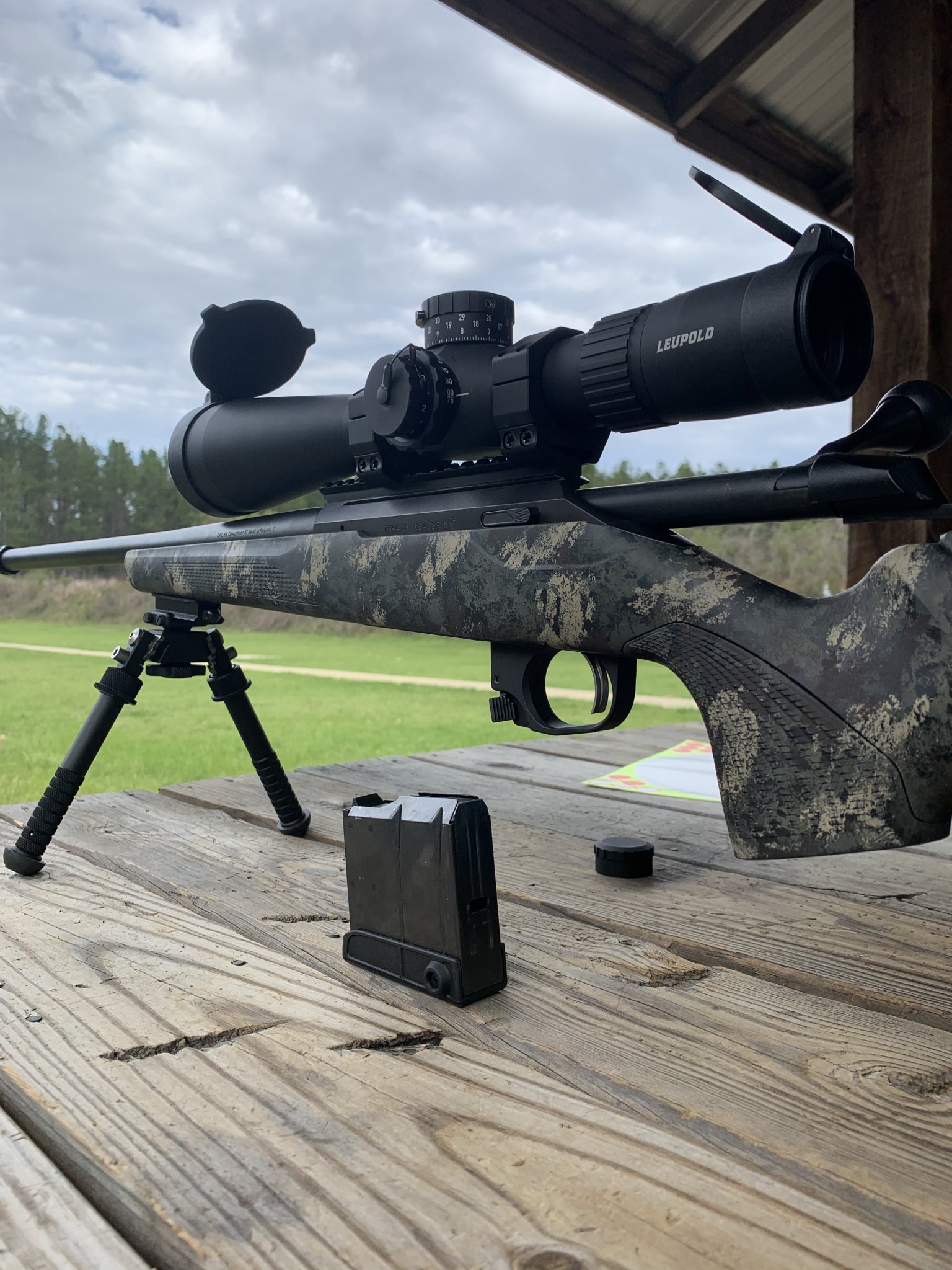

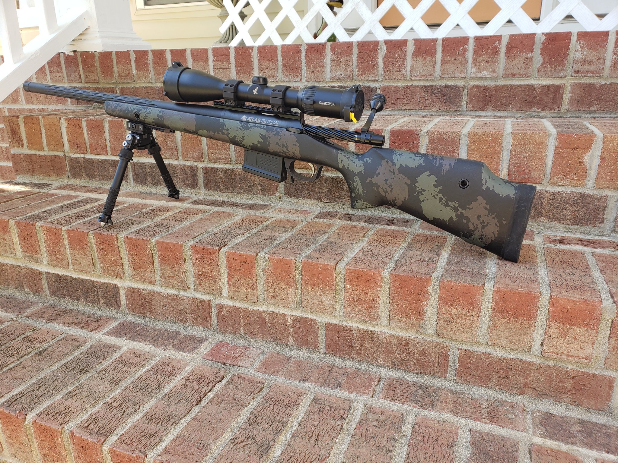

    I did a couple today. 1st is started out tan . And the McMillan was Green. Did a base layer in black and sponged the rest. I think they turned out ok.

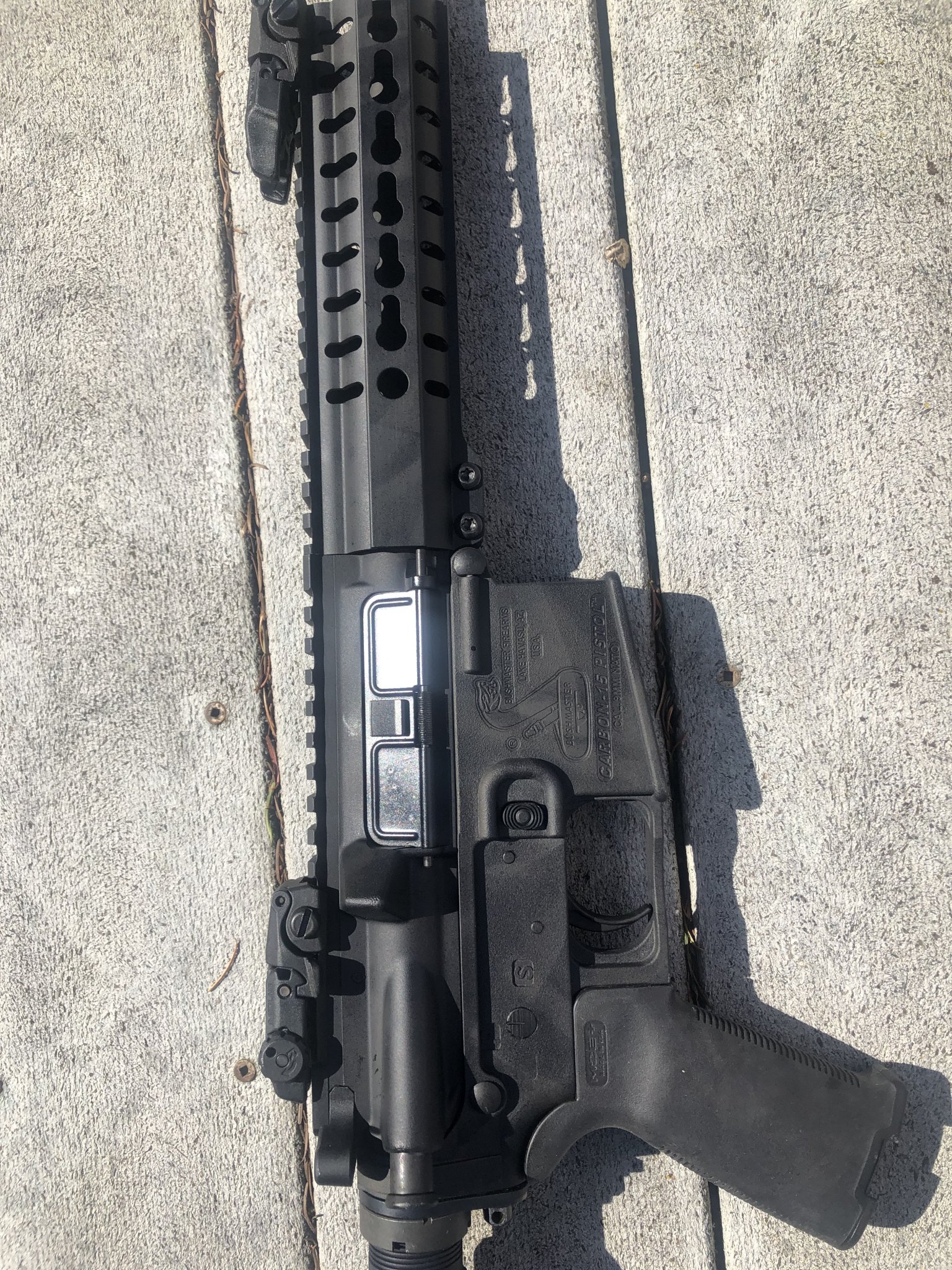

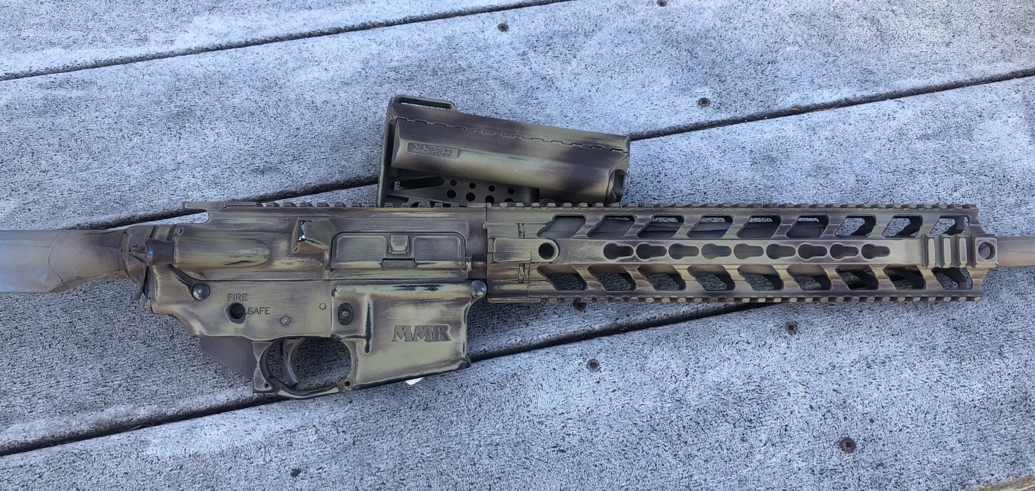

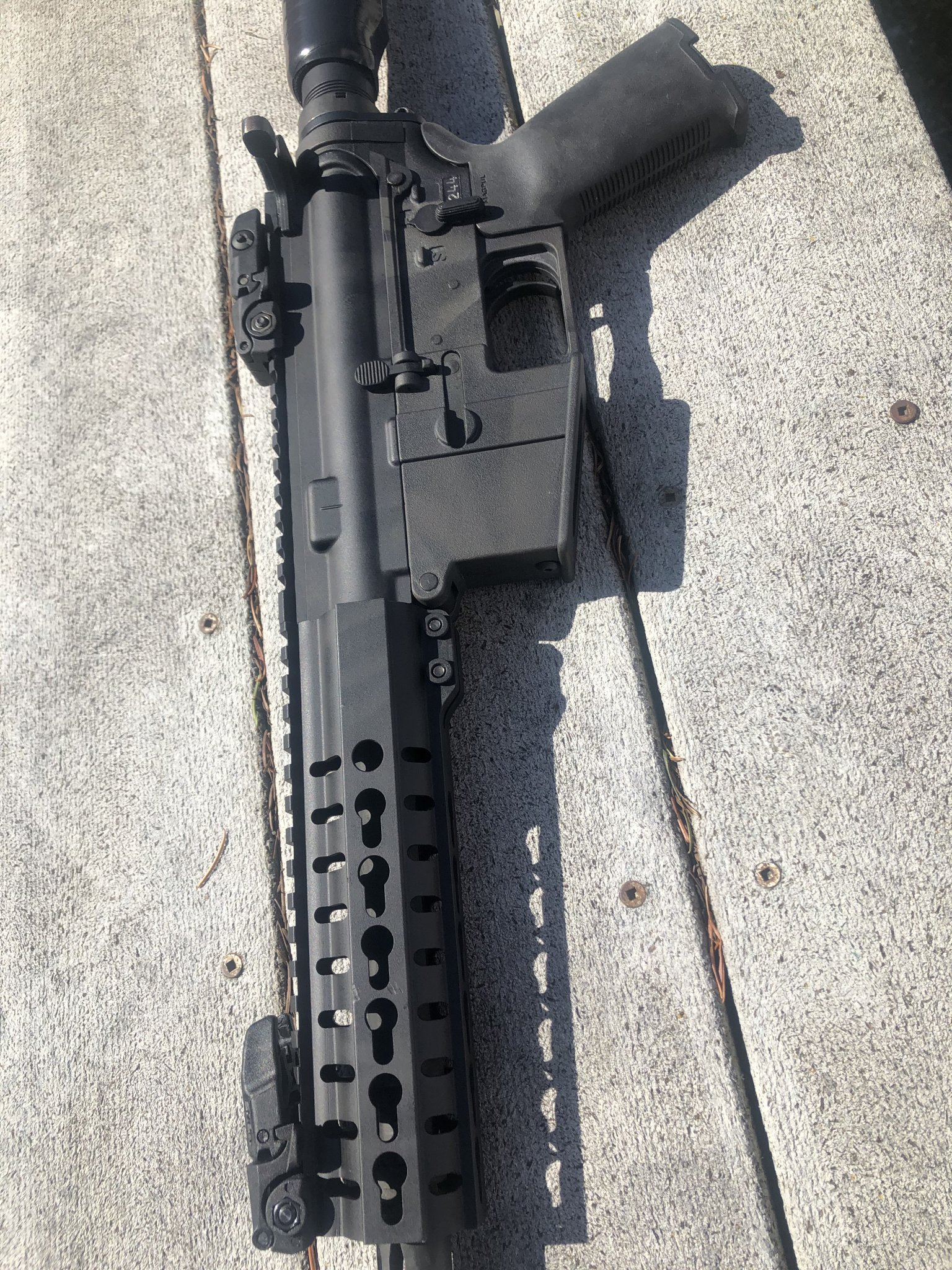

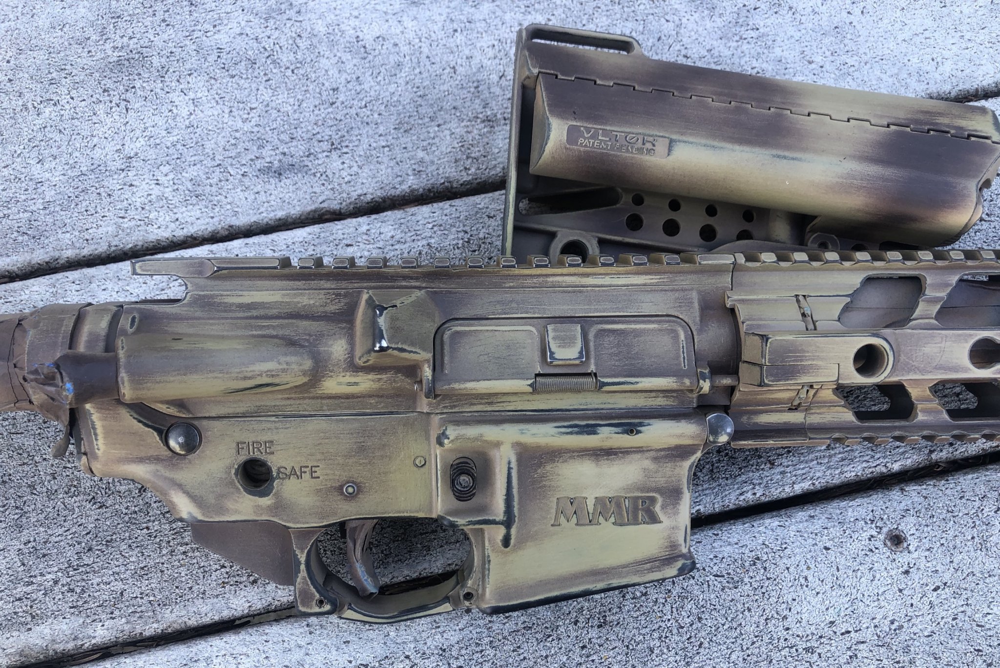

    Beautiful day here and I have my first day off since March 6th so I decided to try my ‘dry rub’ style on my AR-9mm
    Used an antiquing brown and rubbed it into all the crevices and wiped it off. Had to do it a few times in each spot to get the look I wanted.
    Took some long grass and laid it over it and then lightly sprayed satin black to give a very subtle illusion of depth.
    It is very very subtle, which is what I wanted.
    I may go more extreme color differences on the next one.

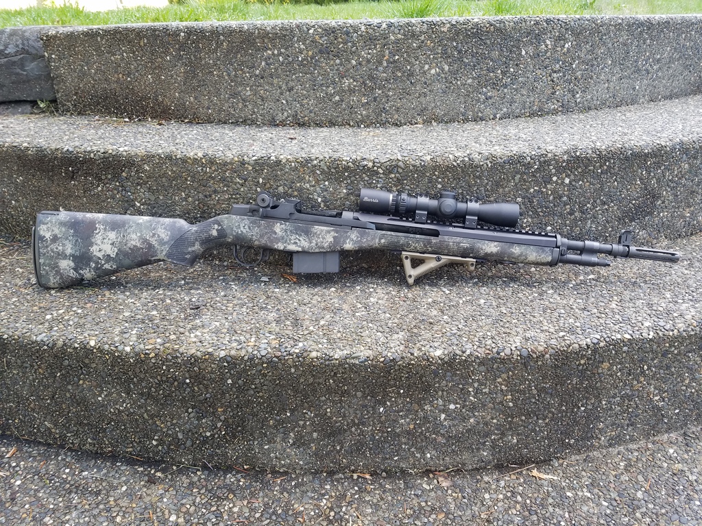

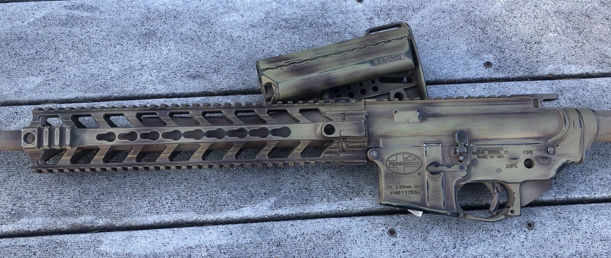

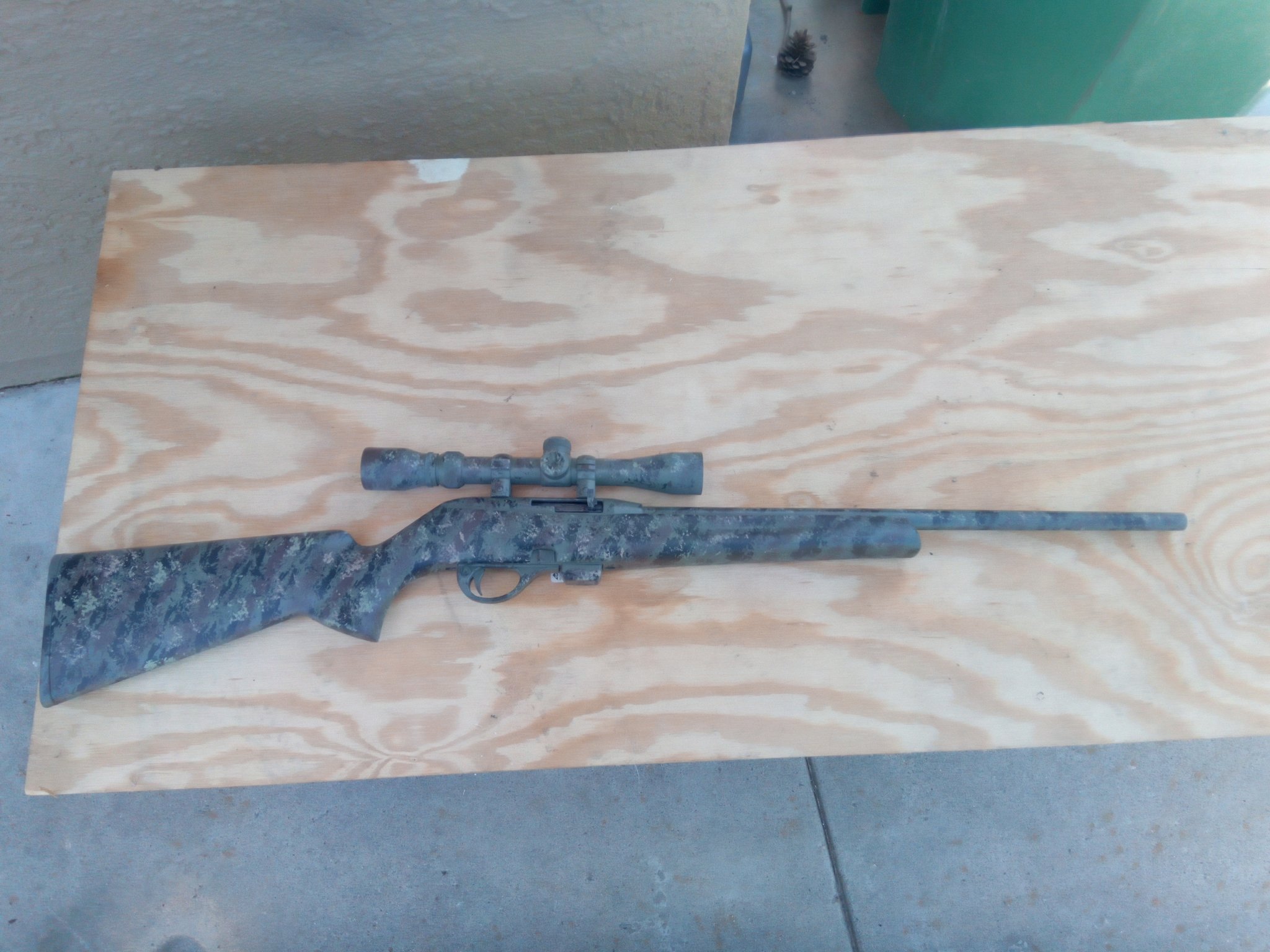

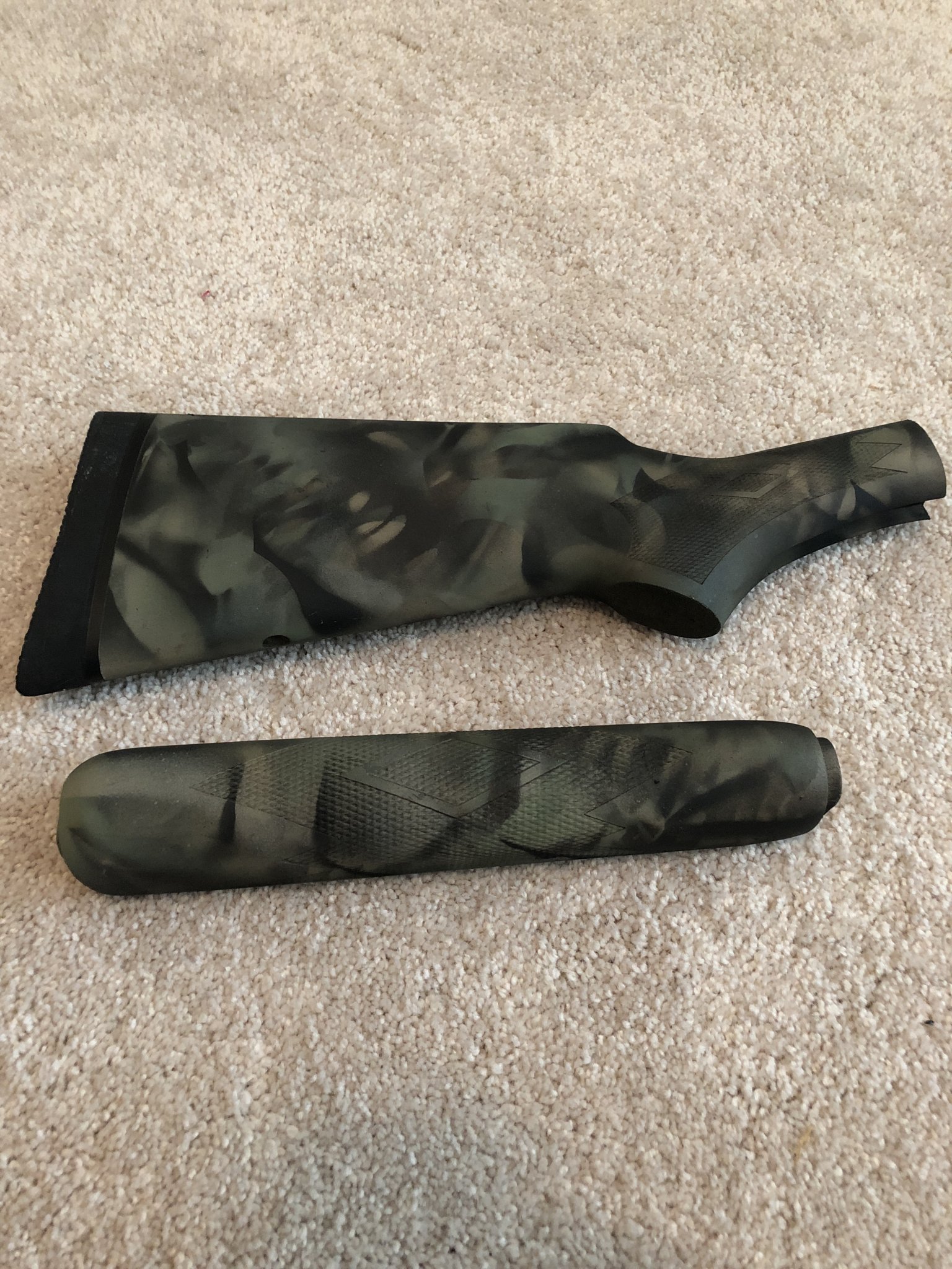

    I did a plastic M1A stock with Krylon Fusion paint. That stuff really does fuse well with plastic. It wouldn't scratch at all.

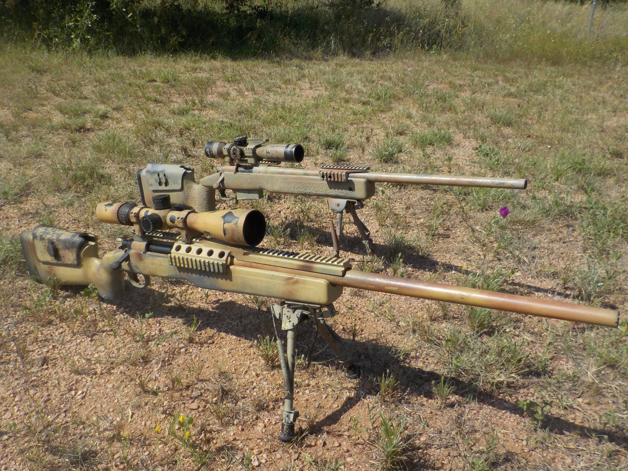

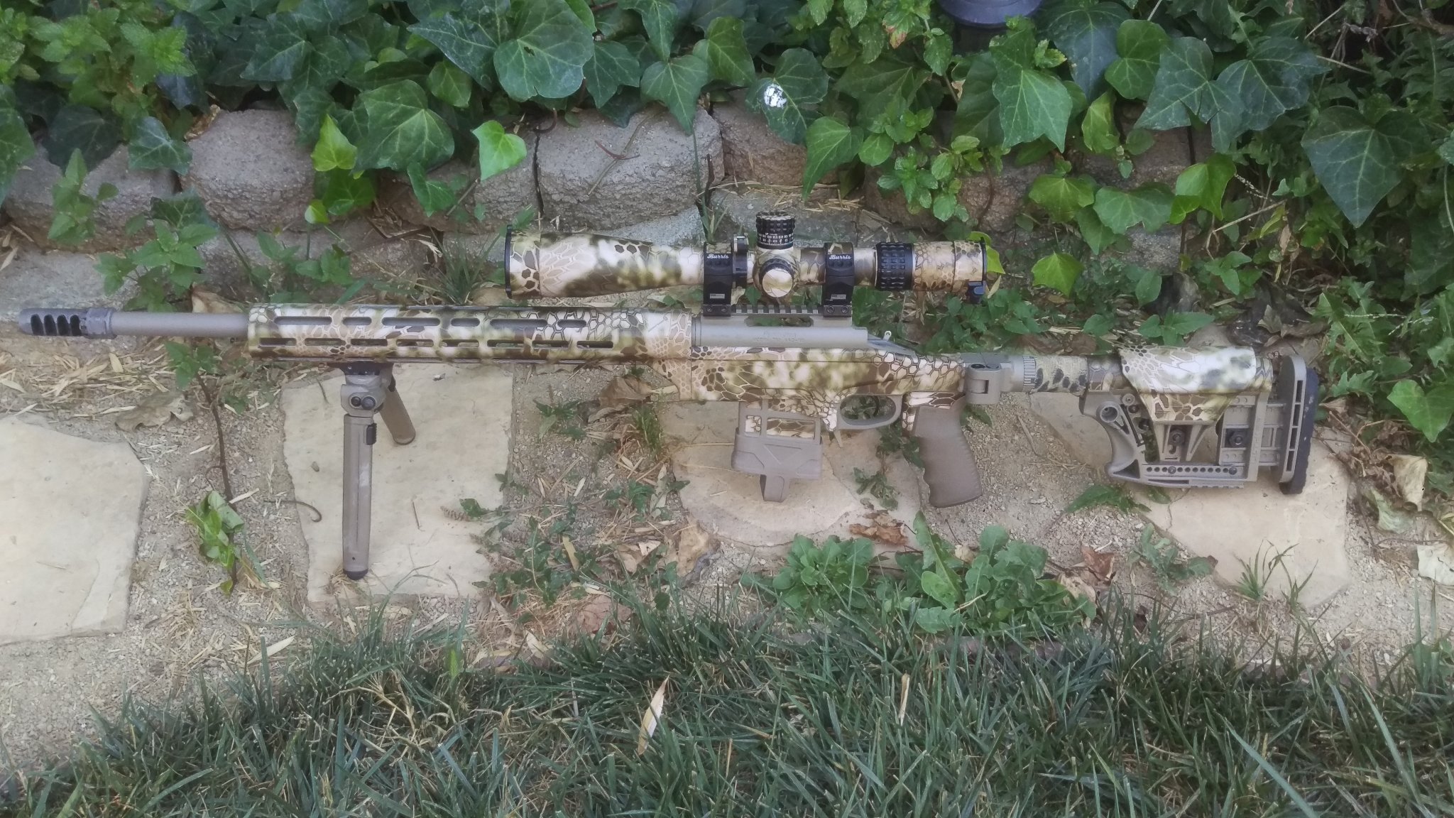

    A damp sea sponge sprayed with paint will give that softer A-Tacs edge. Dry sponge dipped makes it more like Manners. Either one looks good. A-Tacs makes a better camo IMHO.

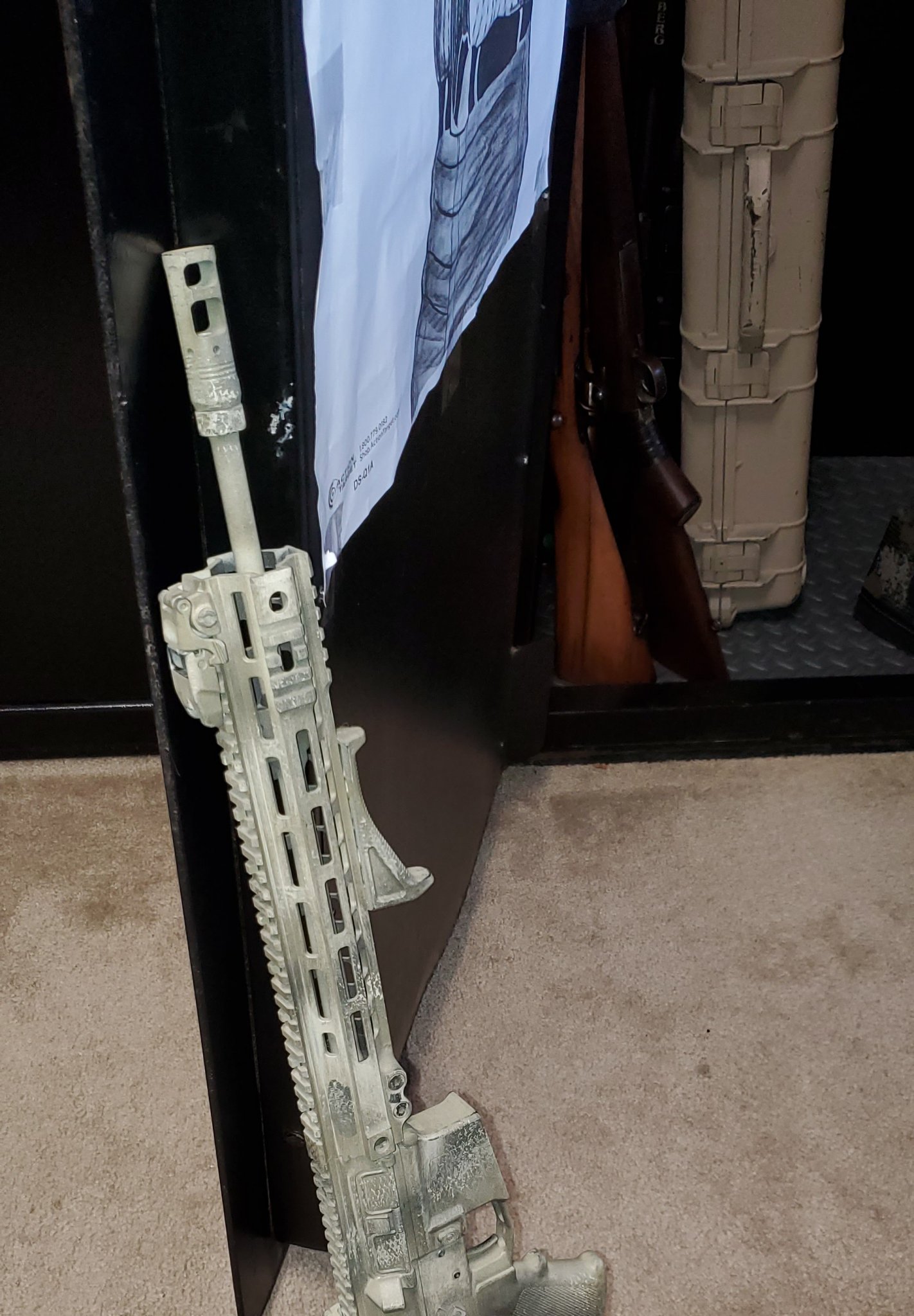

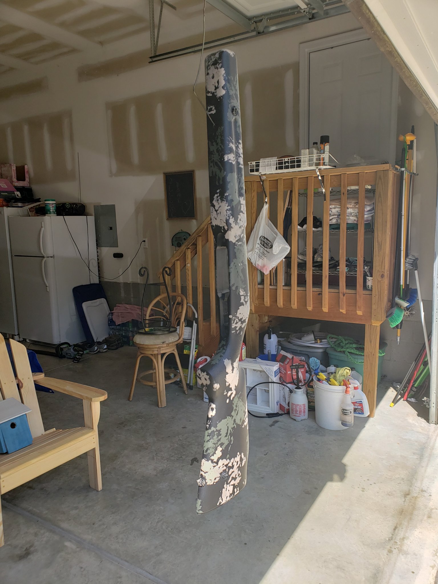

    I did my sons stock on his cricket. Use some pattern stickers I bought of eBay. It came out ok. But still super nervous to do it to an expensive rifle ....
    Don’t shoot for perfection and it will turn out great.
