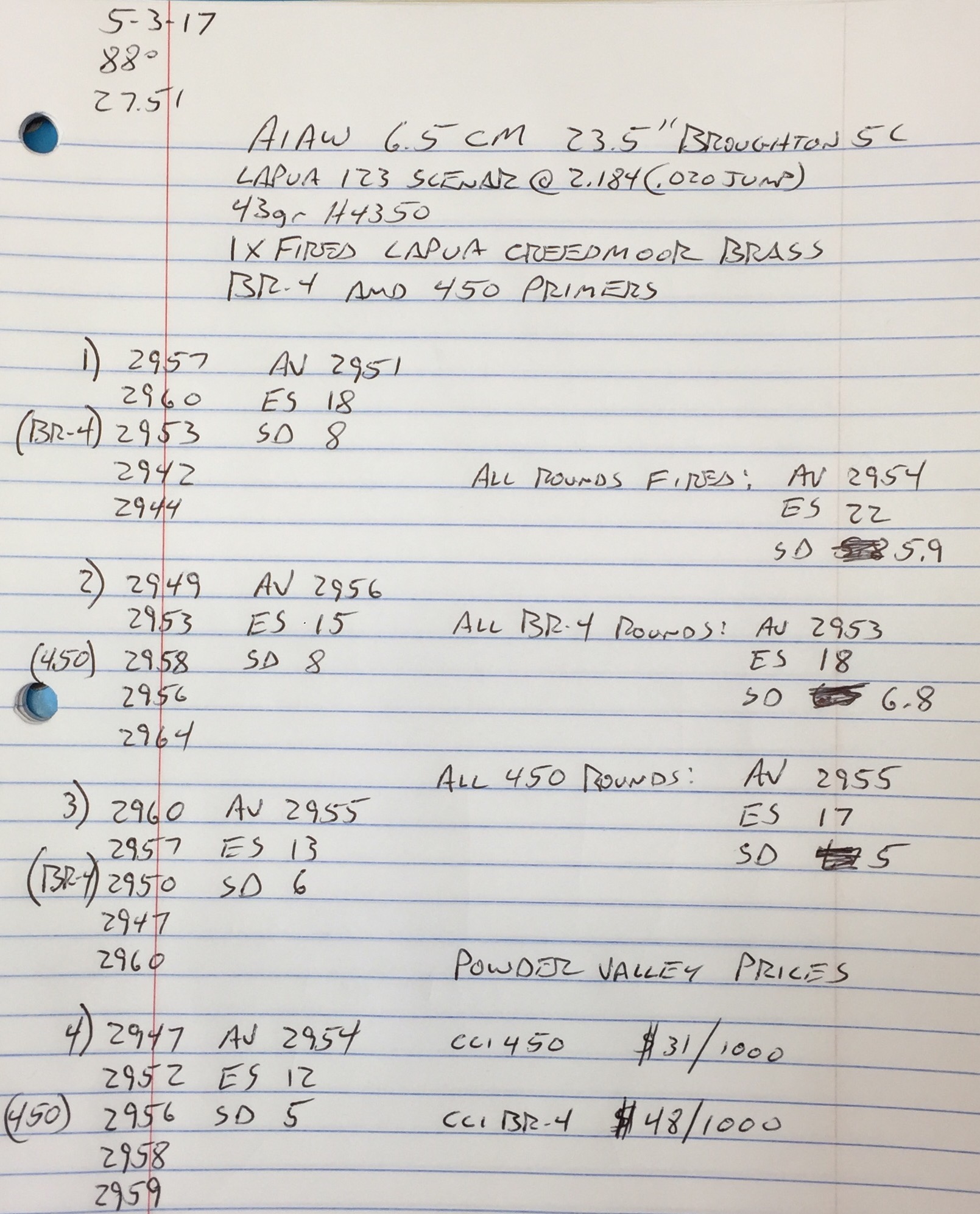

Guess I was wrong. If they’re adding more priming mix, I’d think there’s be a bump in velocity.
Here’s me test:
Alternating between them in 5 shot groups. 2 fps between them.
