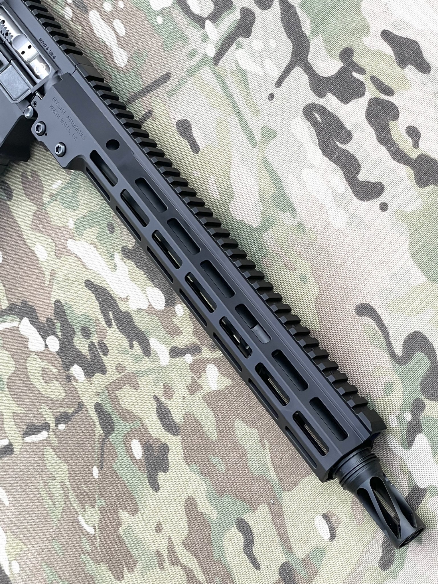

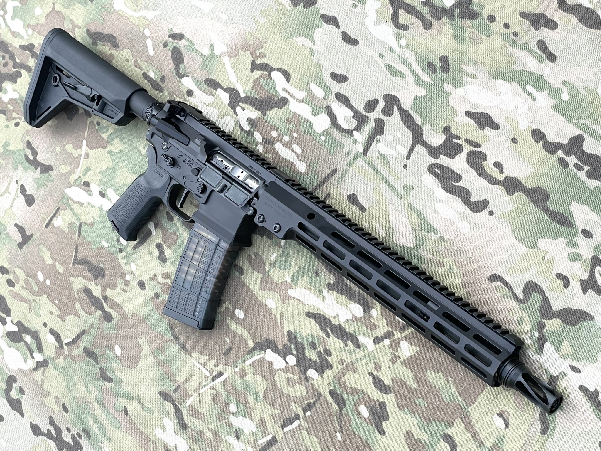

With the 13.9" barrel, compared to a 14.5" barrel, using the SAME length muzzle device, you end up with a 0.6" shorter rifle.
This is a Criterion 13.9" C/L barrel with OSS/HUXWRX extended flash hider (P/N 2885), producing a 16.2" barrel:
The Flow 556K when installed does clear the handguard with this combination.
A 14.5" barrel and the standard length flash hider (P/N 1667) makes more sense to me. You still end up with a 16.2" barrel, and likely another couple dozen FPS in velocity.
View attachment 8374631View attachment 8374632
