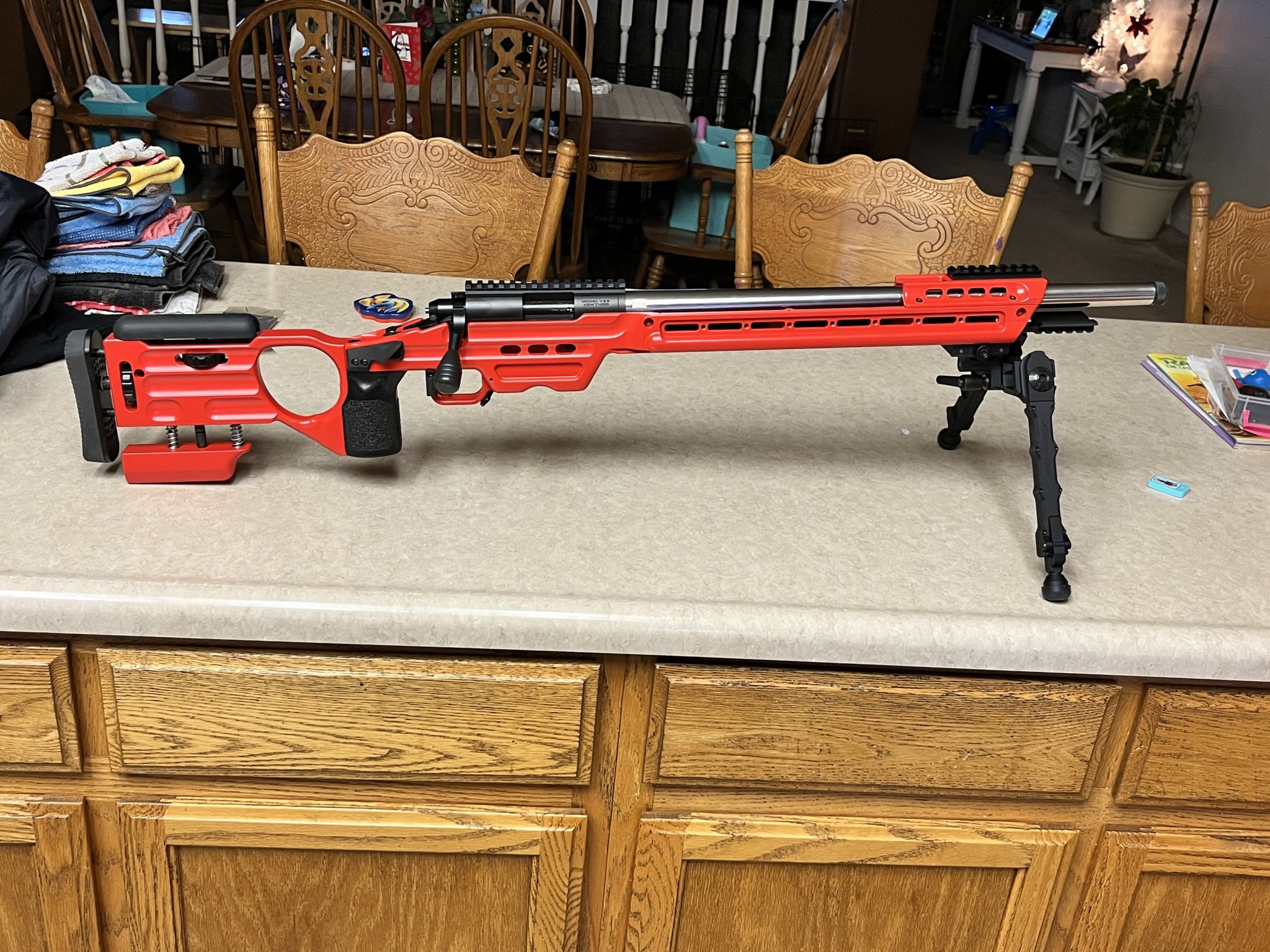

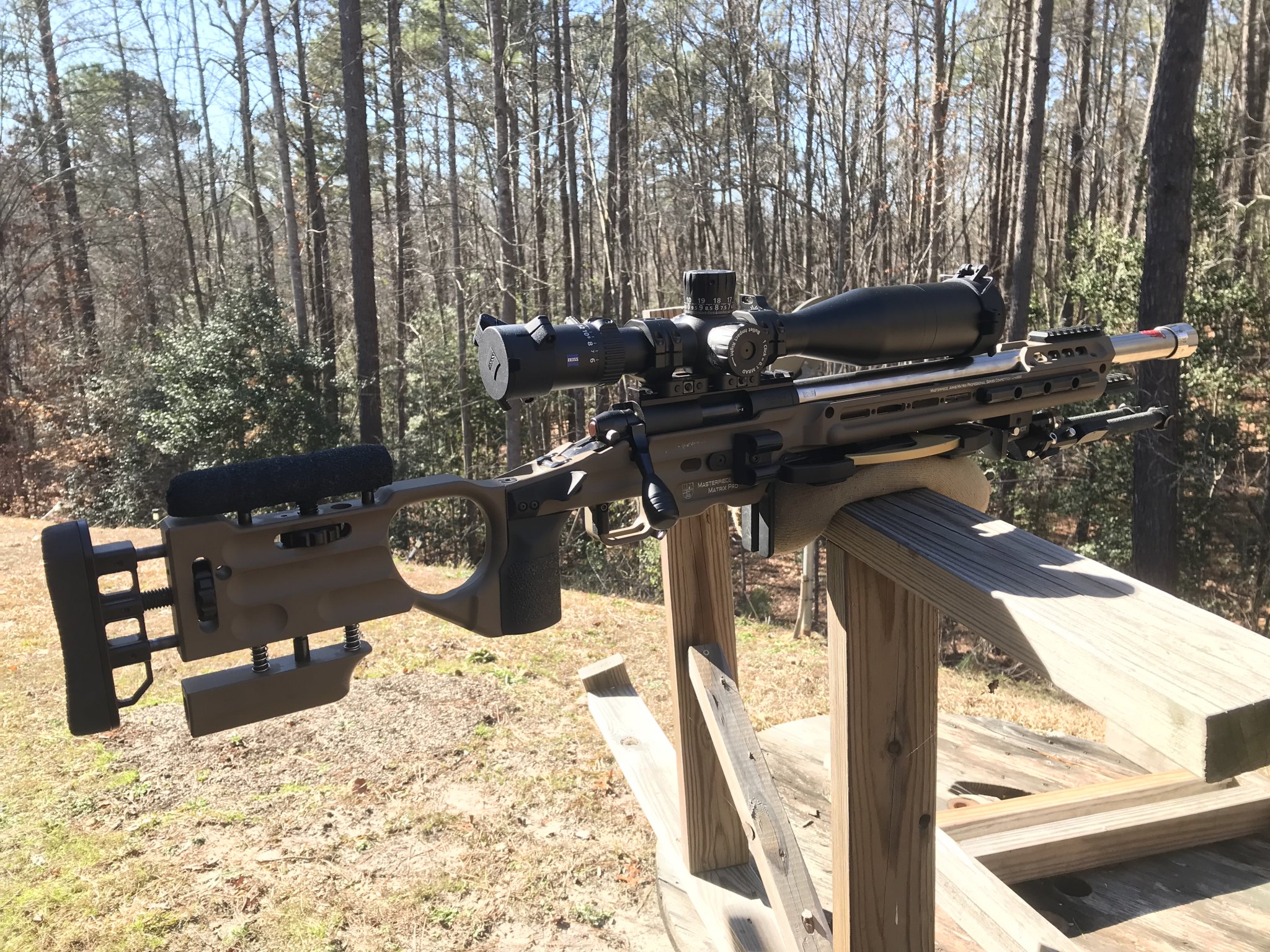

This is similar to what you want to build. Only it is rimx with 24 inch strait 1.20 krieger. Should give you an idea
Thanks for this picture. Any idea how much barrel is sticking out past the end of the chassis?
7 inches. 22 inch would look fine! And with the competiton chassis weighing 1 lb lighter in stock a mtu should balance pretty well
Matrix pro is very wide. I still really like the chassis alot. Just like the ba comp just a little more. Personal preference.

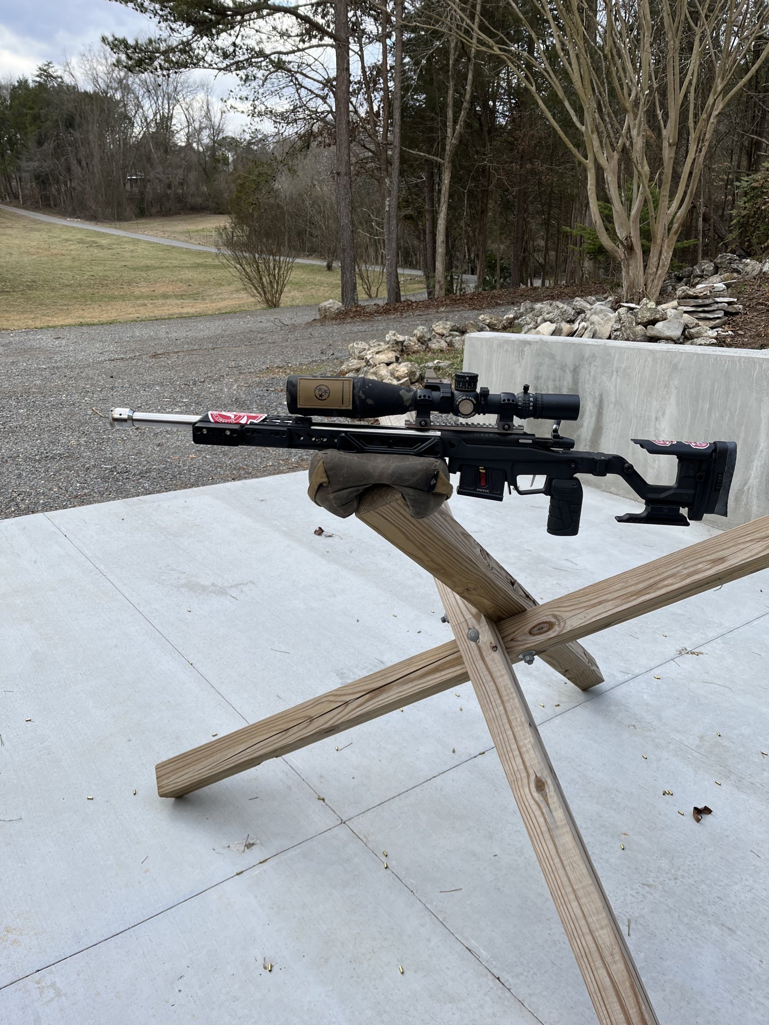

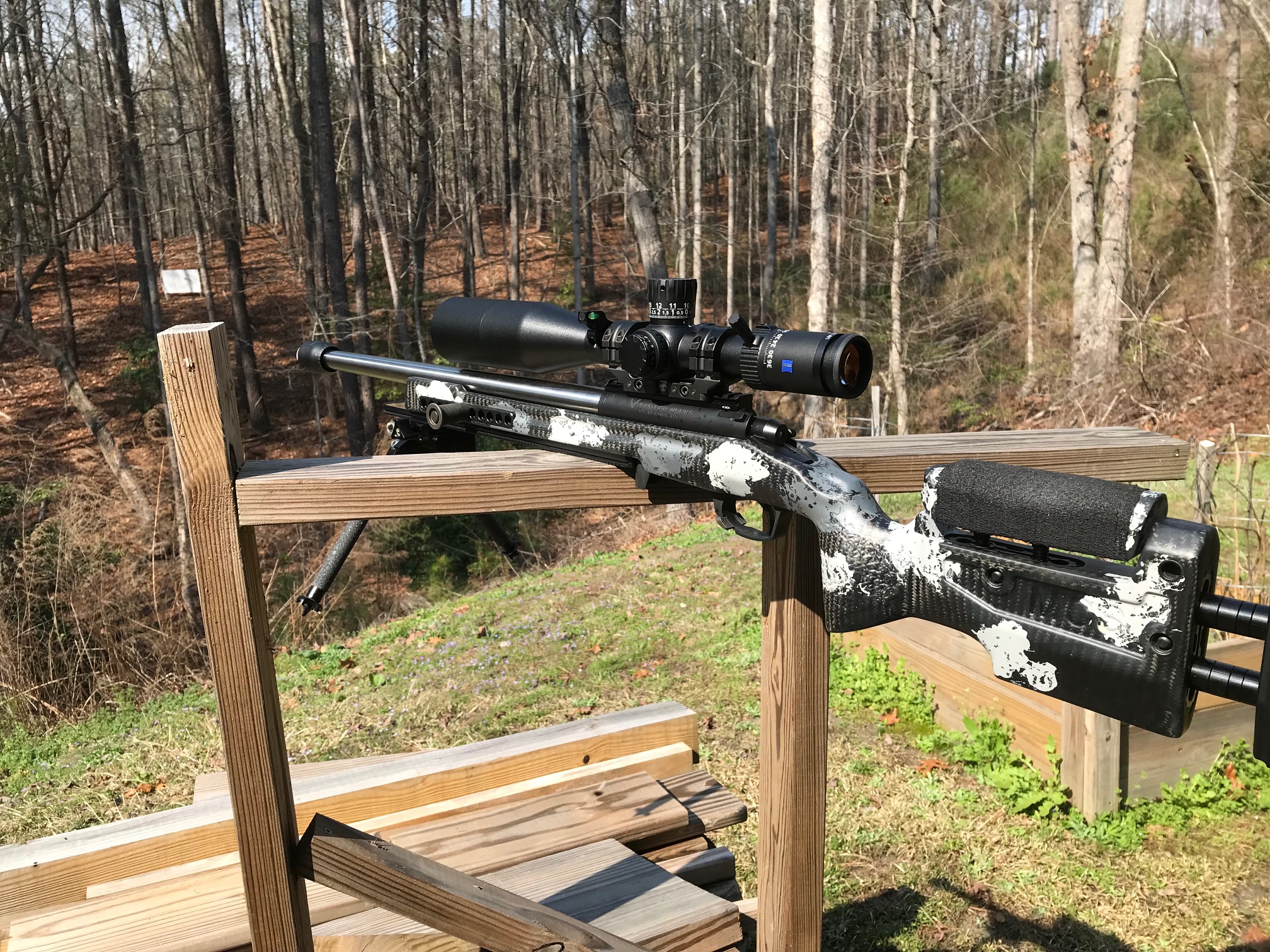

This was my V-360, 22" MTU in the Matrix Pro chassis....LOVE the chassis...but at 22lbs it still would not balance always butt heavy, and not sure I could of gotten it to balance....I had the full internal Gray Ops weight set and 2 Gray Ops long external weights install and Bipod...with the Bipod it was still just slightly butt heavy without it would not stay on a bag....Its was 22lbs without the Bipod.
I swapped it into an ARC chassis with 2 internal weights and it balances just a bit front heavy but will stay on a bag no problem, Just how I like it, also after talking to a few members here I added the +.030 mag latch to the ARC chassis and it feeds flawlessly....its 18lbs without the Bipod

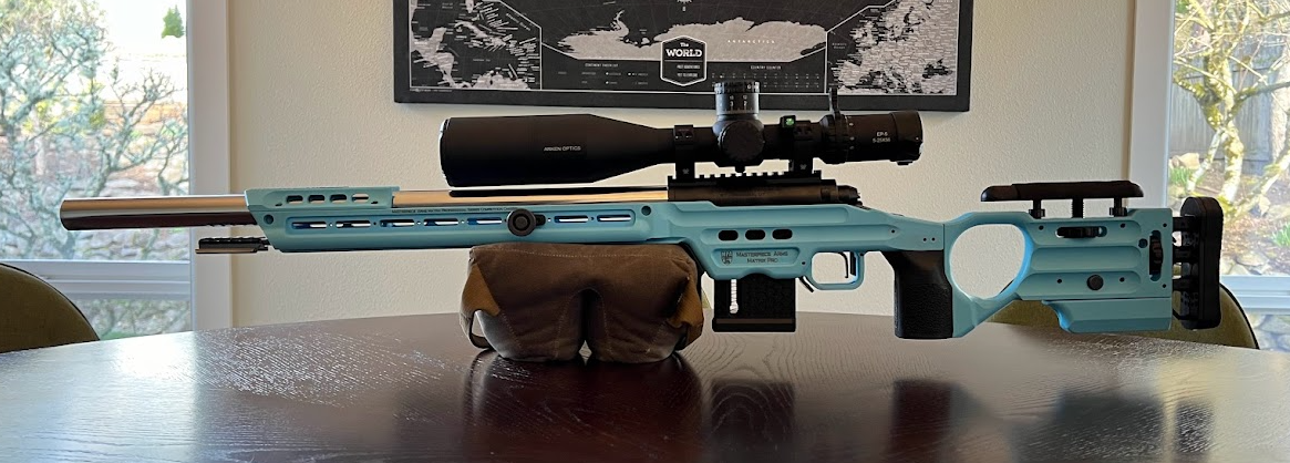

The pictures I posted are of the Matrix Pro 2 and it’s a great chassis I put my 6GT in it with a 1.25” 27” straight taper barrel and it’s front heavy.
From what I’ve read and talking with Johnathan at Modicam a 1.25” straight at 25” will balance with no weights but I do not know first hand but will soon I have Johnathan putting that combo together as we speak.

Good to know. So maybe a 24” barrel with a little weight up front will do it. I live quite remotely and there not a lot of opportunity for me to get behind these chassis. It’s going to be based on looks and as much user feedback as I can get.
If you could post some pics of it when you get it in hand I’d really appreciate it.

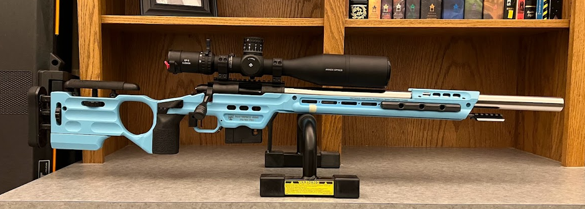

This is 22" straight barrel with acc elite chassis. It wont balance without the double pull. I have 1 pair of Gray Ops weights and 2 pieces of MDT internal weights inside at the front. Weight about 22lbs with everything.
I have pretty much tried every chassis available on the market, BA comp, matrix pro, ACC, ACC elite, Envy Pro, Centurion, and PRS-TCS. I can tell you 22" straight wont balance with any of them. ACC might be the closest one that I can made it happen due to the longer front end.
22" MTU might be even harder to archive balance. 24"+ barrel will help better for sure if the balance is what you are after.

Hopefully this give you some idea.

Thanks for this. It really does help with the visual. That ACC Elite paint job is awesome btw!
Well it definitely looks like I need to go to a 24 or 25”.

I did have my 23" 1.2" and 22", pictured above, in a MPA Matrix Pro at one point. The Pro had 4 internal weights in the front and two side weights. The 23" balanced well in it but the 22" was a little tail heavy. If ordering a Matrix Pro II you can get a lightweight competition rear and that would take care of the issue.

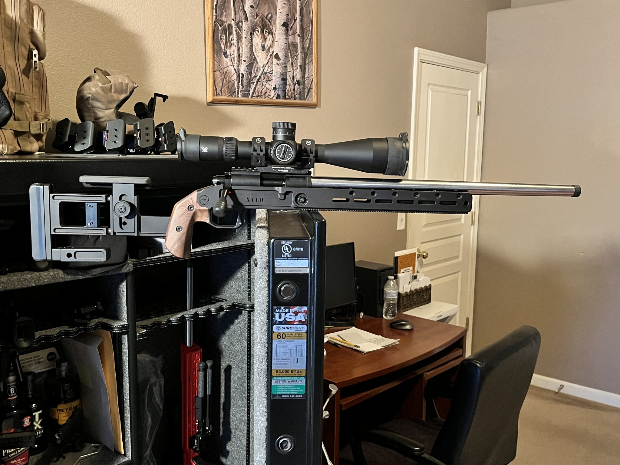

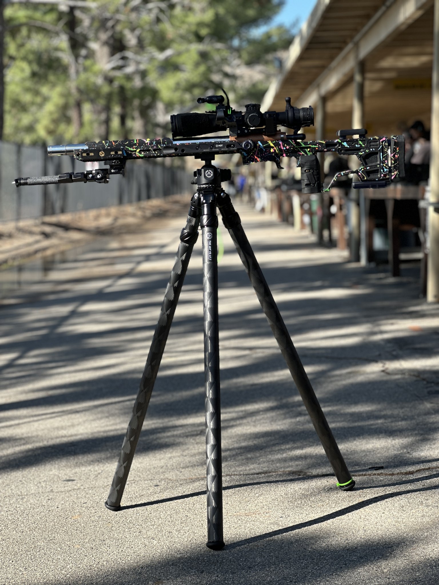

Not sure what you think about the XYLO chassis but this is my Vudoo 360 22” MTU balanced on my safe door about 2” in front of the mag well with 2 internal weights…weighs in at 18lbs as pictured.

Yea, I think I saw your picture before, but I could never get it balance for my case. I think you have a tuner in the front that will definitely help a little.
Just for PO, there are a lot of different way the rifle is consider balanced depends on the use case. I only do NRL22 mostly, so I need mine balance with game changer on a 2 by 4 (2" side) which is about 4" away from the magwell.
Also the weight of your scope matter as well since it will be on the butt side of the balance point, I did see a 23" rifle that balance well with a light weight scope/scope ring setup. So not just chassis that matter.

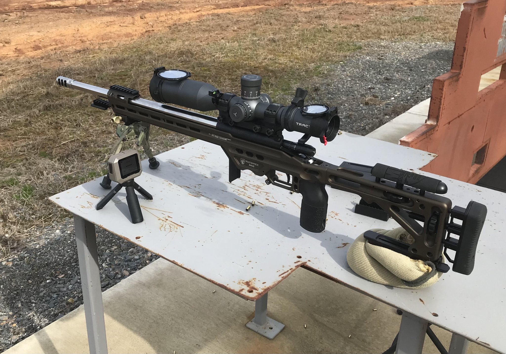

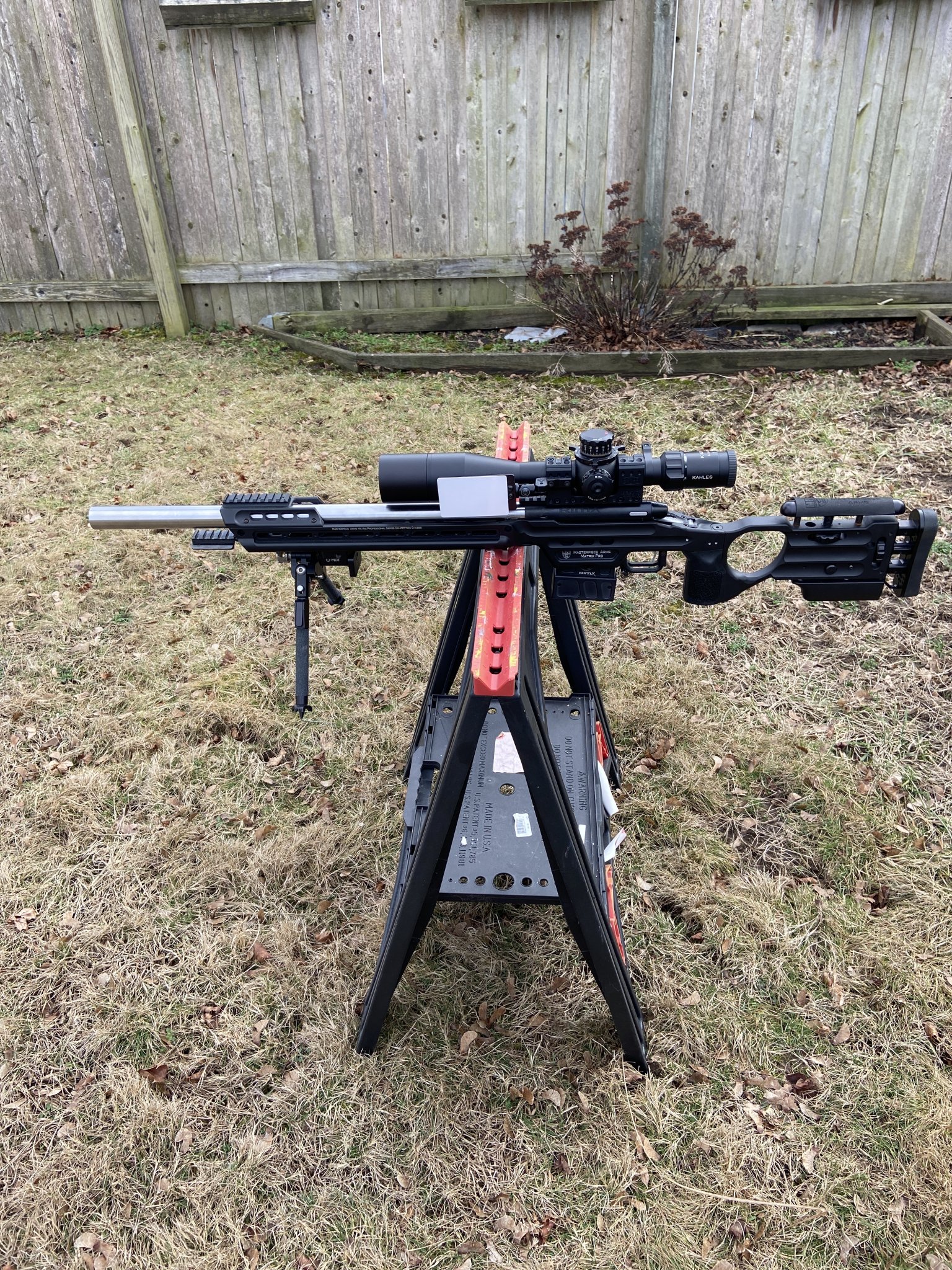

Many others with more experience than me have already given their feedback, but wanted to jump in an share my personal experience as I've recently completed my V22 build and had similar goals/dilemmas as you. I originally wanted an MTU or Kurki for the look, but my ultimate goal was balance so I went with the 24 inch 1.20 straight. I have an MPA Matrix Pro and picked it because I really liked the looks and features it offered. It is quite heavy though but was able to get it to balance out with minimal added weights.
The complete rifle weights in at 20 lbs which was a tad heavier than I was hoping for. Ideally I wanted to be at ~18 lbs. The 24" 1.20 Barreled action with bolt weighs 9.1 lbs. IIRC that's about 1.5-2 lbs heavier than the MTU barreled actions.
with 3 internal weights up front and steel spigot.
With 2 external weights and steel spigot.
I hadn't actually gotten it out to the range, but with just playing with it a lot I decided I didn't like the feel of the chassis as much as I thought I would. I have an MDT ACC and MDT Oryx on my other rifles and like them just fine, but something about the Matrix just didn't feel right to me. The wide forend is fantastic for stability and I had everything adjusted to my preference. I decided I really liked the feel of our CZ 457 in a Manners (the newer VPT stock) so decided to pick up a Manners PRS-TCS for this gun.
Anyways, long winded way of saying: If you really want to use the Matrix Pro, I would definitely get the 24" 1.20 barrel. It'll really help with the balance and the Matrix Pro Buttstock Weight Reduction Kit (10oz saved) would definitely help you balance it out without additional weights (though you might still need 1 internal up front). So you'd probably save a good full pound+ overall with that setup.
Weight breakdown of my rifle. Your scope is 5oz lighter than mine and if you can get away with no weights and use the Matrix Pro Buttstock Weight Reduction Kit you'd come in at 25oz (~1.5lbs) lighter.

Total20.07
PartWeight (oz)Weight (lbs)
Chassis (MPA Matrix Pro)6.6
24" 1.20 Barrelled Action9.12
00
Scope/Rings/Accessories2.95
Steel Spigot5.80.3625
trigger30.1875
Interal Weights (3)11.30.70625
Sikes Clutch Knob2.30.14375
Total20.07
Thanks a ton for all this info. It really helps. The color on that chassis is awesome! I really like it.
Question 1) The new pro 2 competition butt stock is 1 lb lighter than the Pro butt stick which is what you have. So I assume with your same setup in the new pro 2 chassis, you wouldn’t need any extra weights and would come out over a pound lighter?
Question 2) What was it that you didn’t like about the Mateix Pro? I’m in a tough spot where I have no opportunity to get behind it. I like the look and know that MPA does a great chassis. That’s what I’m going off of.
Always happy to help if possible. I really liked the color combo also, which is another reason I'm a little bummed I didn't love the chassis.
Question 1)
If you're going to go with the Matrix Pro 2, I would assume you would be fine without any weights up front. In that case you should be a solid 1 lb 11oz lighter. Though if you add more of the NV bridge segments than standard that would change a bit.
Question 2)
It's hard to pinpoint one thing and this is completely subjective, but it's a combination of a few things:
  • It feels very bulky. The wide forend does feel very stable, but it also makes the front really big. Compared to say an ACC with Baker Wings, that's just the rear of the Forend widened.
  • It feels very cold. Not that other chassis don't, but I think because I've spent to much more time behind the CF Manners stock on our CZ I've just grown to like the feel of something with less metal.
  • The grip just feels off to me. I've tried out multiple of the options and nothing felt like it fit my hand right. I have an MPA EVG grip on my Oryx and really like it. Maybe I needed to try the new Matrix EVG grip, but the standard one just didn't fit my hand well.
Honestly I didn't dislike the chassis, I just didn't love it or like it as much as I thought I would. For our 10/22 (in the MDT Oryx) and R700 223 trainer (MDT ACC) I might just not be as picky. But with the Vudoo, I figured I'm building this to be my ideal competition rifle so I just want something I really love. I did try the R700 in the Matrix Pro and liked the MDT better so maybe that should have been a sign. Since I had it already though I figured I'd give it a shot with the Vudoo. The Manners TCS just showed up today though so I'll be mounting that soon and will have an additional point of comparison.
I wouldn't overlook the XLR Envy Pro with the C6 buttstock. Mine is about 22lbs as pictured. Balances perfectly with a 24" Bartlien Heavy Palma. Not nearly as heavy as a straight 1.2 profile barrel.
The new Envy Pro that's going into production this month has different forearm length availability and a redesigned magwell that protects your magazine from your front bag. No more protective devices needed like I have on mine to keep your bag from inducing misfeeds.
