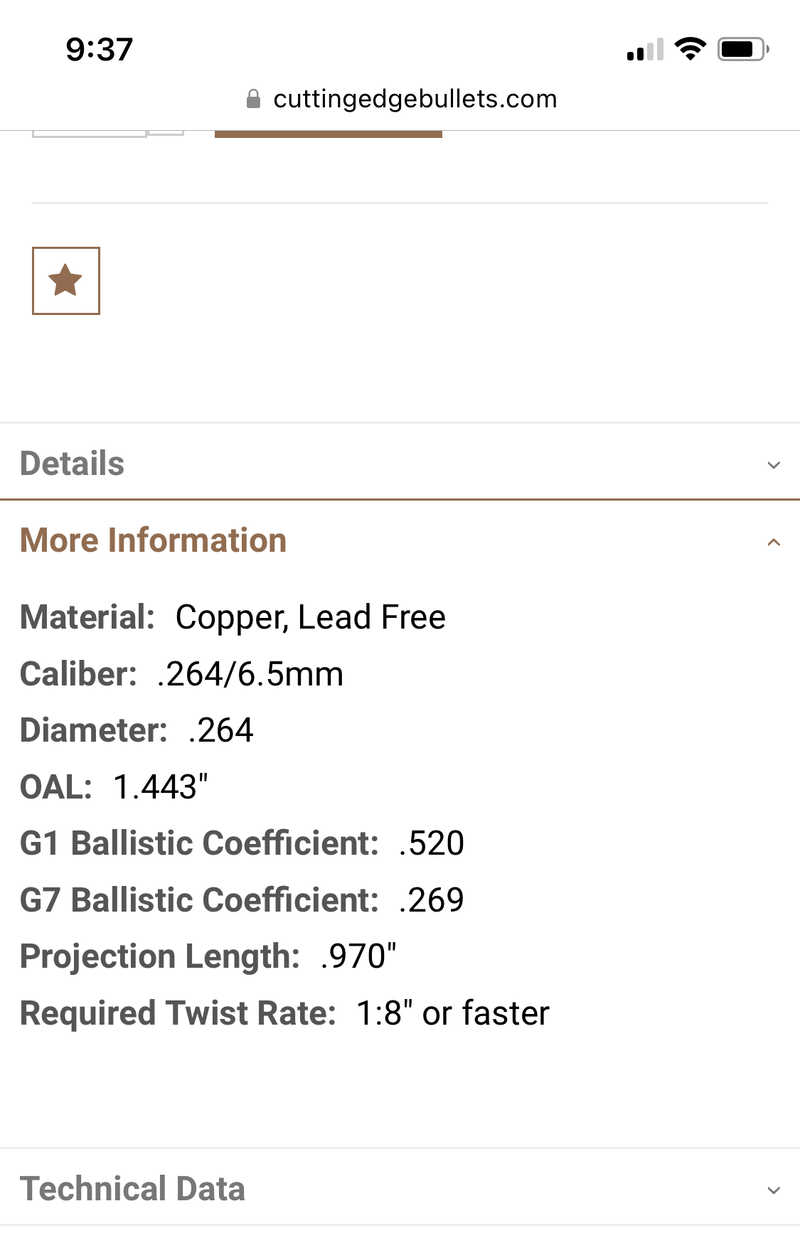

Here’s bullet info from their site:
Bullet OAL and Projection Length should answer your question.

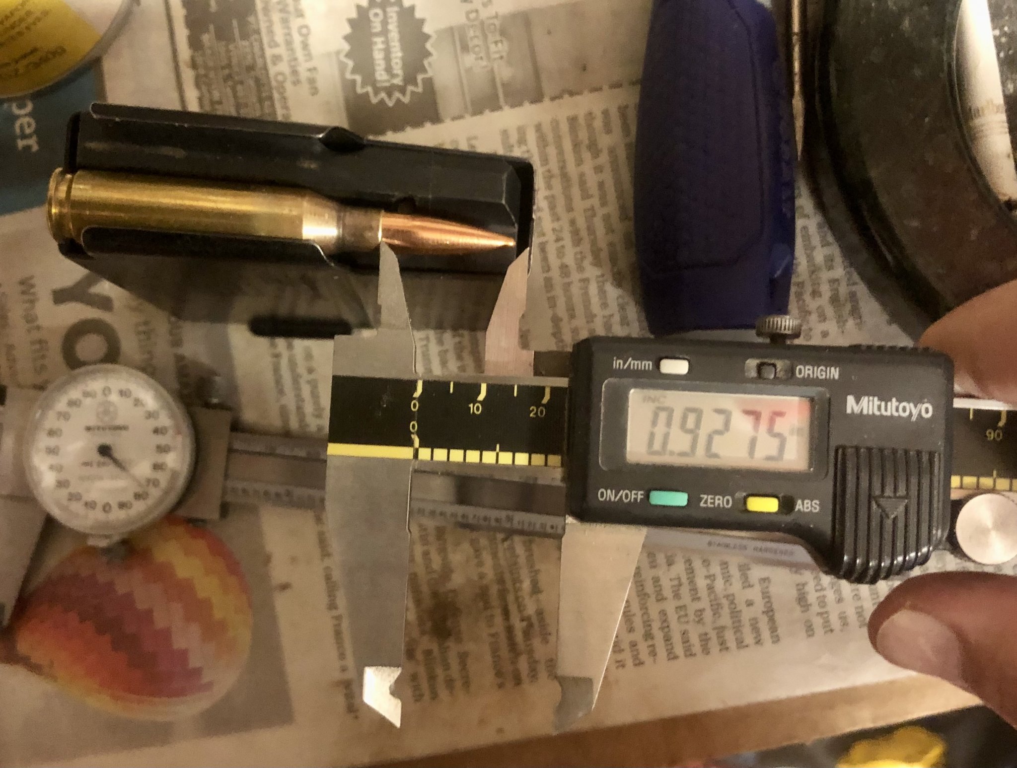

I'm shooting a 260 rem. The company doesn't reccomend loading the band into the neck which puts a limit on how short I can go. The pic on the sight looks like a single feed bullet. I'm running a Tikka CTR in an MDT chassis and mag.
Well, that’s why I specifically mentioned their listing of Projection Length. It’s 0.970”. That’s the amount that the bullet will project from the case. It’s also why knowing what cartridge you’re asking about matters.
Here’s a .260 round in an AW mag. It answers your question:
Now if you were shooting a long action 6.5 of some sort, you would likely have all sorts of room to mag feed these bullets.
Reactions: Taylorbok
Exactly what I needed. Thanks
