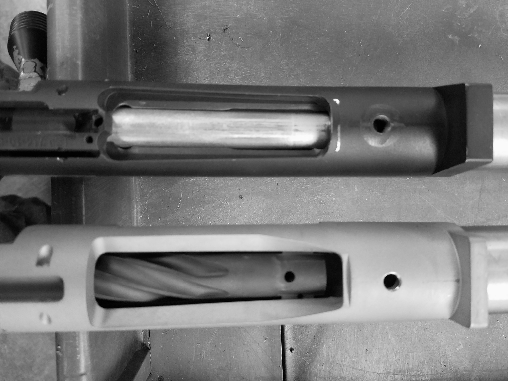

Piss poor image quality but this is what you are looking for.
The action shown at the top of this pic has integrally machined feed lips and mortise for the mag box.
The action shown at bottom is typical of receiver cuts specific to DBM systems that rely on the magazine to control the cartridge.
If yours is like the one on top, you are good to go with a BDL / ADL type feed system.
