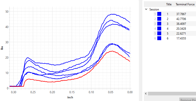

    Now that I have my AMP Press and can measure my seating force with great precision, I have a question for "The Collective". Is there a seating force target (in lbs of force at initial and/or peak) ... that any of you have found to be optimal? Or is it all about testing to find the force that's best for the particular barrel/bullet/charge/etc.?
    Asked differently, for those of you shooting precision long-range that measure seating force, is there a "sweet spot" you've found that's consistently positive, or does it vary significantly and require different forces for different scenarios? Is there a "target" force that you try to start your testing? Just curious ...
    It takes testing to determine what is sturdy enough for handling and magazine feed (or semi or full auto), and it also takes a balance between the prep and the load for precision and accuracy. So, you answered your own question well enough.
    ETA: as for a sweet spot, the minimum I would use for a precision bolt rig is about 35 pounds for single feed. Some guys let the bolt closure seat the bullet.
    Are you talking about 35 lbs Initial Force, Peak Force, or Terminal Force. My first attempt yesterday with 300-Norma cartridges ended up with averages of 34 (Initial), 80 (Peak), and 76 (Terminal).
    Terminal. When the total bearing area is within the neck. Note that I am suggesting a minimum for prone match loads where I am not jamming and I single feed and the calibers are typically on the order of 30 to 22.
    Your 76 terminal force value is typical. Like any load development, you will learn to collect baseline observations of what your process looks like, and watch for things like batch changes that change it, then test to verify it does or does not mess with your performance.
    Details like case history, annealing, cleaning, chamfering, lube, and sizing, can all have an effect, as well as the bullet batch itself. The AMP Press is an excellent tool for observing the seating forces in detail, but that by itself doesn't determine what is "right or wrong".
    That's really helpful ... thanks. I agree ... the Terminal Force seemed a little high, just on intuition. I'm thinking I'll take my Mandrel from the .3075 I'm using to get the 76 Terminal, and grow it to .3080 and .3085 to see what it does to my curve, and do a .3085/.3080/.3075 test with all brass the same except for the mandrel size. I don't want to jam when seating, but I do want to test a lighter seating force and see what it does to SD's and groups. BTW ... this is 1x Lapua, Annealed (AMP), and sized on a Redding Type-S with a .333 bushing. I'm pretty damn meticulous about my process ... so things are usually really consistent. Sometimes consistent "good" ... sometimes consistent "bad" ... but consistent nonetheless, making testing a change pretty accurate.
    I had some time on my hands, and I was super curious what a larger mandrel would do for Terminal Force that we discussed above. I made three cartridges with a .3080 mandrel (1,2,3) ... and three with a .3085 mandrel (4,5,6).
    The force above with the .3075 mandrel was 76-ish.
    The force with .3080 averages 39.7.
    The force with .3085 averages 20.1.
    Obviously a small sample size, but still ... little doubt that simply adjusting the mandrel size without changing anything else, produces the lighter seating force I probably want. (Not a shock, but nice to see the data.)
    Next steps ... (1) shoot the 23 I made with the .3075 mandrel and see how they perform. And (2) make a batch with the .3080 mandrel and see if the lighter seating force delivers any improvement in group size or SD.
