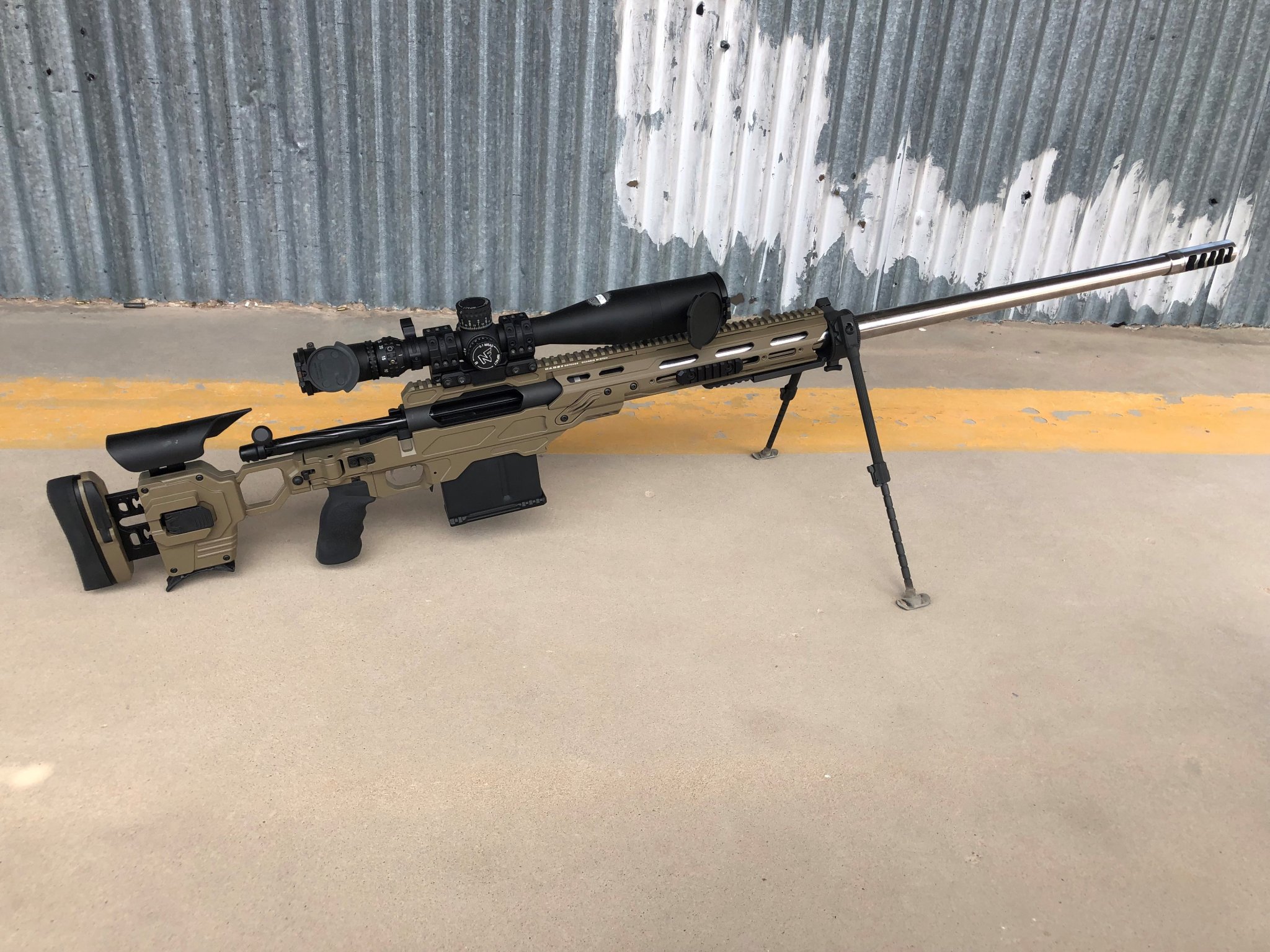

I went with the 1.6" TAC 408 for my 375 build and installed a a 36" 1.45" barrel on it.
