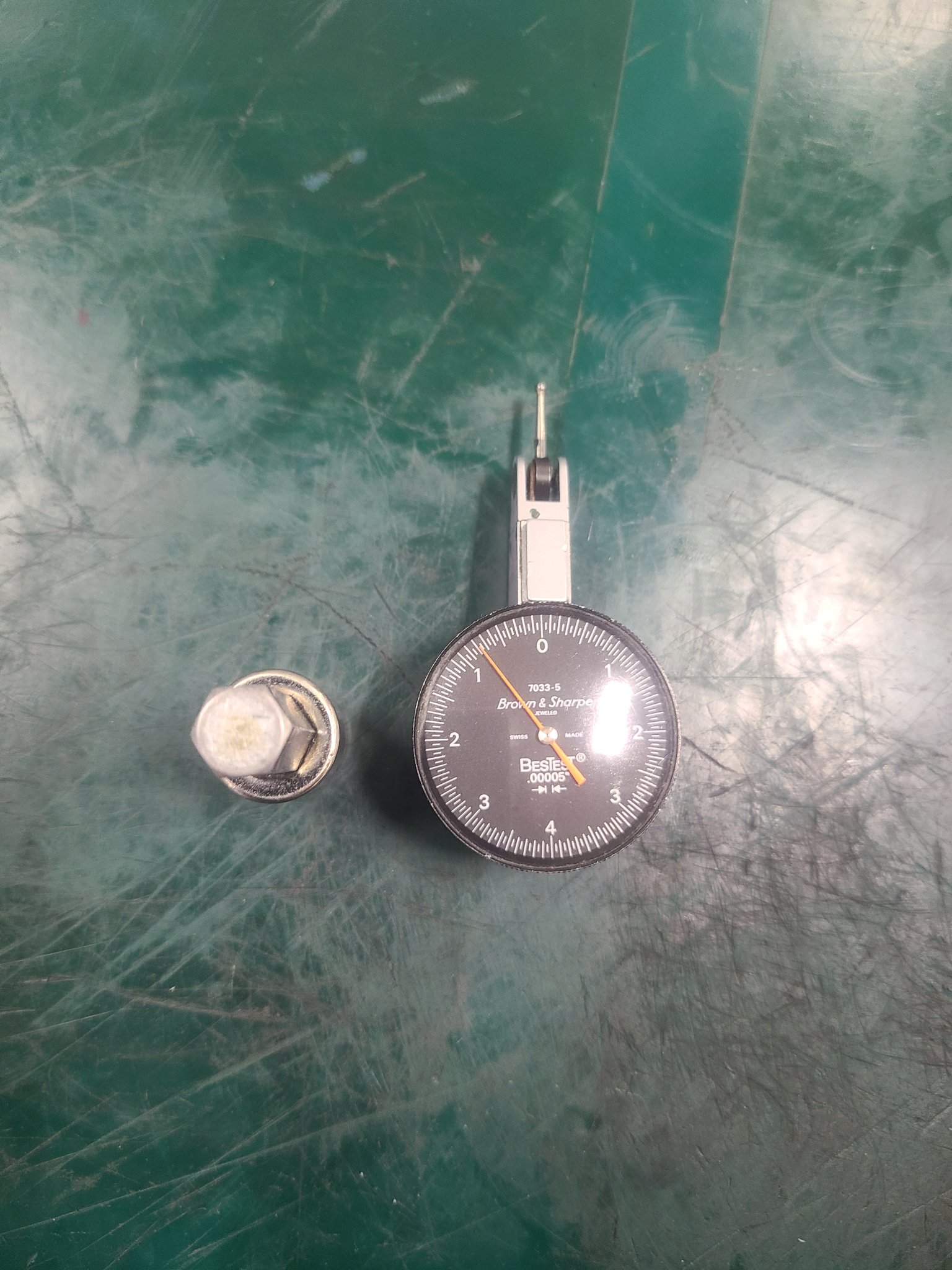

I know you're not a machinist. Some of us are. That sounds all kinds of weird to me. Hundredth of a thou or even less? So 0.001"/100=0.00001" which is ten millionths of an inch? How are they measuring that? No indicators go that fine. Ten millionths is 1.2x the length of a measles virus.
Example of a 50 millionths indicator. Next to a 10mm Allen.
I'm an aerospace grinder. Smallest adjustment on diameter I have ever made is 30 millionths. That was to maintain where I wanted it in the +/-0.0001" (one ten thousandth).
