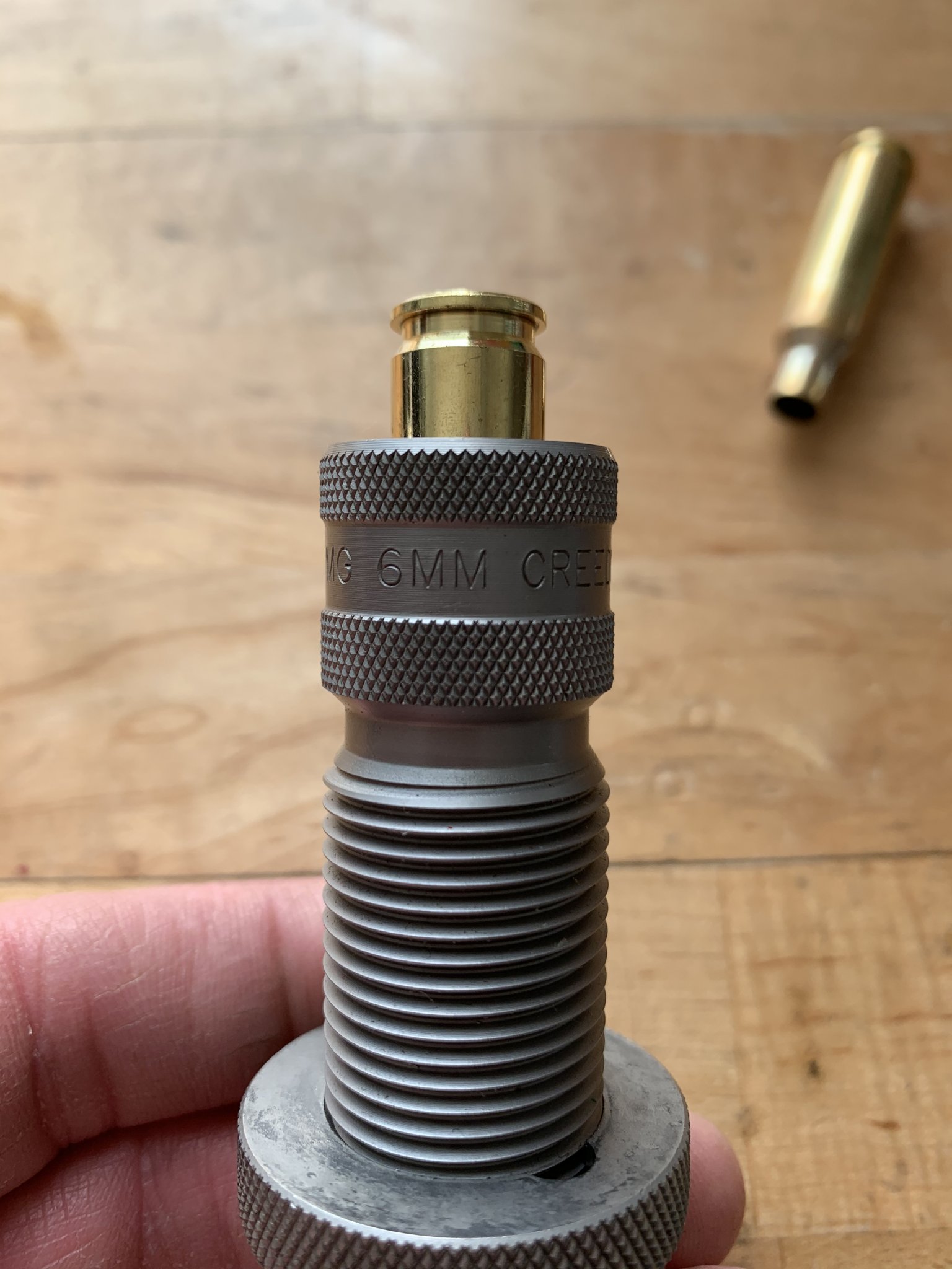

In the case of a hornady match die, it’s not even close. Put a 6.5 creed case into the 6mm creed die, and a it will come out most the way formed to a 6mm.
Hornady match 6mm creed die, bushing removed, 6.5 case inserted. Neck is not even Close to fitting.

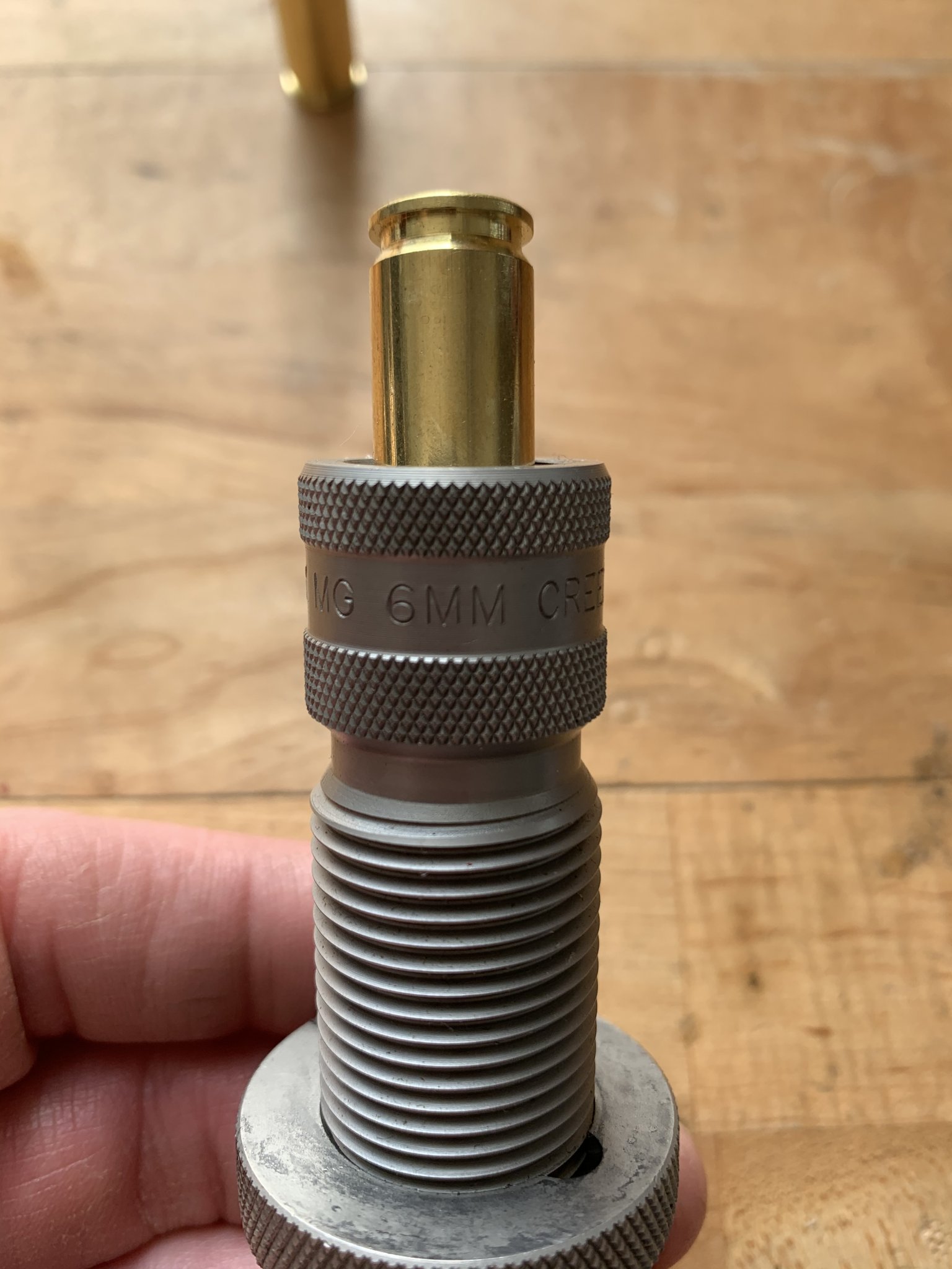

Same die, 6mm creed case. I took a measurement of the neck hole and it’s about .275” maybe a tad larger.
