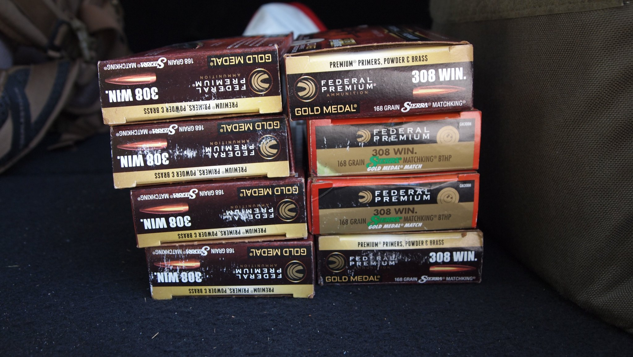

I am standardizing to FGMM because it seems to fall in to my lap in large quantities.
8 boxes were given to me yesterday.
I plan to load it for three firings in my bolt guns than will load it a few more for the AR10, than just recycle it.
I wont send it out for annealing as I have done with other brass.
