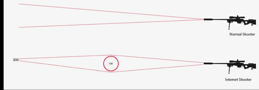

1) 100 yards/meters/whatever-minimal environmental effects due to short time of flight to minimize variables
2) Far enough to identify human input error but close enough to be repeatable results with fundamentals executed well
(Useful data)
3) bullet trajectory stays below line of sight thru entire trajectory until bullet is overcome by gravity (very useful in certain types of shots). The antithesis of this is a battlefield zero (or max point blank zero) of a rifle where the bullet rises above line of sight, then dips below line of sight at two different ranges.
This is why you zero at 100.

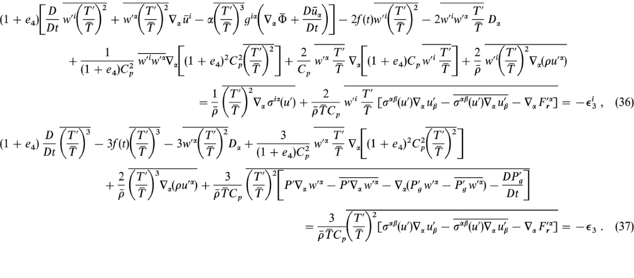

The reason you zero at 100 is because it takes 100 yards to achieve its full spin rate…
The barrel just starts it spinning, but Newtonian physics proves that it won’t be fully spinning until after 100 yards, then it gradually slows down until it goes to sleep.
I can run the formulas here… but it’s hard to type calculus and fractal geometry on a phone.
