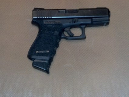

under cut and polished:)
Another one I did

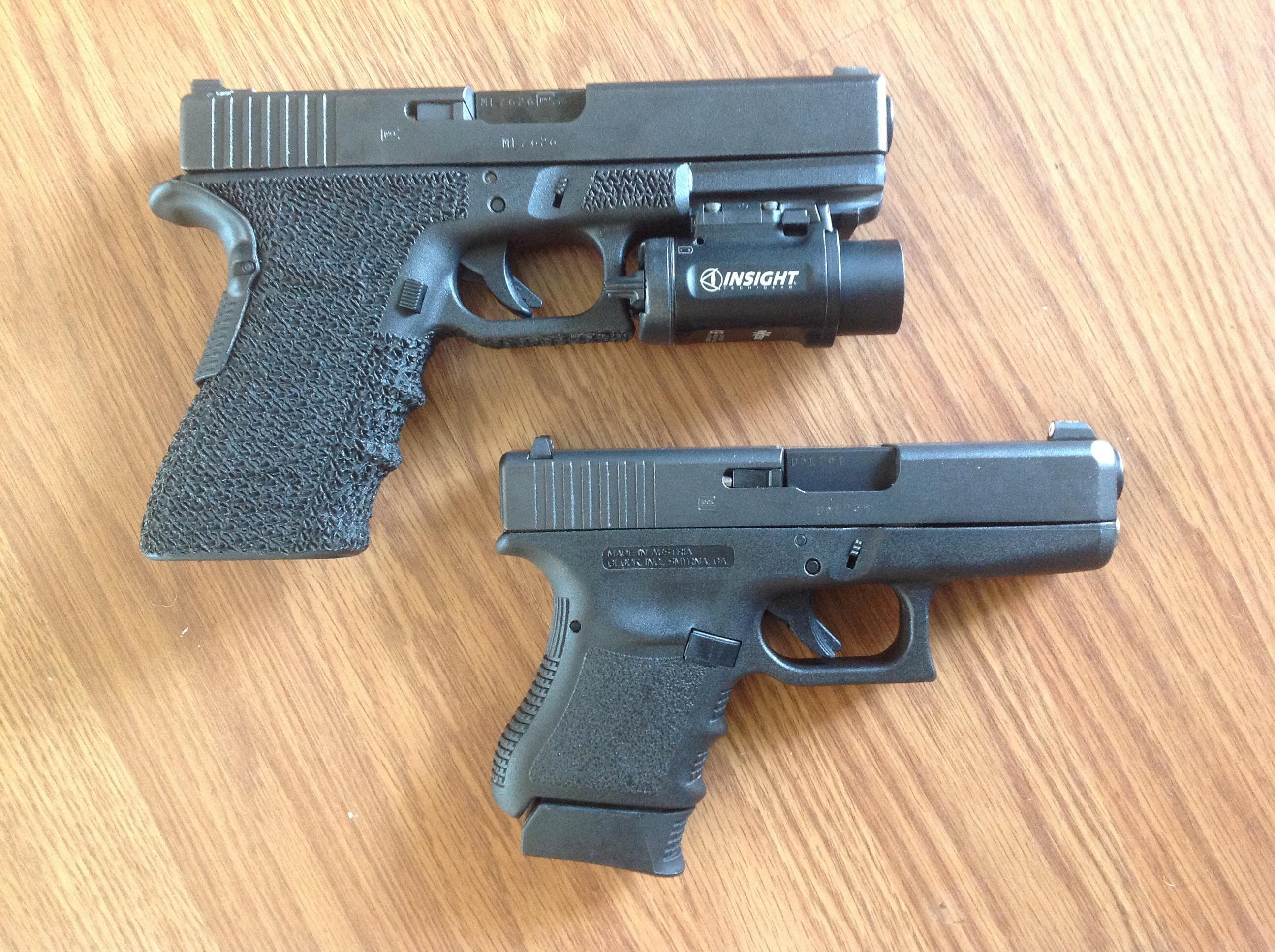

I used a flat iron tip to just melt and flatten the factory textures. It doesn't have to be perfect underneath, just try to keep it fairly level. Everything needed was in the kit Lowes sells for about $15.

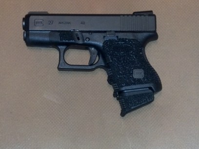

Leave it alone and stipple over it. No need to sand it. I practiced first on the cap from a water bottle and then went to the +2 magazine base plate, then the pistol. I started with a G 38 that had the finger grooves carved off with a paring knife. Previous owner. Then moved on to my new Gen 3 G 27. FWIW, I would not stipple very high up on the backstrap (Stop where the checkering stops), it get REALLY uncomfortable after a hundred rds or so.
