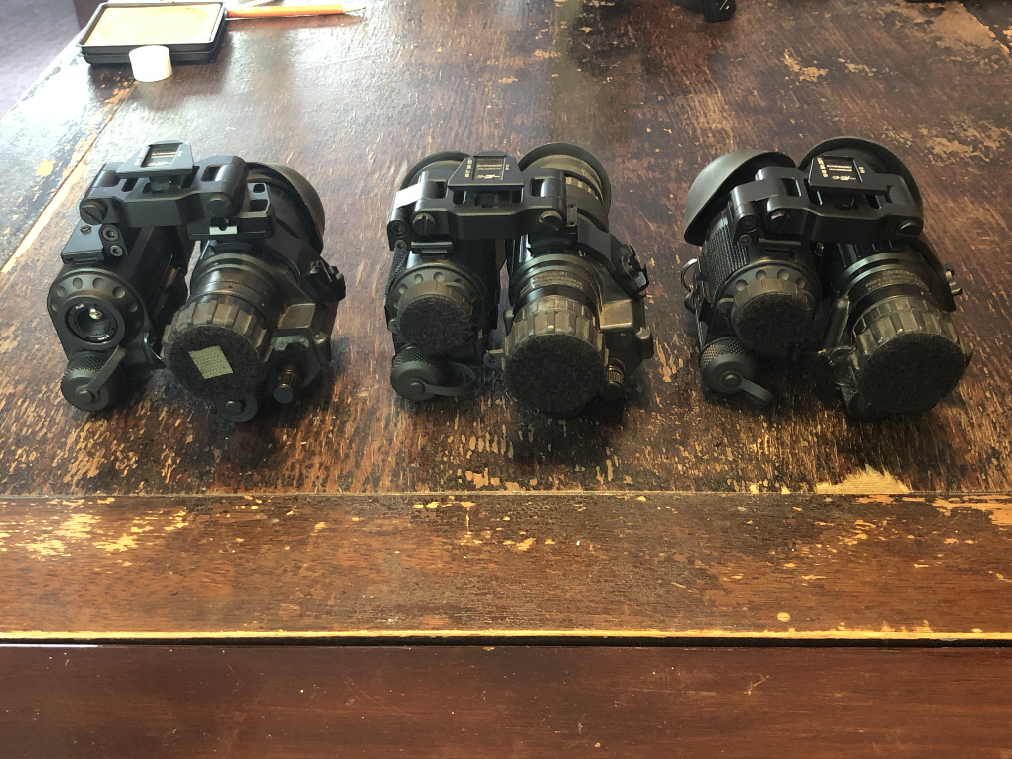

To all. I successfully make the MOD Breach arm and Breach work for me on the Light Weight Version Bridge. But I have a narrow IPD and also know how to turn the Breach mounting arm around and adjust it to make it work. YMMV. The safer bet for most people would be the Quick Detach Bridge. It is truly plug and play for any and all.
I have run the Breach successfully on every Mod Bridge made. Pay attention to how the Breach arm is adjusted on each mount. That is the trick.
Left to Right: Breach on Quick Detach Mount. Breach on Original Light Weigh Mount. Breach on current new Light Weight Mount.
I'm just getting into doing the homework on buying a mounting solution for a PVS/MH25 now, so forgive me if this is a basic question:
If I get the IC Dual mount - which I'm assuming is the one on the far left - can I easily disconnect one of the tubes to hand to a partner?
Also, any other parts to order other than one Breach arm and one PVS arm? I'm comparing it with a KVC bridge which seems to require a lot of other adapters and whatnot.
