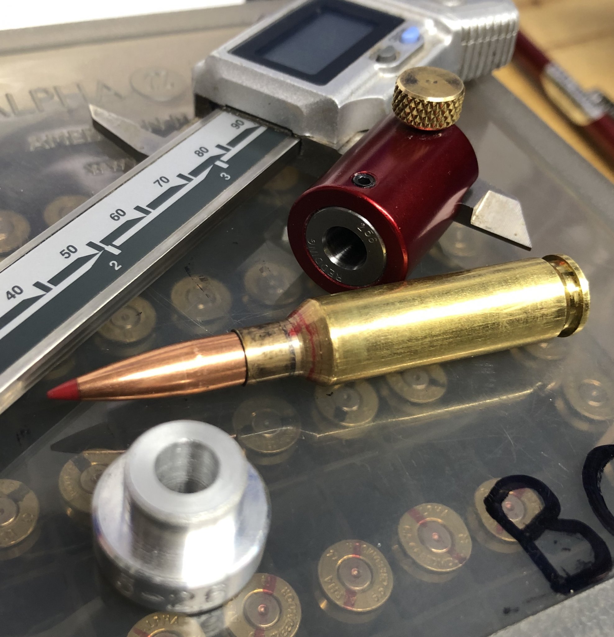

With Respect to the aforementioned Redding Instant Indicator and Hornaday headspace gauge used to measure base to ogive; I found a difference in the diameter of the bushings (e.g. ogive contact point) between these two instruments.
In 6.5CM the Indicator bushing is .256 and my Hornady 5-26 bushing is .254. this difference, albeit small, was giving me headaches when measuring different bullet shapes and seeing variation in length between the two tools.
To solve this problem I purchased another bushing from Redding identical to my instant indicator bushing and then mounted it in the Hornaday headspace bushing holder. It fit in with no machining and now I get identical readings between the two no matter what shape bullet I measure. I placed a light compression spring behind the bushing (e.g. inside the bushing holder) to make zeroing the caliper and bushing removal easy.
