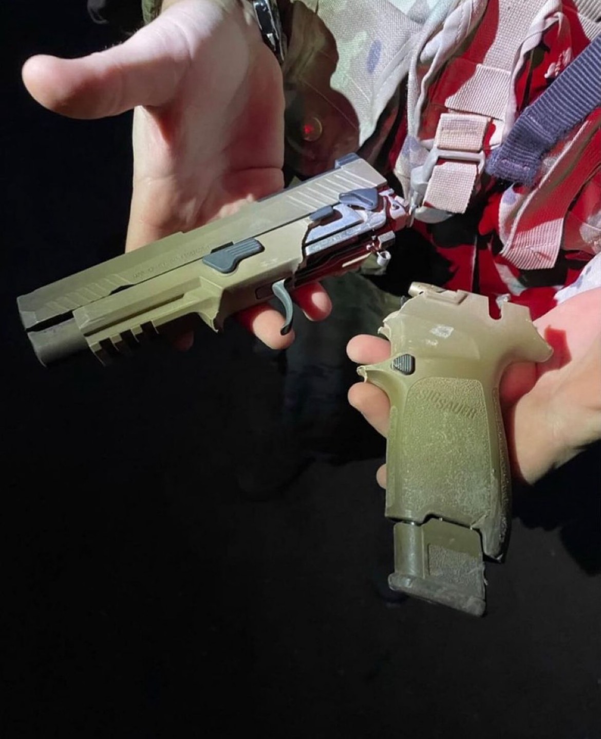

    Saw this posted on IG the other day… 😂
