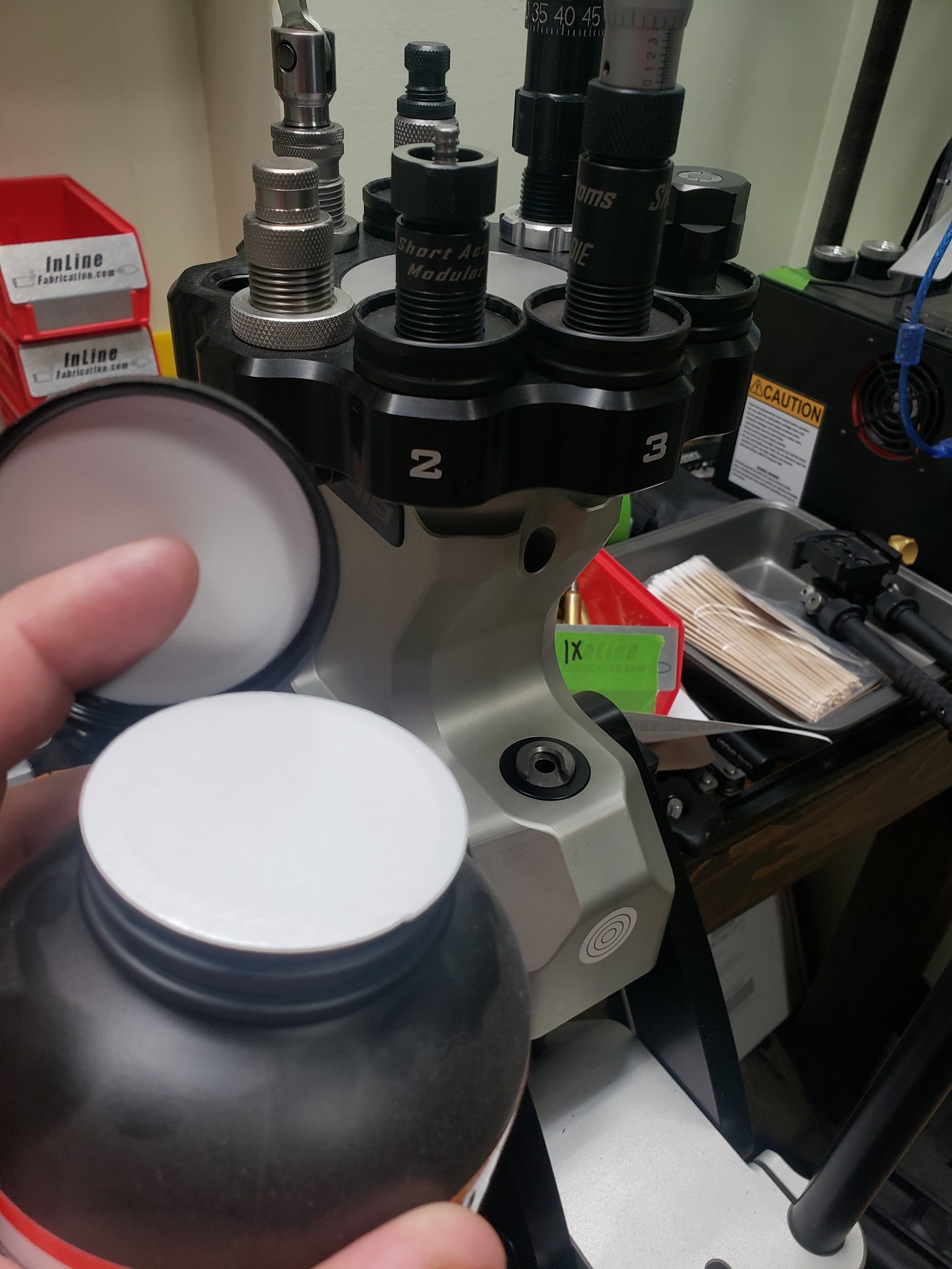

I have 20 or so of these Varget pounders and I checked 5 of them. you can see where I tried pealing it off. This inconsistency is bothering me
Ill have to check my kegs now, y'all got me paranoid.
Same here.
Me too, dating back a lot longer than 12mo on my end tho. The first time I noticed it I was SURE it had been tampered with…then it was every other or every third I opened had a foam disc hanging by a thread.
