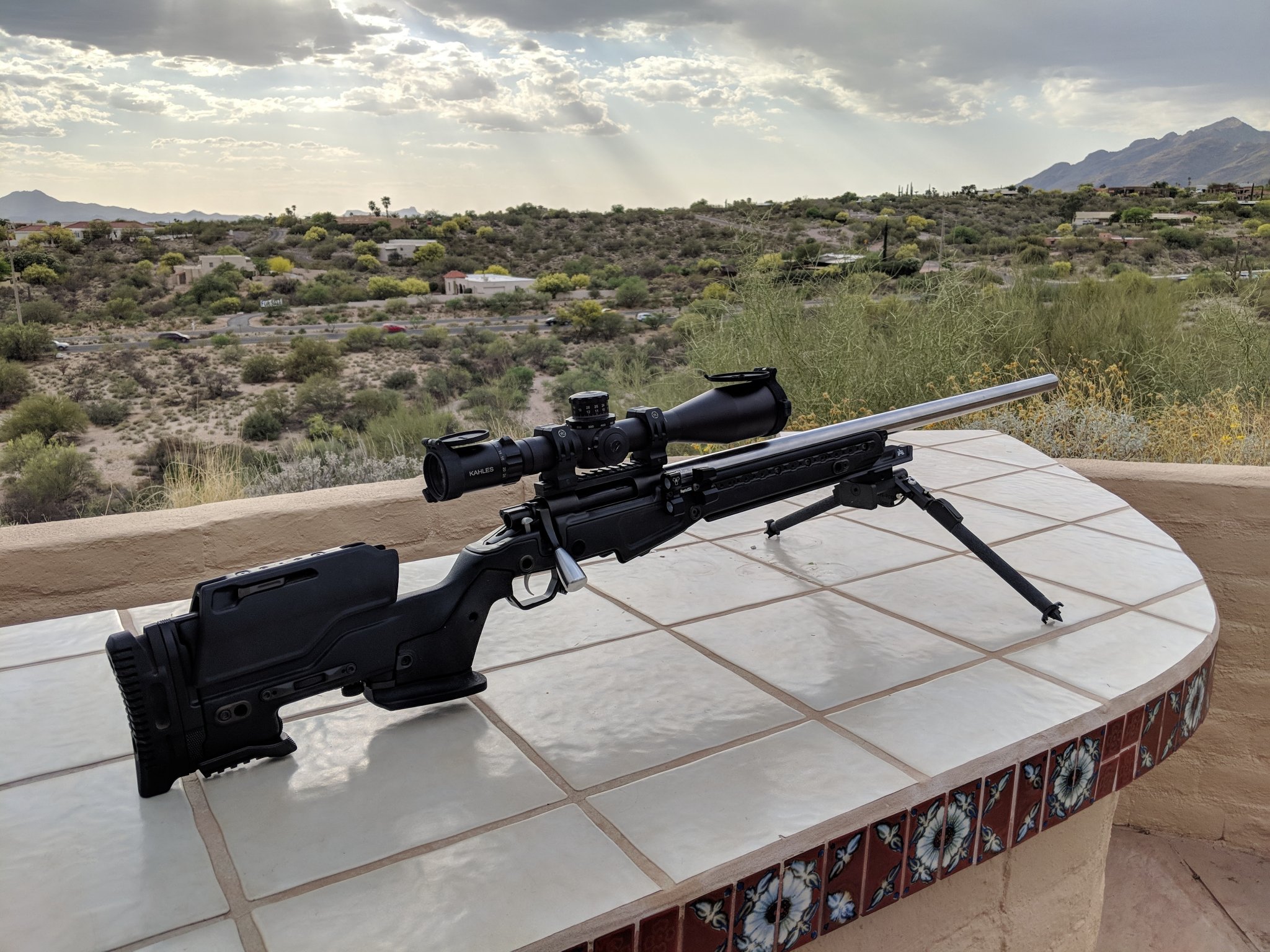

Here's a heavy varmint on a Mausingfield:
Personally I'm a fan of heavier contours. But barrel contour is personal preference and mission dependent.

For a part time range rifle/heavy hunter I'd recommend looking at an all-in weight of max 14-15lbs. For some folks that's a competition rifle. As an example of what comprises a 14lb rifle, I hunt with a Tikka T3 in a KRG W3 chassis, 26" sendero contour CarbonSix carbon barrel, TBAC Ultra 7, B&T Atlas Cal bipod, topped with a NF NX8 4x32 in Warne Mountain Tech rings. With a 10rd AICS mag, that's 14lbs. That's the max I would do any sort of hiking with. And if I killed a sizable enough animal I'd have to ditch the rifle to pack meat. When hunting on the east coast I use a 9.5lb rifle. That is a Bighorn Origin, 22" Carbon Sendero barrel, TBAC Ultra 5, HS Precision lightweight sendero stock, HS Prec DBM, March 3x24 F1. Thats one of the lightest tactical scopes and suppressor you can use. Its a comfortable walking rifle but by no means a lightweight or even standard hunting rifle.
