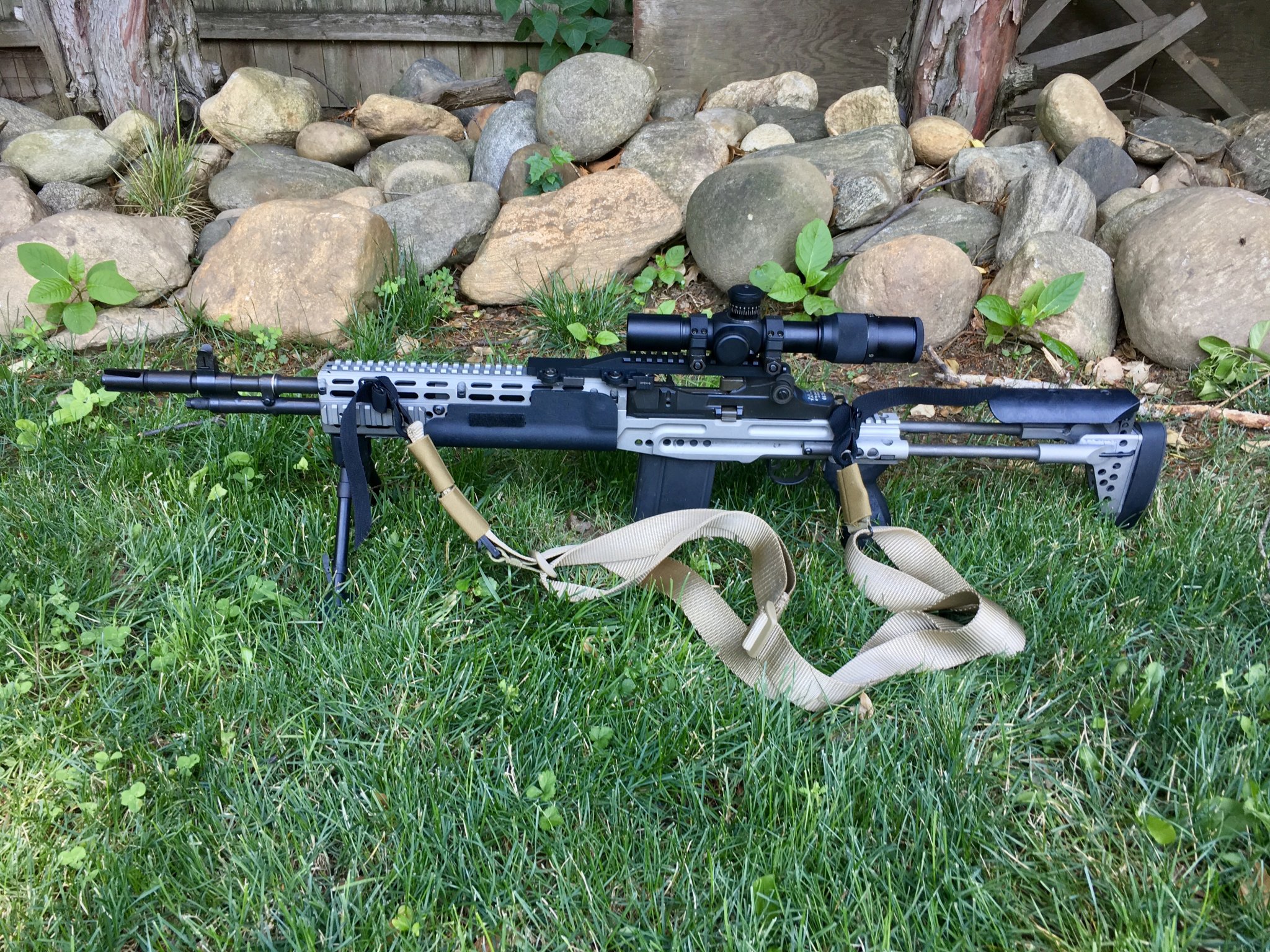

Own a Sage, have an 18” Bush Rifle mounted in it, she’s a blast, but for your dads rifle I’d go Long stock/chassis

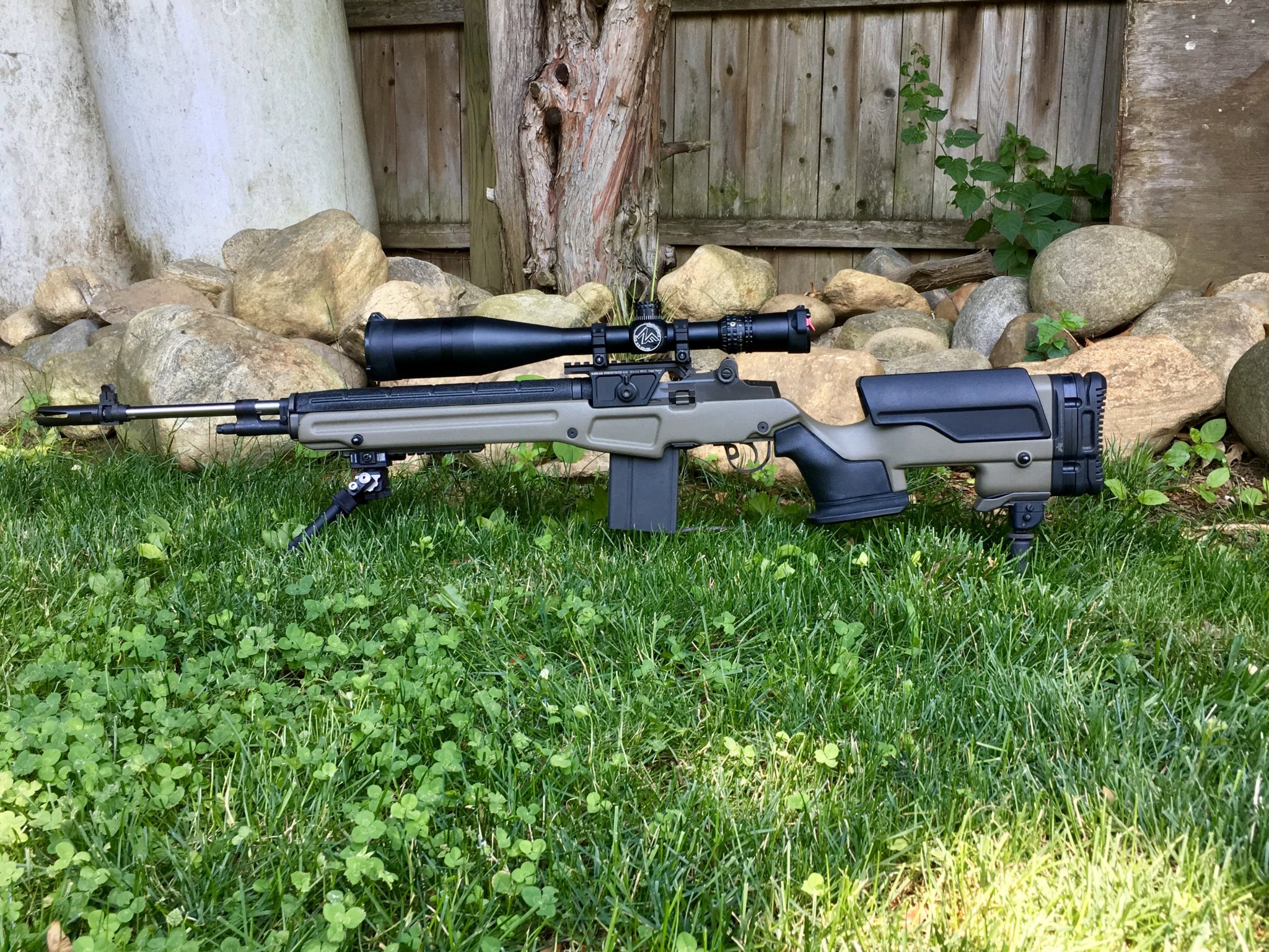

Also own a Loaded which is wearing a JAE stock. It’s a bit heavy but it’s a shooter. Hope this helps
