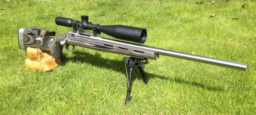

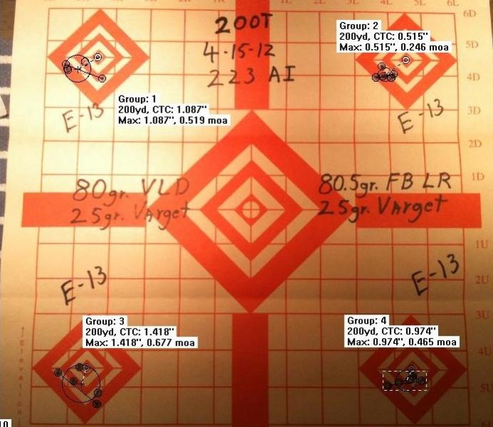

I built my 223 AI on a Savage large shank repeater action. The barrel a 26 inch 8 twist Brux. I have no doubt the action will last many thousands of rounds.

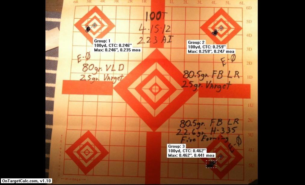

Fireforming has been a non-issue. I get acceptable accuracy during the process. I generally despise messing with brass, so I don't. That's the best part of going A.I. for me. I'm not that good of a shot to have to worry much about preparing my brass for this rifle. It's a fun little blaster. I'd rather be shooting than reloading.
