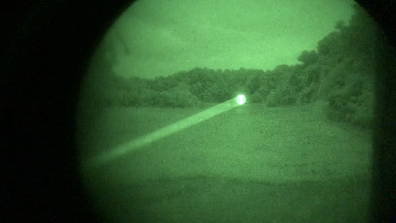

The new B.E. Myers Kiiji cant hold a candle to the Luna. Here is the Luna at 1,000 yards exactly at the tree line. The Rheostat also allows you to instantly adjust the power being emitted so you can dial in the perfect power and beam width for your environment.
The ability to adjust the bezel and corresponding beam width is critical for a properly performing IR Illuminator. The Kiiji beam is so wide it will illuminate the ground in front of you and make your tubes autogate and downrate because of excessive light bouncing back into them from the Kiiji.
