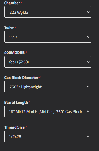

Getting ready to order a barrel from Craddock Precision and just wanted to see if there is any options you would change if your goal was a first round capable 600 yard AR15. Still debating between an RC2 and OCM5 and Im mainly going to be shooting match ammo. Anything worth changing or should I send it as is? Also is the MODBB worth an extra $250

torso sized steel for the most part. Mainly just want a Bartlein barrel because it’s a Bartlein barrel. Just double checking that a different configuration wouldn’t be better.

Twist: 7T, 400MODBB: No, Gas Block Diameter: .750" / Lightweight, Barrel Length: 18" Mk12 Mod 0 (Rifle Gas, .750" Gas Block Dia), Thread Size: 1/2x28, Thread Protector: No, Fluting: None, Accessories: None, Headspaced Bolt: None, Finish: Cerakote Magpul™ O.D. Green H-232 (+$65), Built Upper Options: None, I Acknowledge: Yes

I agree with the 5/8x24 muzzle threading. I’d ask what size the gas port was on a mid length. No need in getting a huge gas port if you don’t have to. If it’s going to be shot suppressed all the time, I’d let them know. It’s a custom barrel, they shouldn’t mind sizing the port to whatever size you want.
ETA: If they offer a CLE chamber, I’d rather have that.

1/2-28 is for .22lr and 9mm. All my centerfire cans are 5/8-24.
The main reason I was going to go 1/2x28 was because I’m going to run either an RC2 or OCM5 and both have compatible 1/2x28 muzzle devices.
is there a 5/8x24 muzzle device that works with an RC2?

Opens up options for muzzle devices, TOMB, and direct thread suppressors. 1/2x28 can be more difficult to find. You likely have 5/8x24 stuff laying around. Might be other reasons
Less material removed from the muzzle end during machining. Some say it makes a difference, some say it doesn’t.

Don’t waste $250. No need
Rifle gas
5/8x24 preferably but likely not that big of a deal

if you're considering using your OCM5, then you might have the barrel profiled a la MK12, get the collar and brake. Only you can decide the direction thats best for you.
