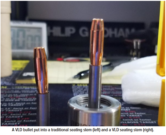

I normally run Hornady ELDM's in 6.5 Creedmoor, but I was able to find some Berger VLD bullets at the local gun store recently, so I went ahead and picked up a few hundred.
I seat with a Redding Type S Match die. There seems to be some info floating around online about needing to use a VLD variant seating die, but the one I found for Redding are for their competition die. Its Redding part number 55746.
Questions:
1. Will that part fit in the Match die?
2. Do I really need it? What is the downside of not using it?
That's the one you want (I think) ... the VLD Long Stem that goes into the Redding Competition Seating Die. The "Type S" is the full body die, not the Seating Die ... unless I'm mistaken (which is possible). Talked to Redding about issues I was having with seating on my dies, and they sent me to get the VLD stem. Haven't had a problem since.

Check what you have now, if it makes contact all the way around you are good. If the nose bottoms out and ou can teeter it left and right on the nose instead of touching the whole way around then the vld stem is what you need so that it doesnt bottom out.

Here is the application guide table
You want the long one (in VLD stems, the make long and short), part # 55746

I was struggling with "wandering" seating depth. I'd get one that measured spot-on (case-to-ogive with a compilator) ... and think I was good. Then the next one would be a few thousands high or low. I'd adjust to it, and the next measure may or may not work. I just couldn't get the depth to stabilize. Then I got the VLD stem, and all that went away. Now depth is consistent, and die-based micrometer adjustments work the way they should. Now I can adjust to spot-on my target, and seat 50 bullets that are all to identical depths.
