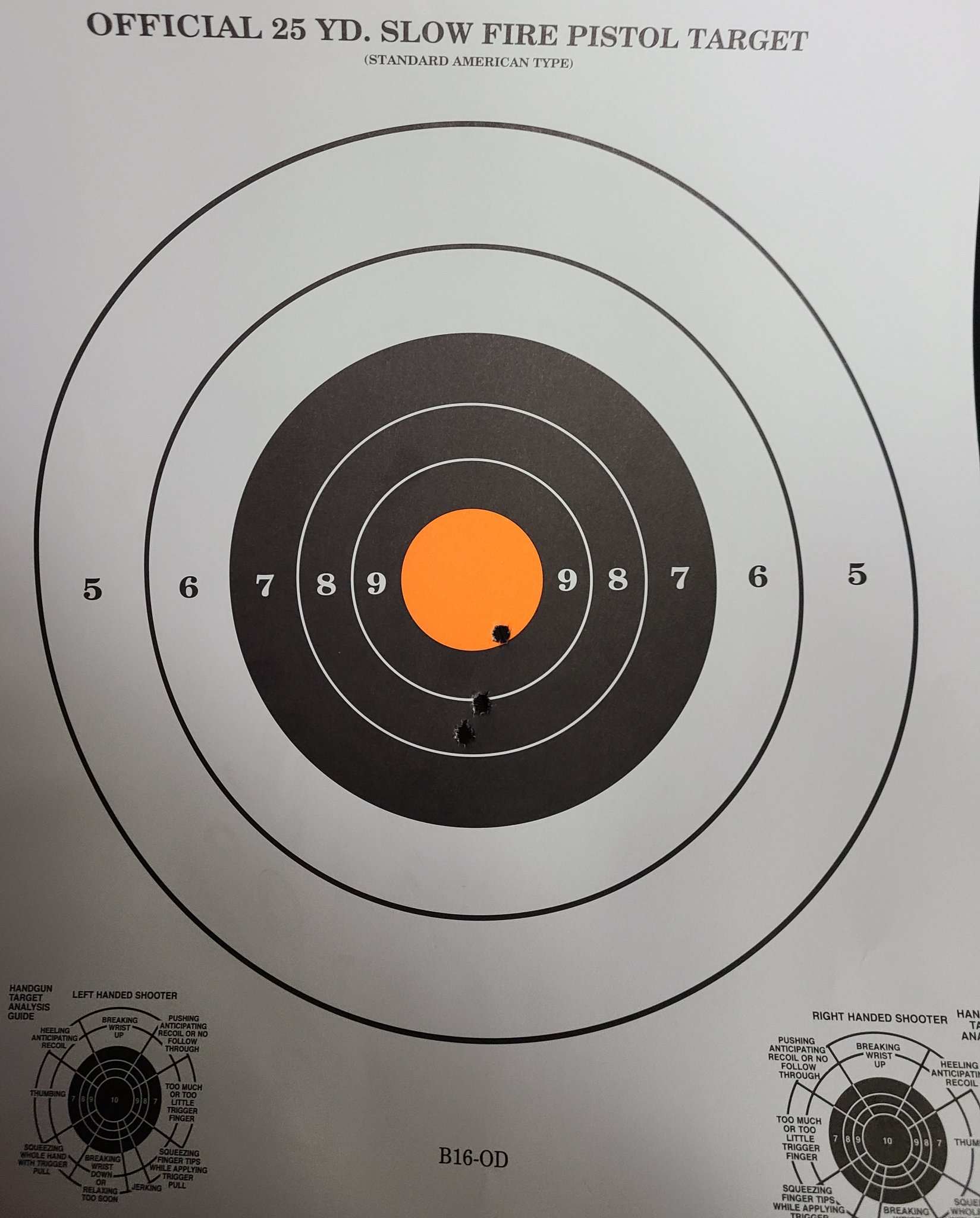

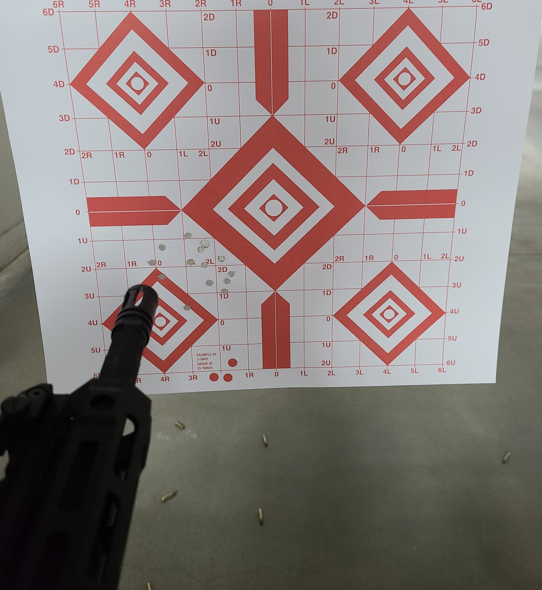

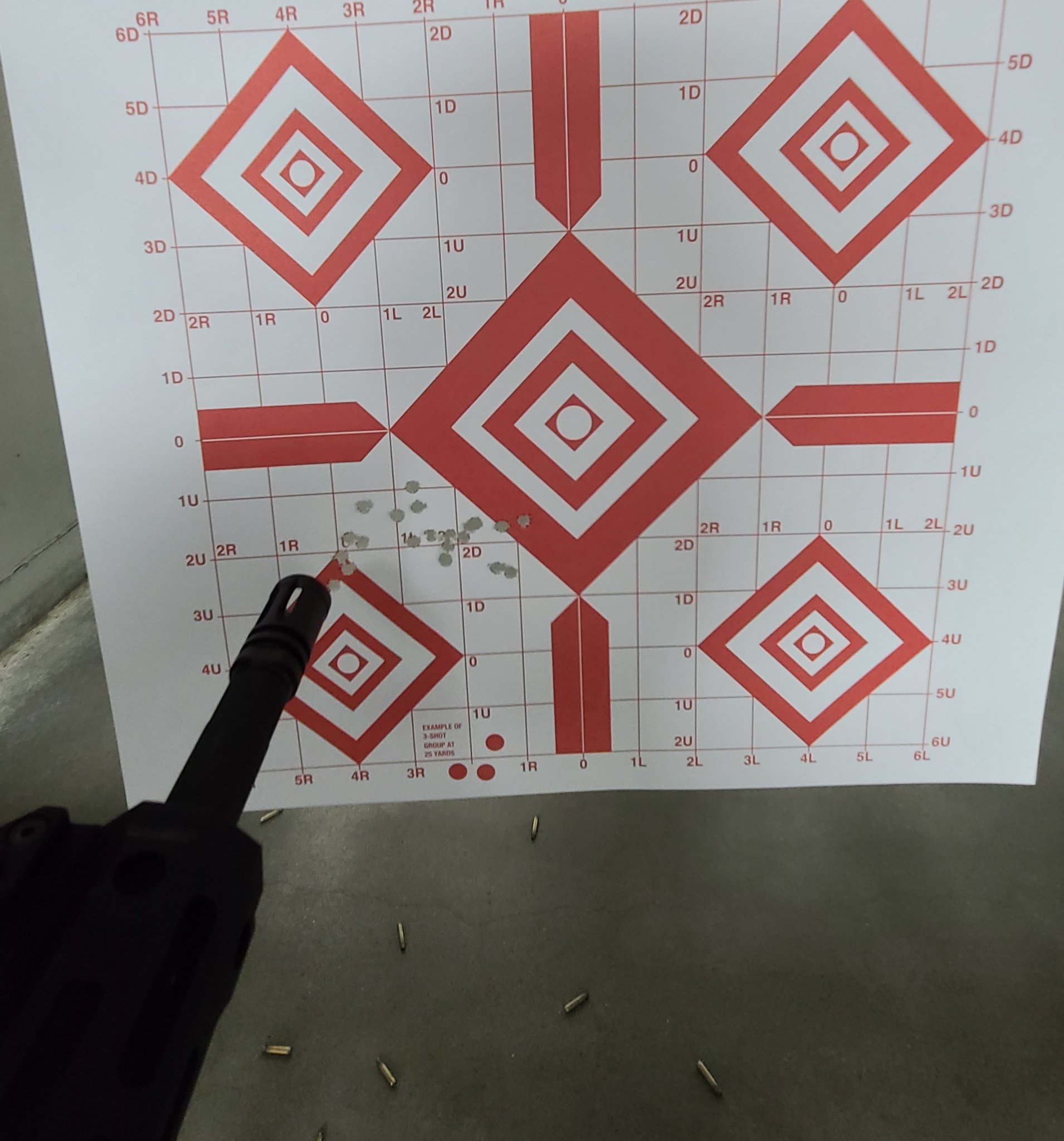

I began shooting 3 shot groups; my first two groups were 2.75" and 4", respectively, left of center. As I made windage adjustments to the front sight, per Ultradyne instructions, I was able to get groups to ~1.5" left of center, however, this took a significant amount of adjustment.

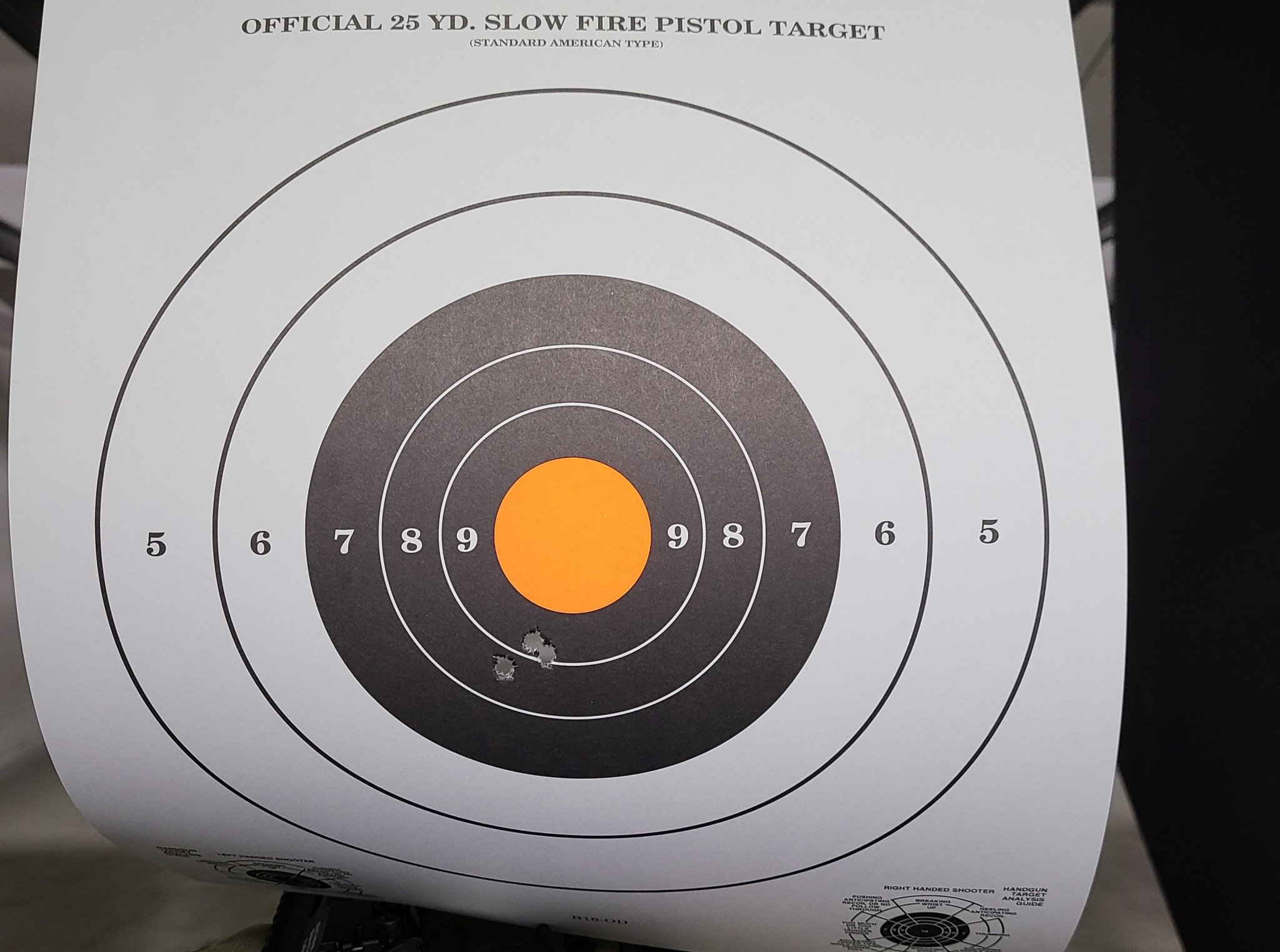

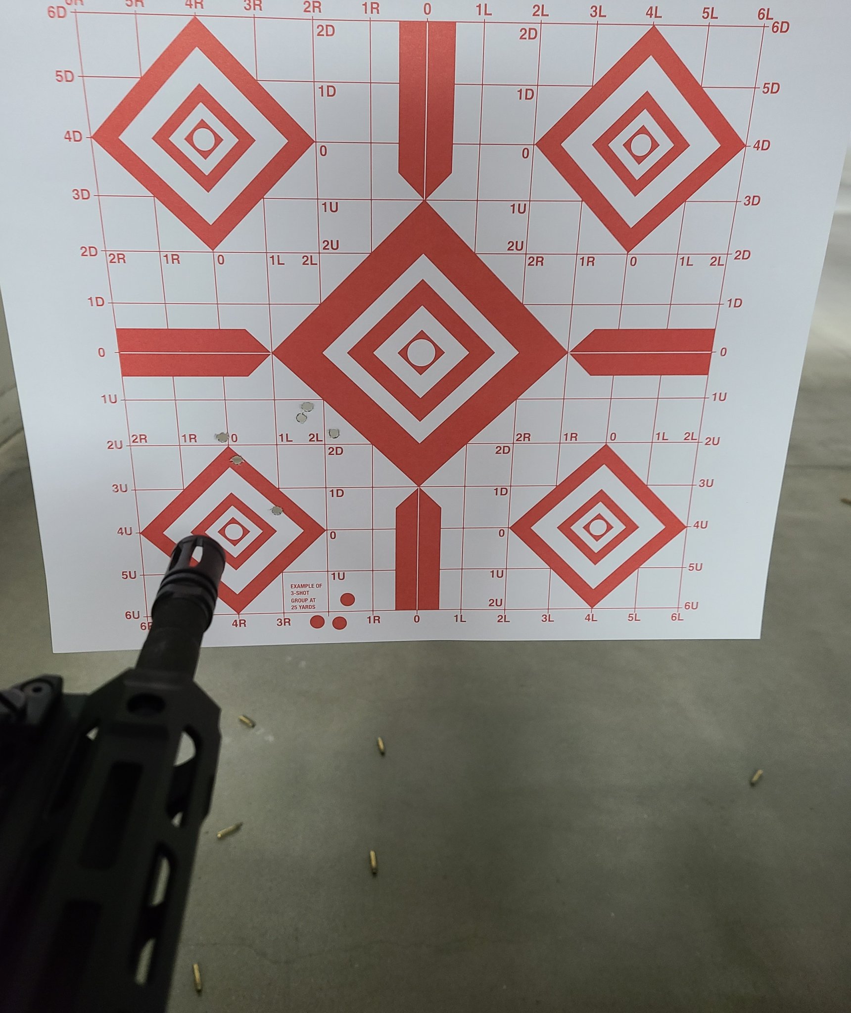

At this point I switched to a new target and continued shooting 3 shot groups. I felt like I had way too much windage dialed in, so I tried back it out and shot a couple groups. Sure enough, they went out further left. I continued shooting and adjusting, and ended up 1.25" left of center. However, the front sight was nearly maxed out on windage, and it took a few clicks on the rear sight as well.

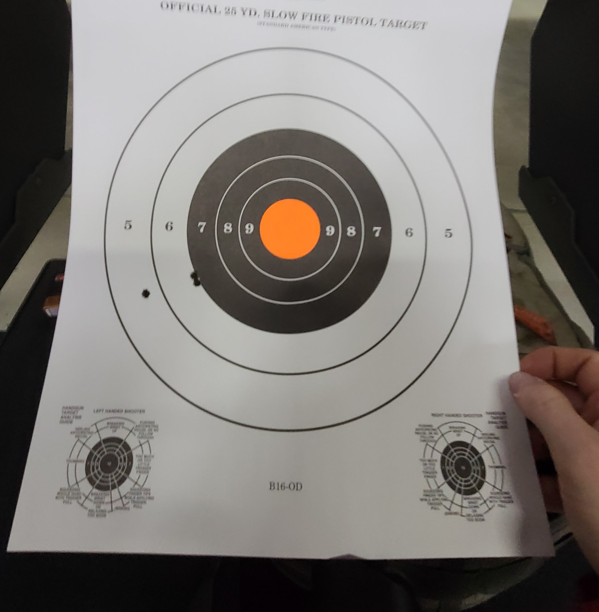

By this point my hour was up, so I packed up and went to ask one of the range/gunshop guys for advice. He took a look at the sight and was like "holy shit yea that's way too much windage, that can't be right at all." So, with my permission, he centered both the front and rear sights, gave me free range time and came to watch me shoot. The first group, 2 shots were left of center by 2.5" and I shanked the last shot to 4" left of center. I dialed a few clicks on the rear, came to roughly 2" left of center. I continued making larger adjustments on the rear sight and tuning things up with the front. For example, I might go 4 clicks rear, 2 clicks front, or 2 and 1.
Finally, I was able to get basically centered up on target. However, it still took a LOT (IMO) of adjustment in both the front and rear sight. All told, I put 60 rounds through the gun.

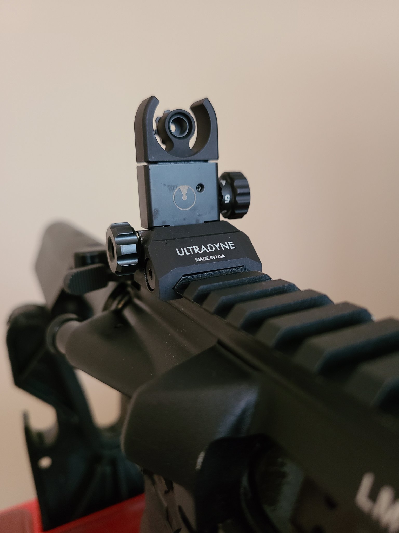

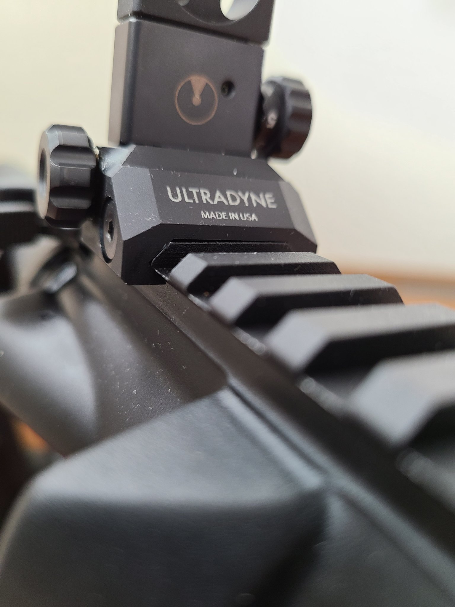

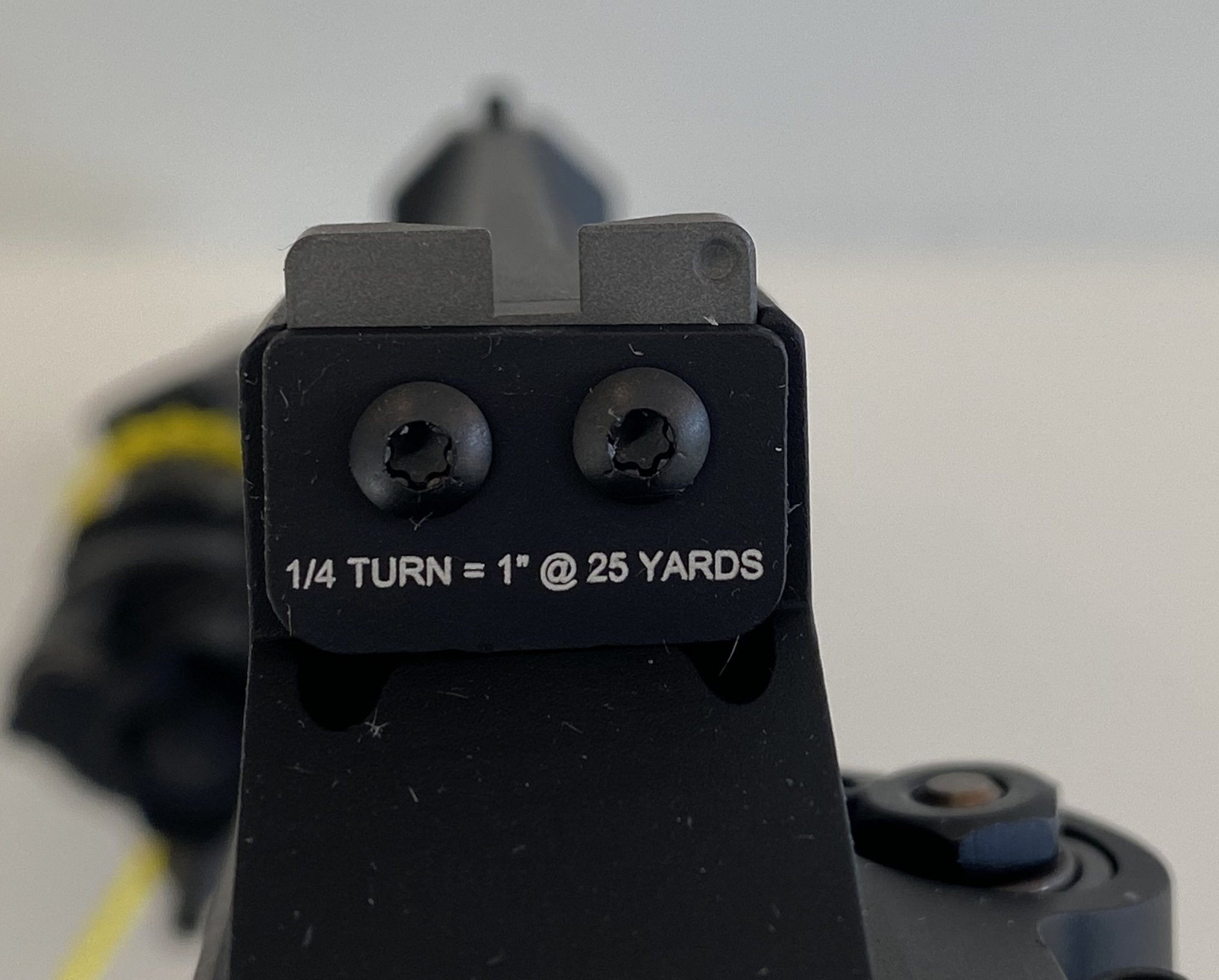

I have applied loctite to the picrail screw on the front and rear sights, and while checking the rear, noticed that the sight base does not sit flush on the rail, but is tilted left, as can be seen below:
I tried two other locations on the rail, and once tightened, all three locations showed the same issue. I tried mounting it several different times, being sure to keep the sight base centered and push down evenly on both sides, but once tightened, it always ends up like in the picture.
So, I assume either the sight base or the rail is out of spec. The front sight does not show the same issue, which leads me to believe it may be the rear sight base.

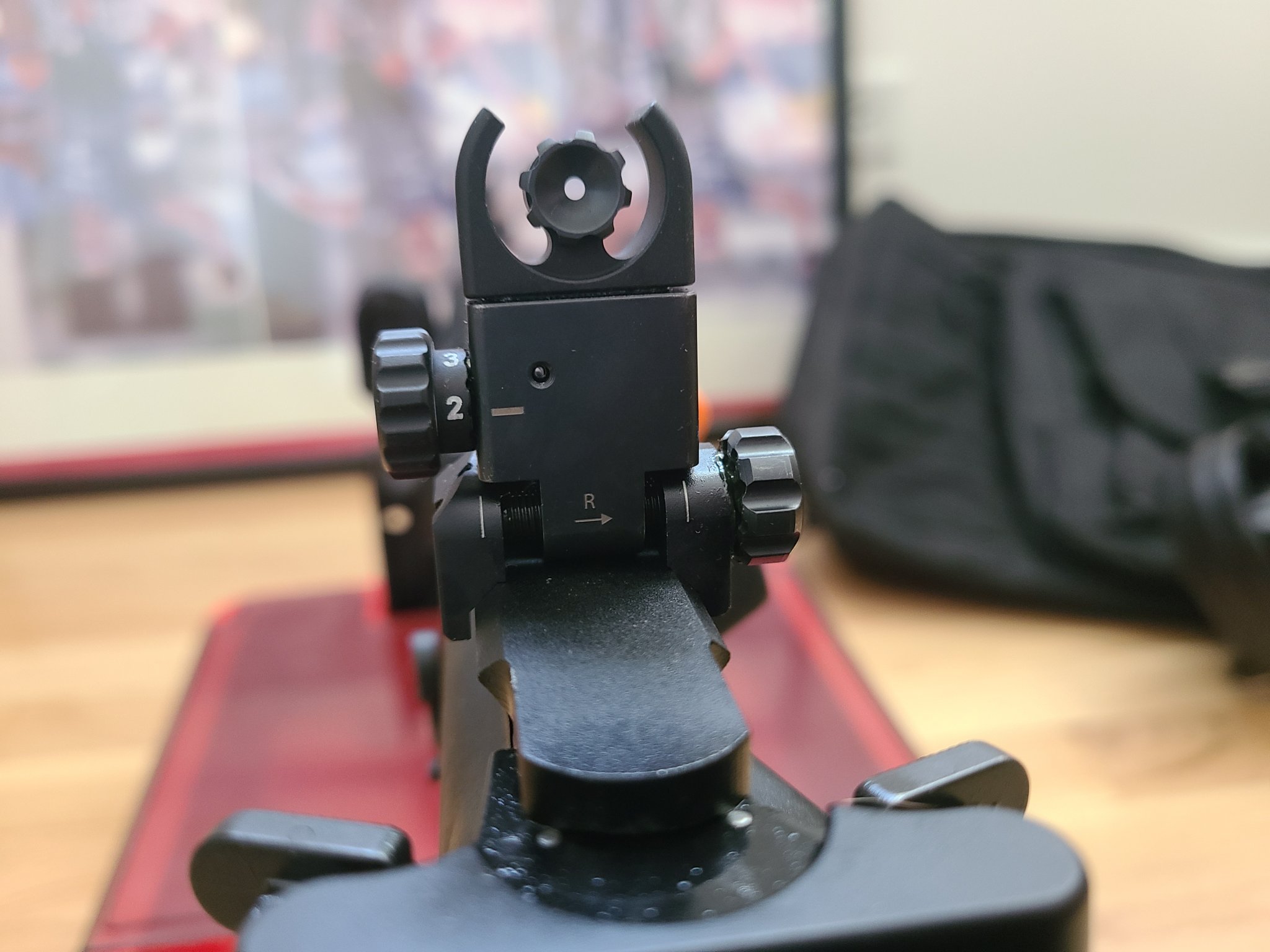

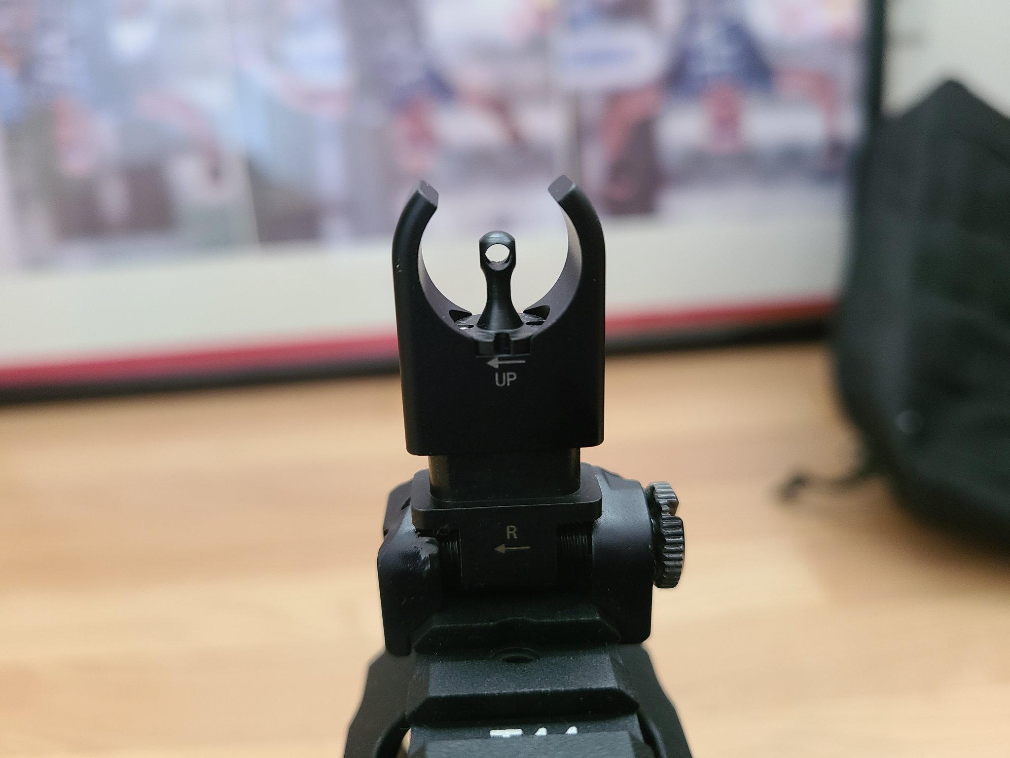

Move the front sight to the rear and vice versa. See if the rear looks crooked on the front. May be able to decide which part is out of spec like that.
I swapped the sights around, as @roostercogburn98 suggested, and the rear (now up front) still had some gap, whereas the front (now in the rear) did not. So, it looks like maybe it's the rear sight base.
I did try mounting the rear while it was folded down, as previously I did it while up, and for whatever reason, the gap seems to have closed up. Maybe I held it differently or pressed on it just right, but the gap seems to have closed up a bit, or just photographic tricks. I wish I could have found my feeler gauges to measure pre- and post-. I'll give it a shot again on Wednesday and see if there's any difference. Probably reach out to Ultradyne just in case.

Be sure to push firmly down and FORWARD back on each sight while tightening their fasteners.

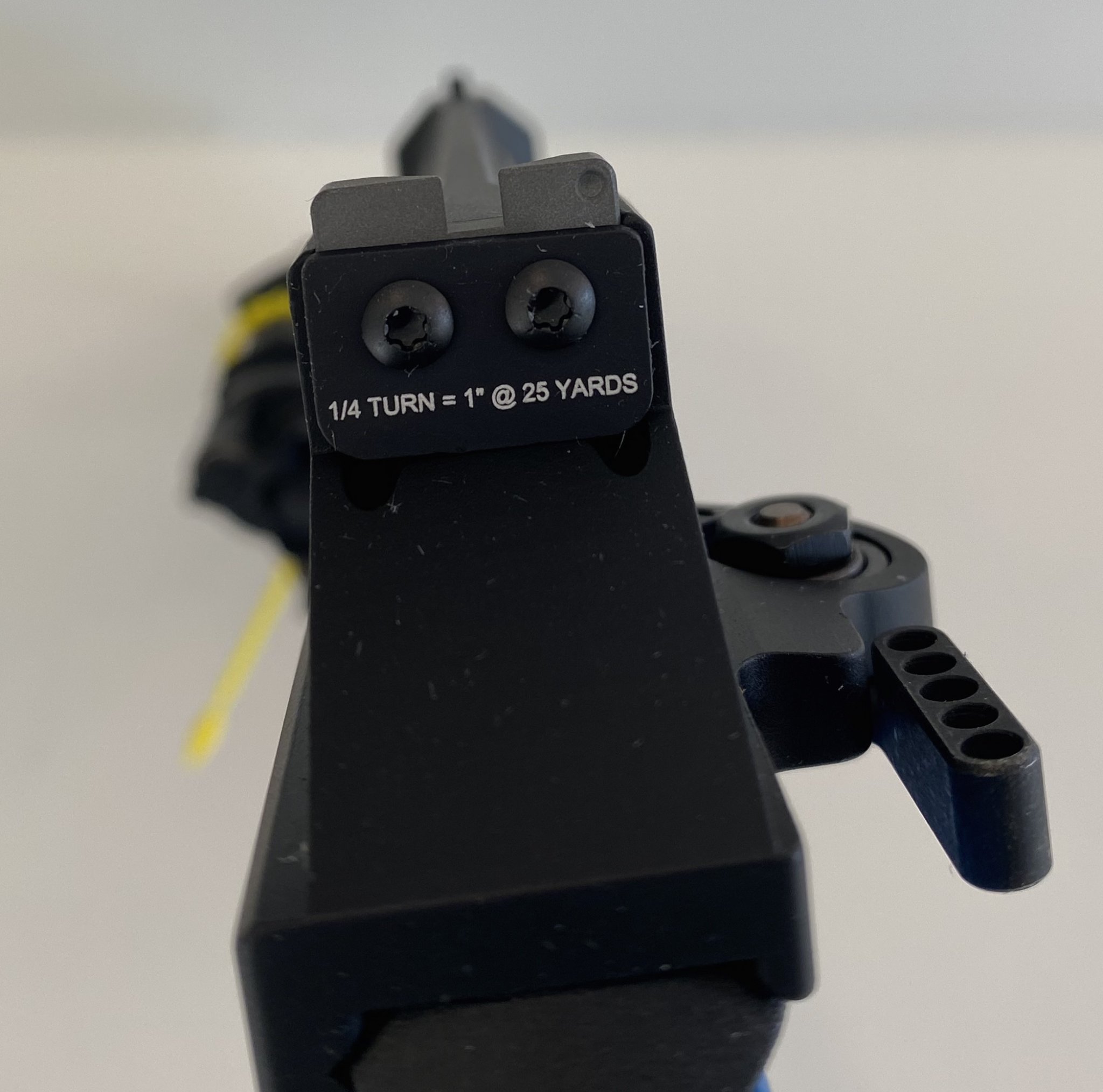

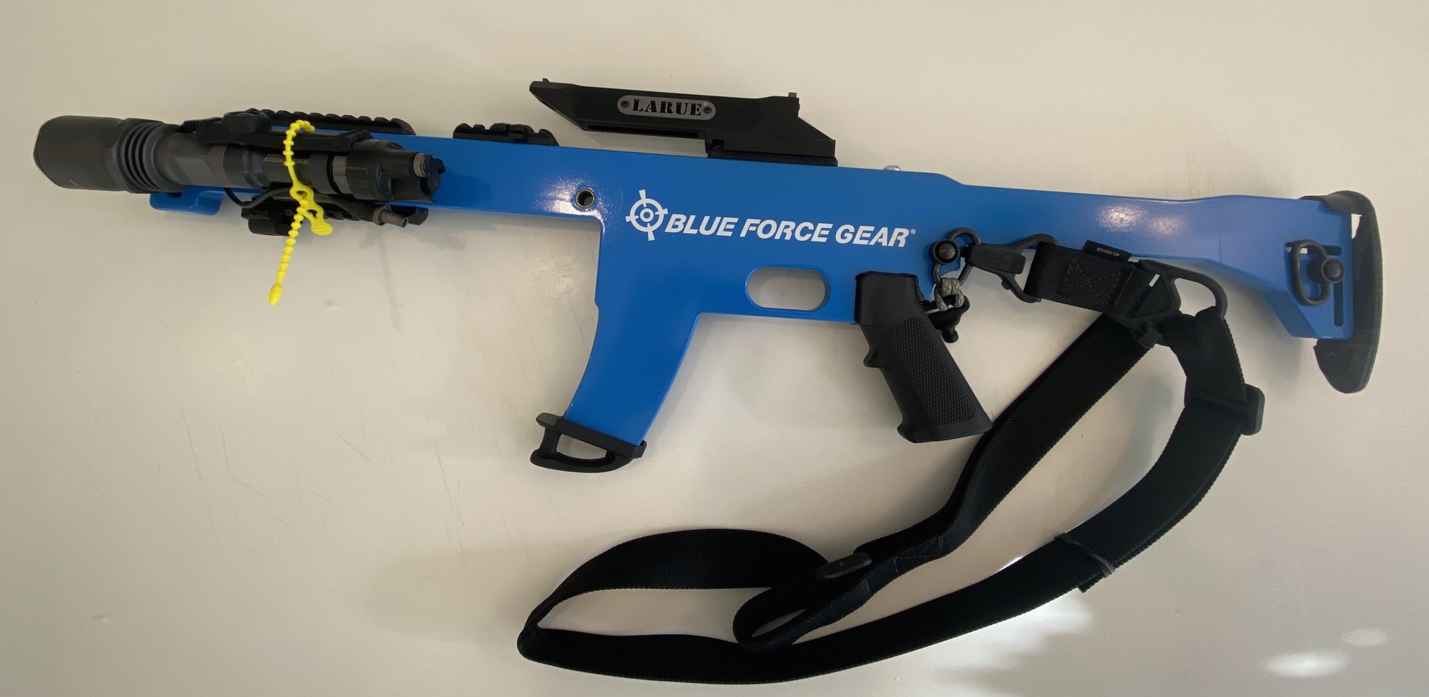

Since wandering impact for iron sights is the topic. I just got this LaRue C-Note QD rifle iron sight. Haven't decided what real platform I might use it on yet. But, it's unique. Anyone used one yet?

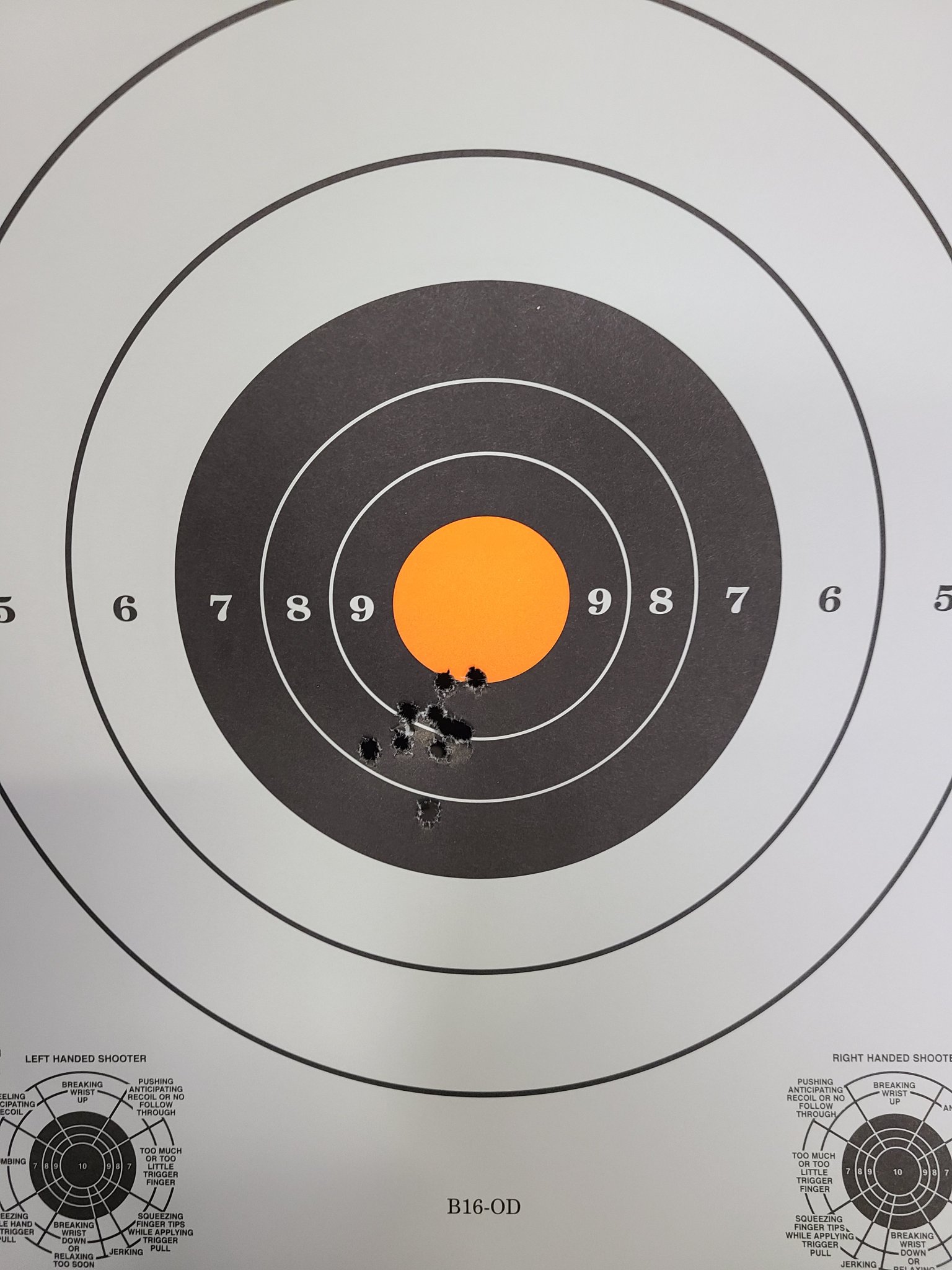

Well, I finally got back out to the range after re-mounting and Loctite'ing the sights. POI didn't really change, which was kind of neat, although I think there is more consistency in the groups, when I didn't shank one. I did NOT adjust the sights at all, so this is the same windage setup as last time.
There is another avenue I need to check up on as well, I checked the distance between the end of the rail and the barrel, using a dial caliper's depth gauge, and got an offset to the left of roughly 0.055". I would expect it to be perfectly centered, tbh. I've talked to LMT service and they are going to have me send in the upper for measurement, so we'll see where that leads. Initially I hesitated to say anything, so as not to air dirty laundry, but it's factual, and I'm not saying anything negative about LMT.
I shot the same PMC ammo as last time, with the same setup, to minimize variables. First target is the first 3 shot group, second target is 4x 3 shot groups. I pulled a couple and I know it. Shot 40 rounds total (on additional targets) since I had to pay for an hour on the range. I also picked up some M193 that I'll try next time.

You should reset your sights back to zero on both front and rear then track your shots. Also your sights at 25yards should hit 1.4” below center, as they are 200 yard sights. The sights are based on a 55grn @ 3200fps, so buy some match grade ammo for best results.
Looking at how your shots are very spread out, you need to work on the basic shooting fundamentals for an AR. If possible have someone record you while you are taking shots, you’ll be able to spot your errors.
