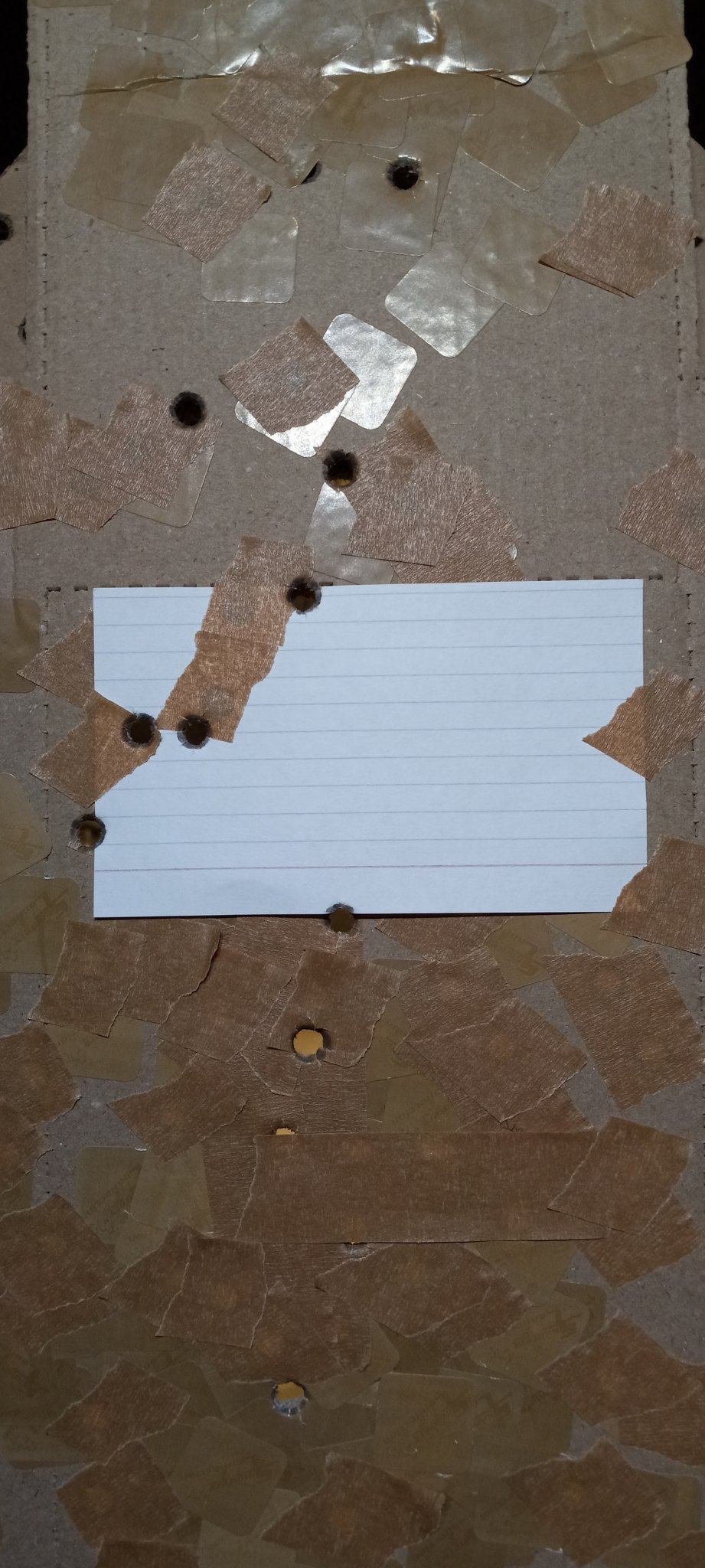

    Extremely accurate. Excellent upgrade to any P-10F. Primary Machine also makes them for the P-10C, P-07, and P-09.
    This is 10 rounds with the OEM barrel at 25 yards. This was shot freestyle (no support) at a practical shooting pace (firing immediately once the sights were in the acceptable area (the white index card) without delay.

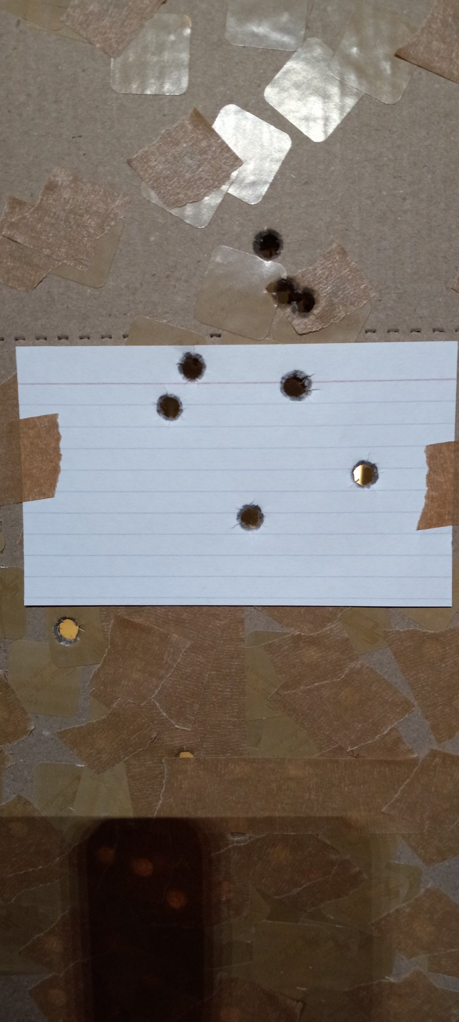

    This is the same number of rounds, shot at the same pace, at the same distance, using the same stance, through the same pistol, with the same ammo, except this time with the Primary Machine barrel. Seems like there are only nine holes, but there are ten. The top right hole in the card is actually a double, checked with my USPSA scoring overlay card.

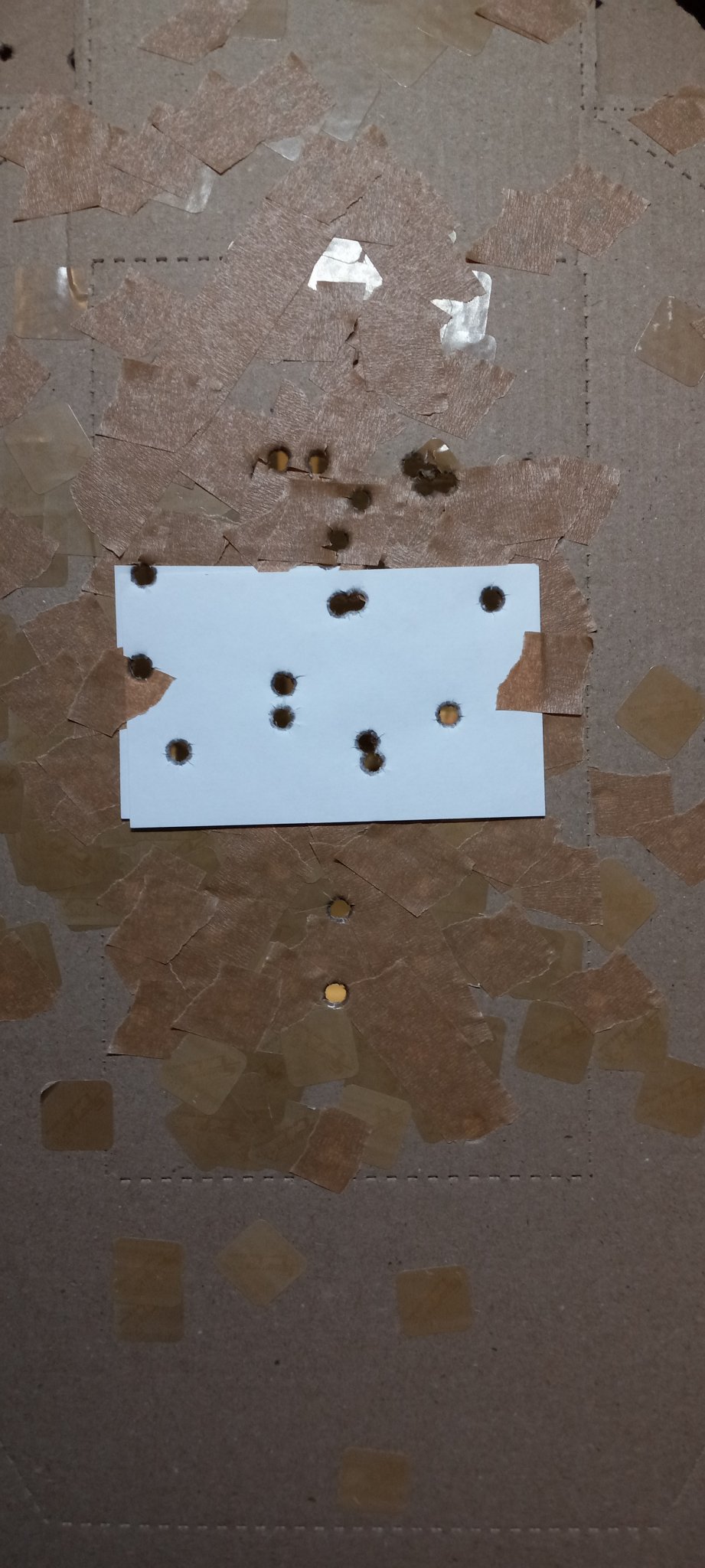

    This is ten sets of doubles at ten yards (one sight picture, two rounds) at around .20 - .22 splits with the Primary Machine barrel

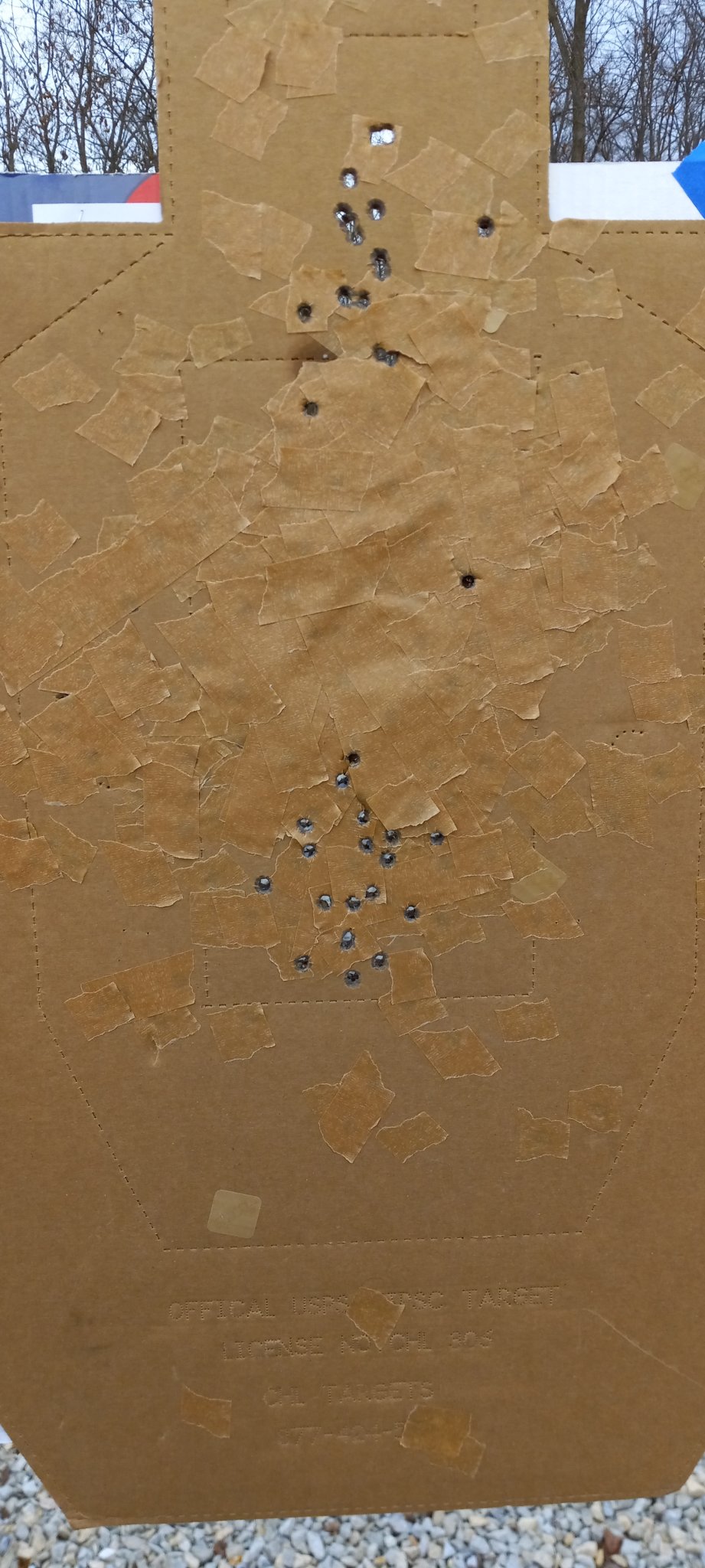

    I will say this, the barrel has some contribution to doubles being that tight, but it's pretty minor at 10 yards. This pic is two sets of ten doubles at 10 yards with the OEM barrel. Top group is with the OEM recoil spring, bottom group with the CGW 14 lb spring. Skill is about 90% of it.
    The one thing that is constant, regardless of the distance, is how this Primary Machine barrel cuts down significantly on vertical dispersion compared to the particular barrel that came with this pistol.
