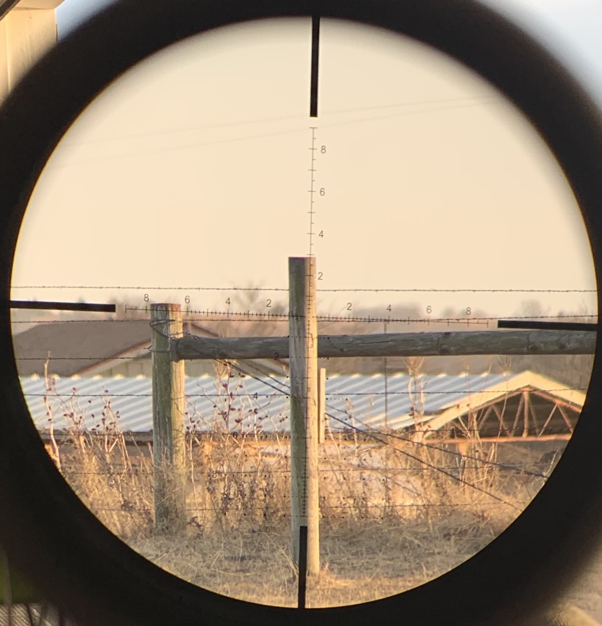

I’ve owned an Ares BTR and ETR and to me the glass is comparable to the BTR but the turrets are more like the ETR and maybe a bit better than what my ETR was. This is on 10-12x right at 100yds about 40 minutes before dusk.
Hope this helps.
