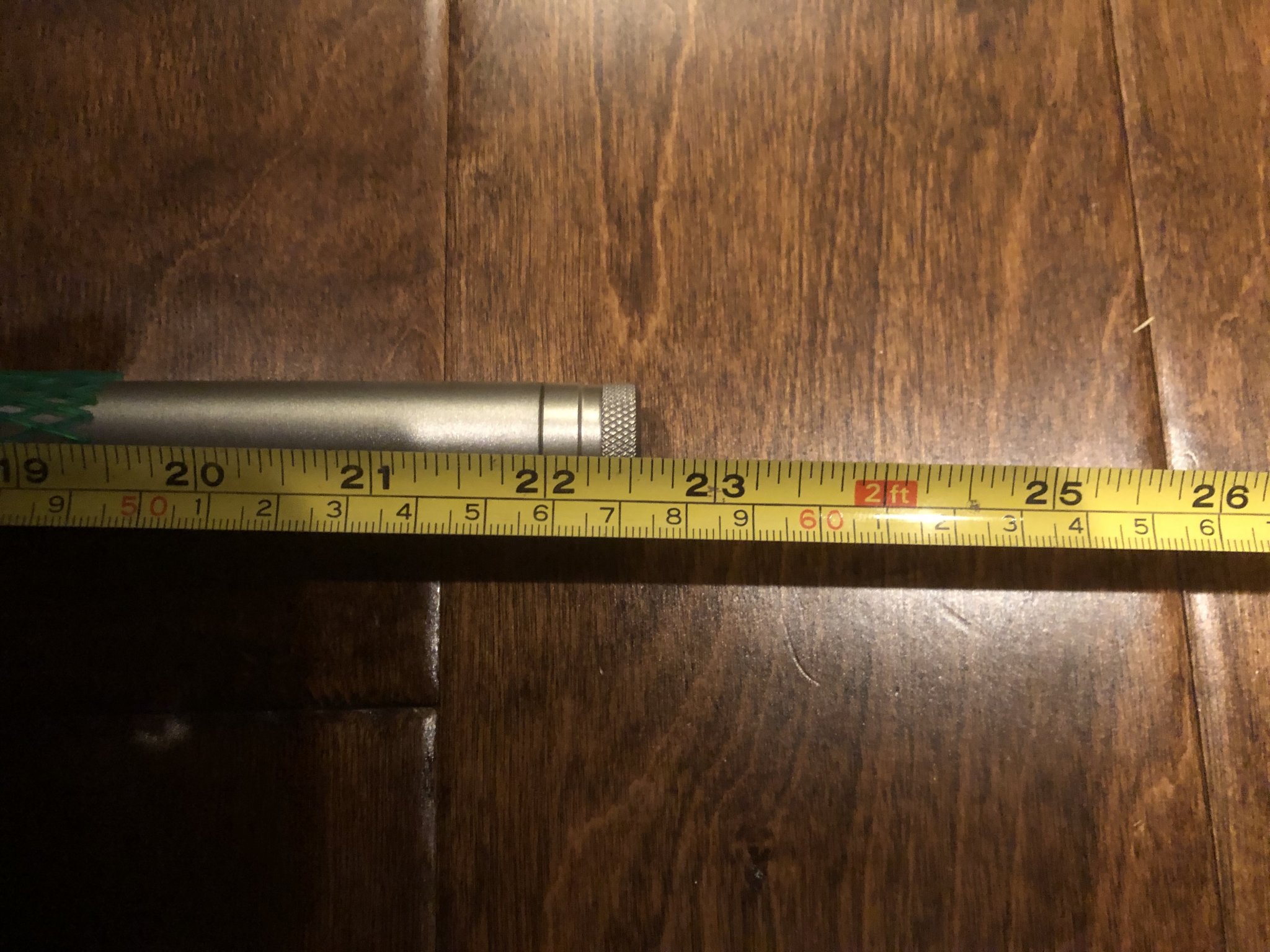

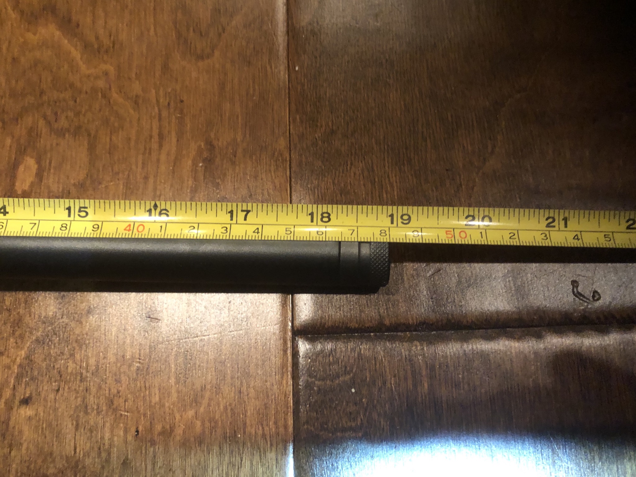

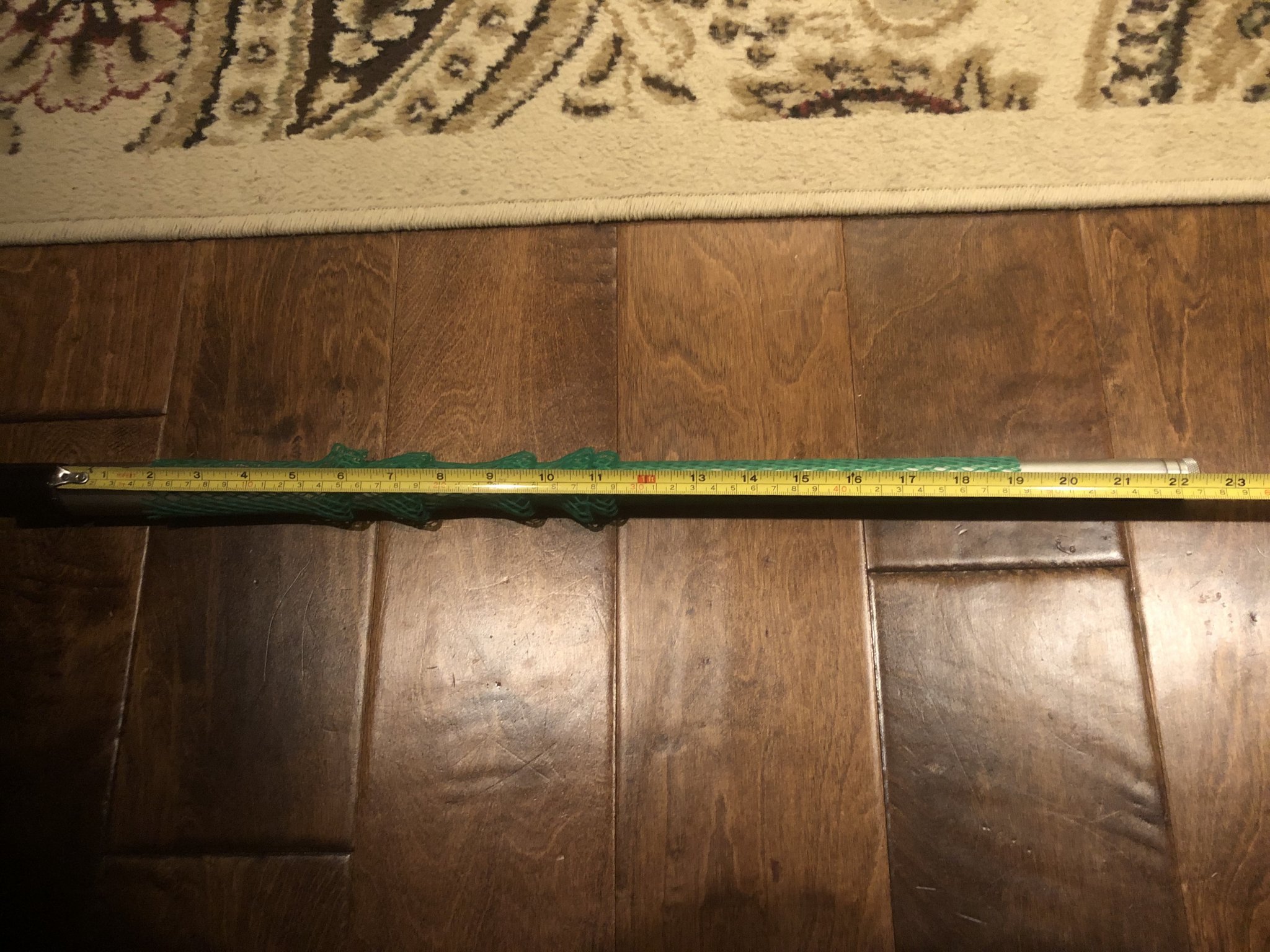

Could be a few things. My guess is you’re dealing with a mouth breather and he’s referring to the very common 20” CTR, but it might have a brake on it. That, or he’s measured thread tip to thread tip.
Reactions: SuperSneakySniper
Barrel length is typically measured from closed boltface to muzzle.
to answer your question:
22.5” from action face to muzzle.
20” tikka is 19” from action face to muzzle.
