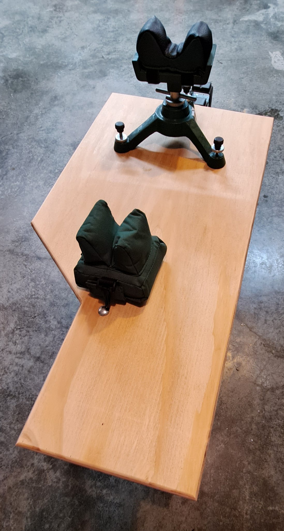

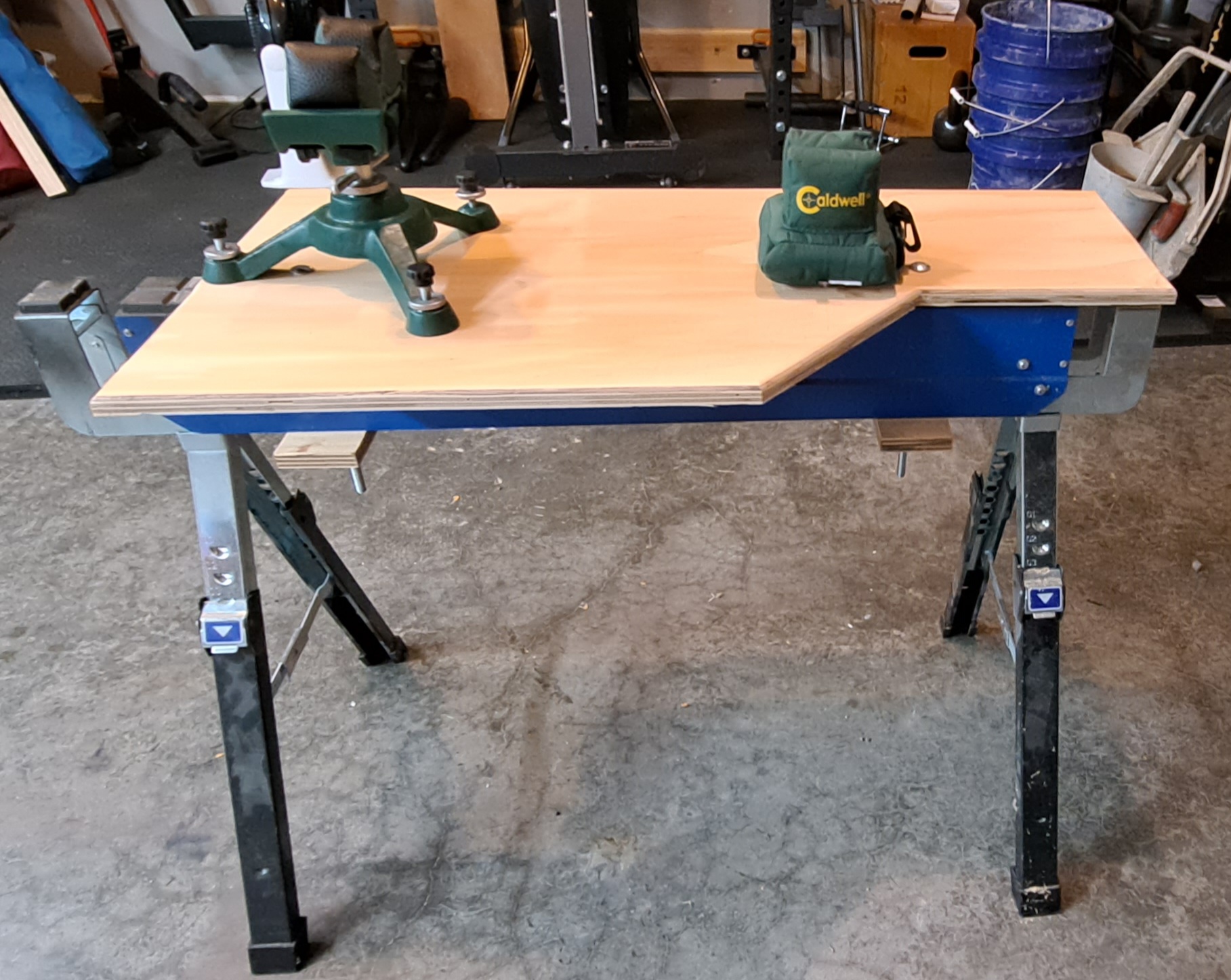

That said, the range I visit tends to get overrun by the AR guys about mid-morning, so I decided to whip together a portable bench I can take to my sister's farm and shoot without distraction (and out to 450 yds or so). After some web searching for ideas, I grabbed a 1/4 sheet of plywood and 2 carriage bolts......

I see more than a 1/4 sheet of plywood and 2 carriage bolts in that picture. Lets hear the rest of the parts and pieces.
2'x4' piece of 3/4" plywood
2 - 10" carriage bolts
2 - fender washers
2 - nuts
I already has the sawhorse, but a similar model can be found at either Lowe's or Home Depot. I just drilled two holes for the bolts, and used a couple scraps from the plywood to make "washers" to hold everything snug. Plywood ran about $25 bucks, and the bolts about $5.
I just looked online, and a similar sawhorse goes for about $50.
