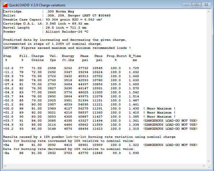

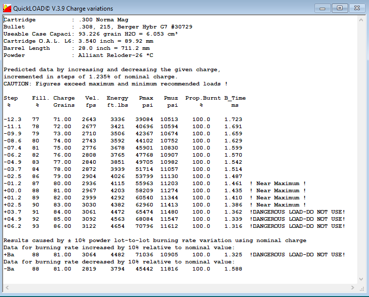

    Hey if someone could run quickload for me with300 Norma, a 215 primer, reloader 26 and 208-215 bergers that would be greatly appreciated.
    I might be able to run it later today if no one else gets to it. Would also need COAL, barrel length, and ideally (but not mandatory) actual case capacity.
    Here's for Berger 208 ... then 215. Gave you 1gn increments so you'd get the best sense of the range.

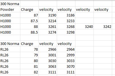

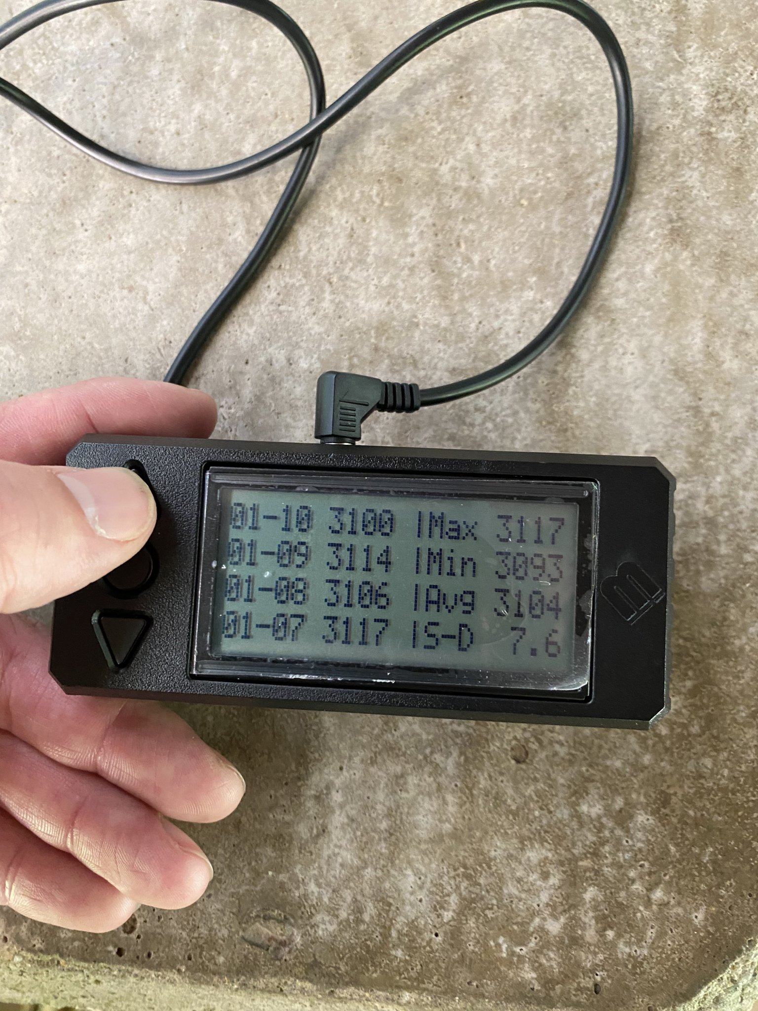

    @rustyinbend I loaded up some rounds with 208 bergers federal match primers and here is what I got, no signs of pressure but jesus....

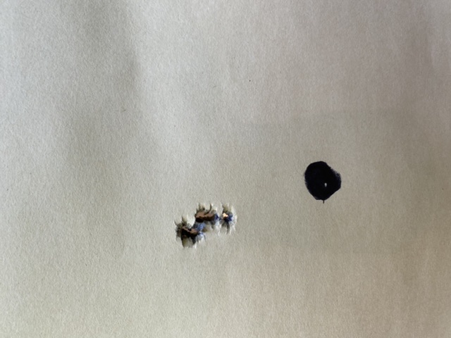

    Was looking for pressure signs and never got any. I'm happy with the consistency of RL26 while H1000 had some velocity spread that I cant explain due to small sample size. I'm going to go back and load ten of each RL26 at 82 and H1000 at 88 and see what my ten round group at 300 looks like.
