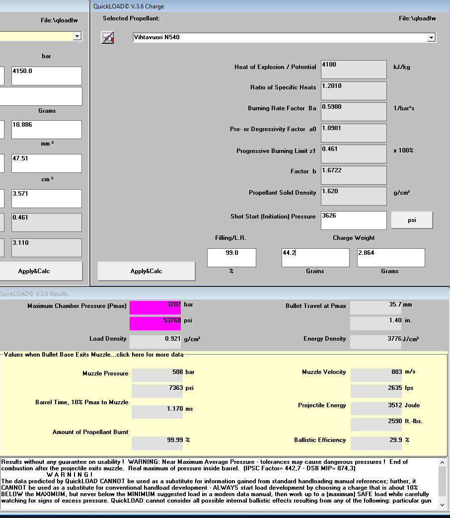

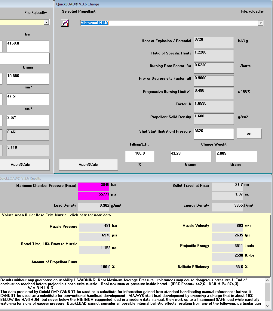

Why is BE so different when N140 vs N540 and getting the same fps
I can see there are some minor differences in different areas, but which areas are effecting the Ballistic Efficiency that much?
I guess I'm not sure what you consider the same, the burn numbers above your charge weight are quite different. Search QL for a powder with closer numbers to 140 and run your test.
