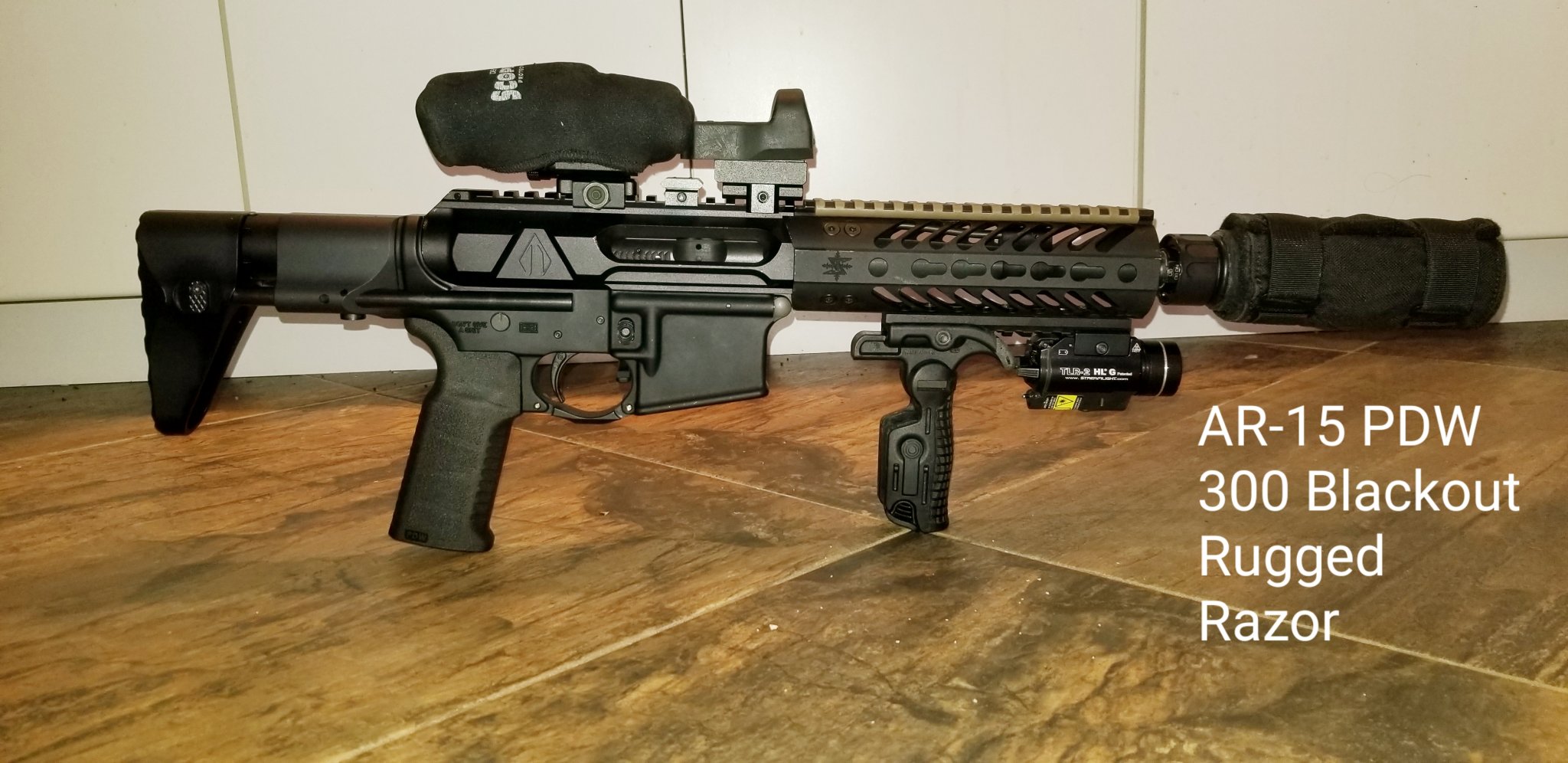

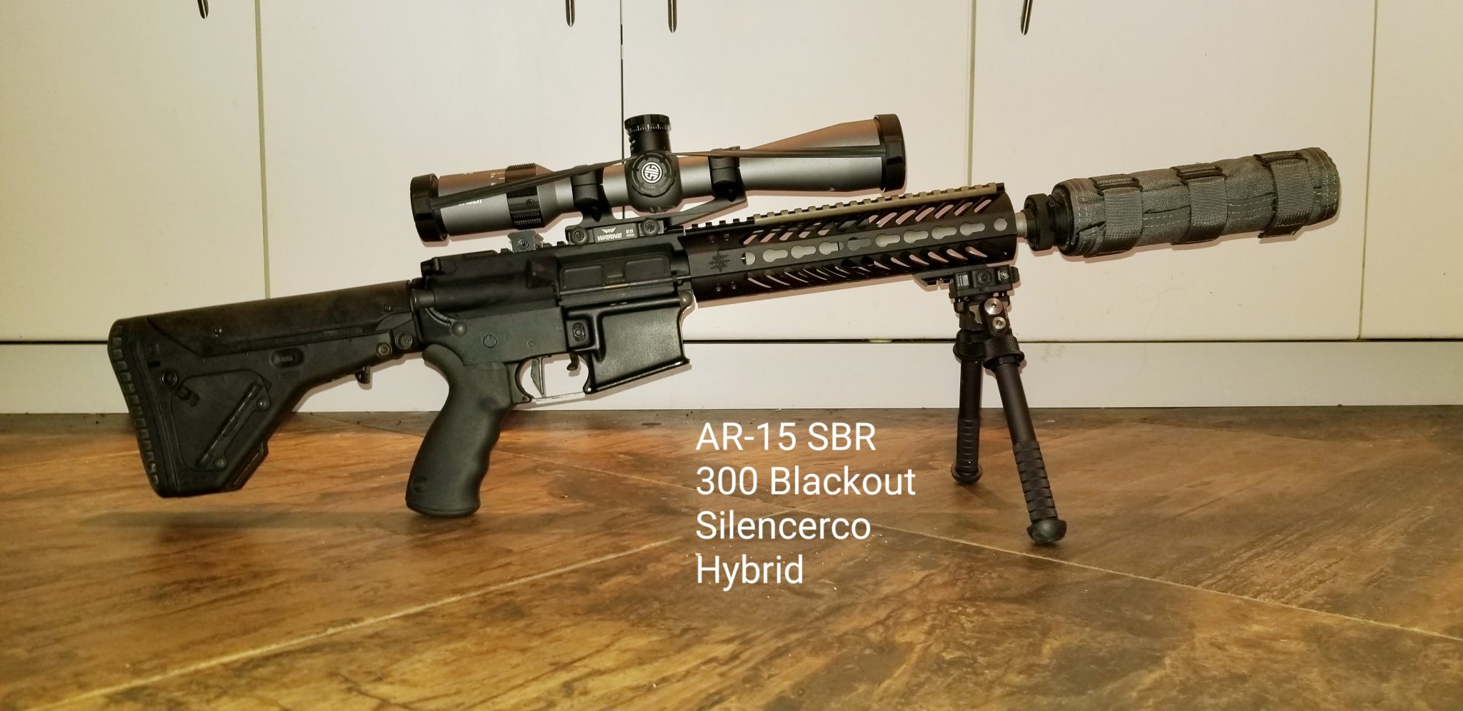

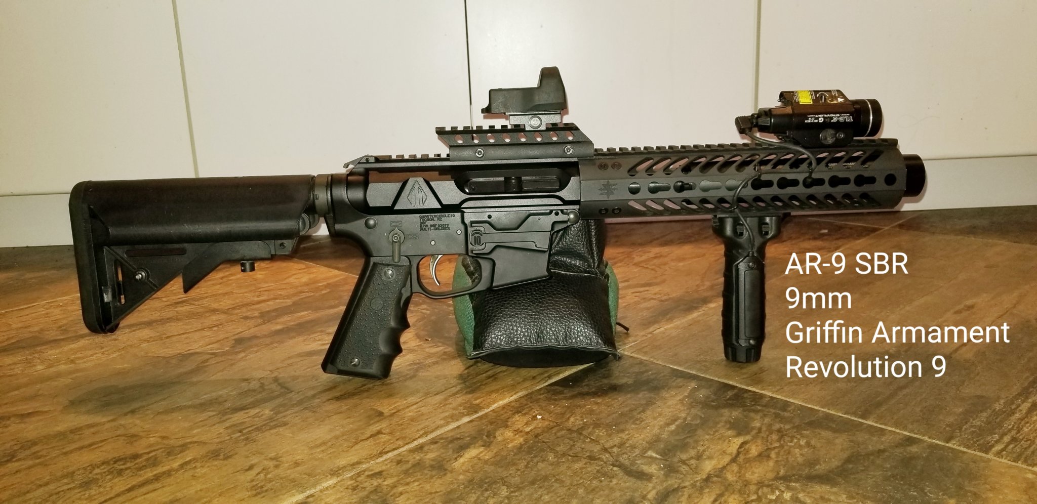

    I have a 10.5" and a 16" that both are suppressed, as well as a 9" 300BLK. It all depends on what you are after and at what distance. The crack of the bullet in flight is around 140 DB (for .223) so once you pull that trigger the neighbors will definitely still hear. It will just be less annoying than 160-170 DB booms going off from pure muzzle blasts.

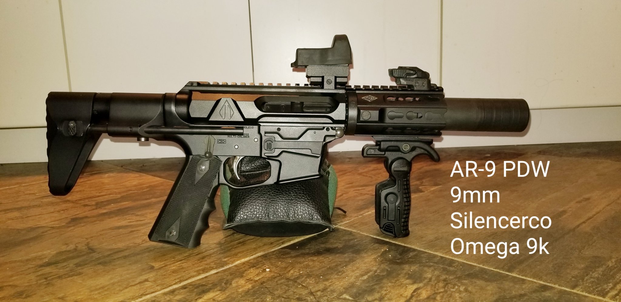

    I’d look at a 300blk with subsonic rounds. You can always go supersonic with it, too, if you need more range or oomph.
    I have a 16”, 9” and 6” and they are a hoot with my 762-SDN-6 or Omega on the end.

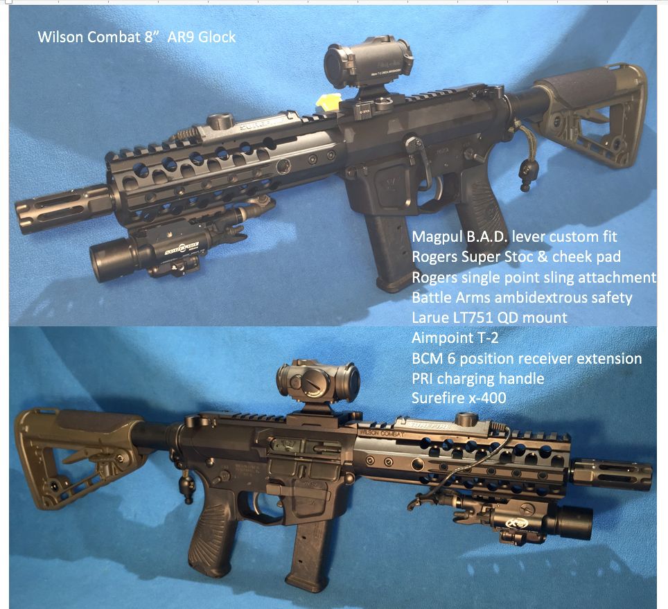

    It's already been mentioned several times, commit to a end-use purpose then select the platform.

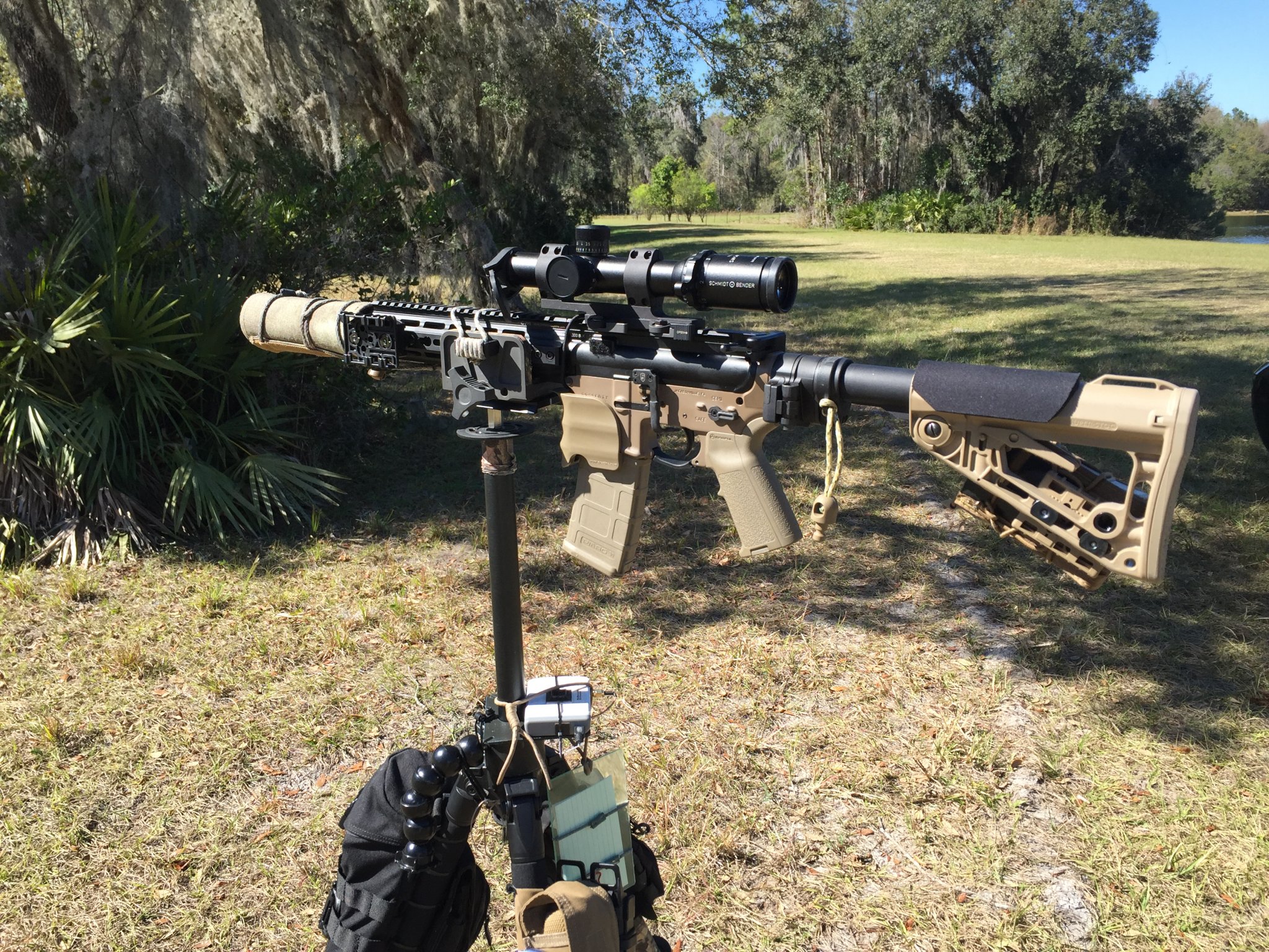

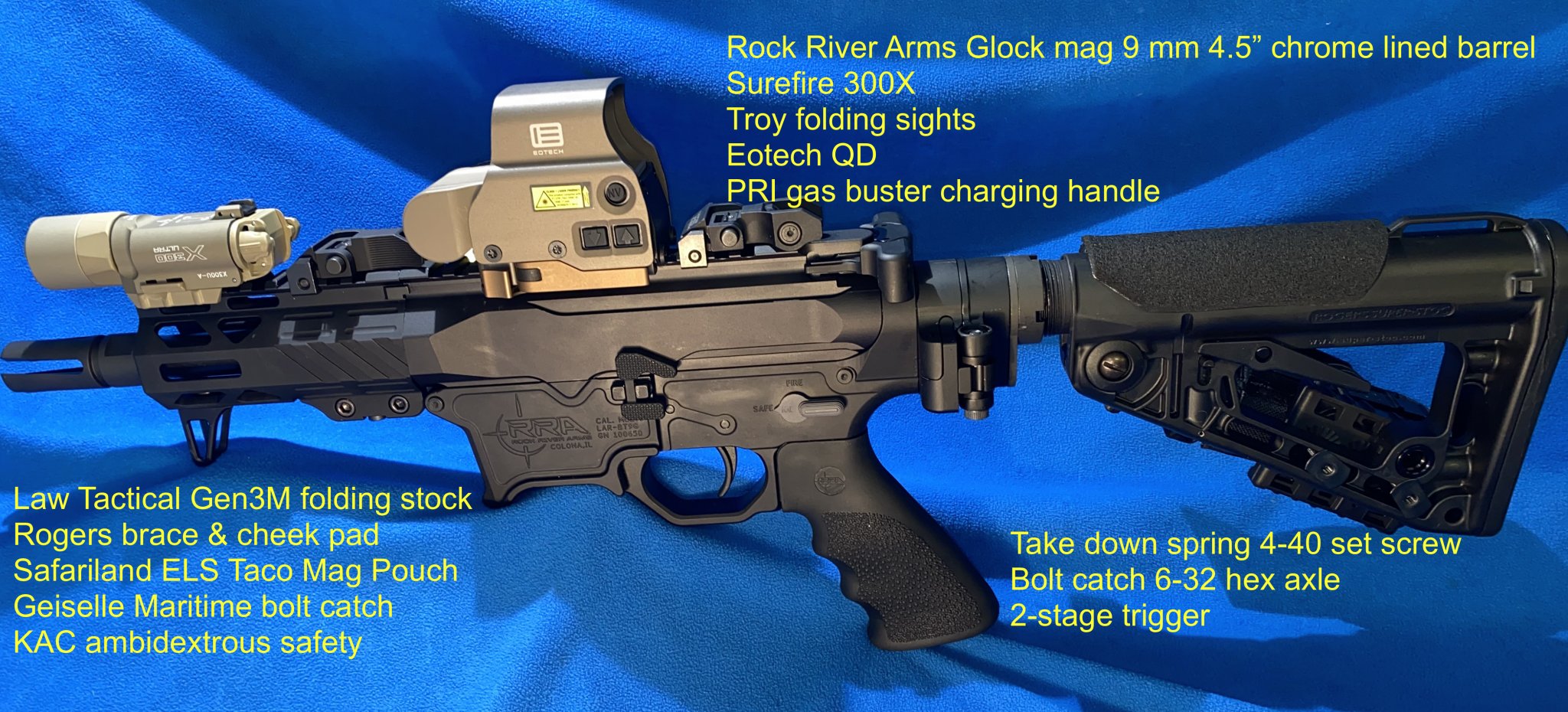

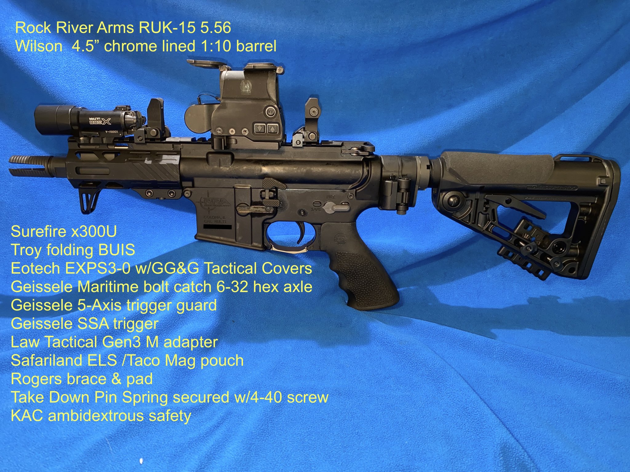

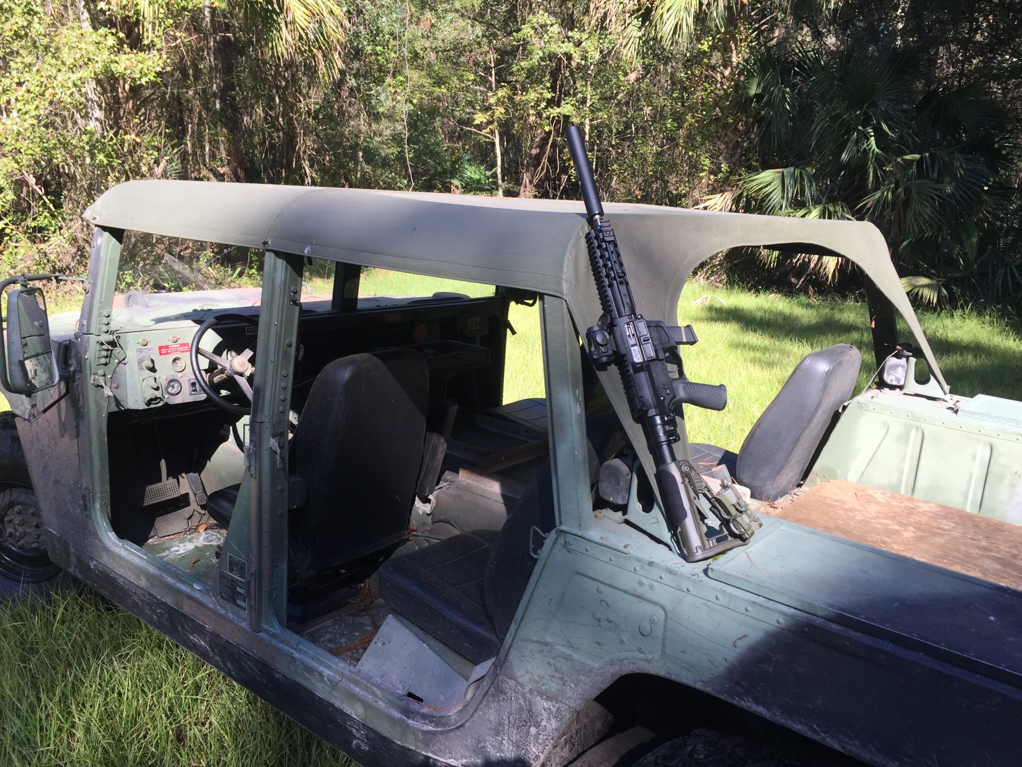

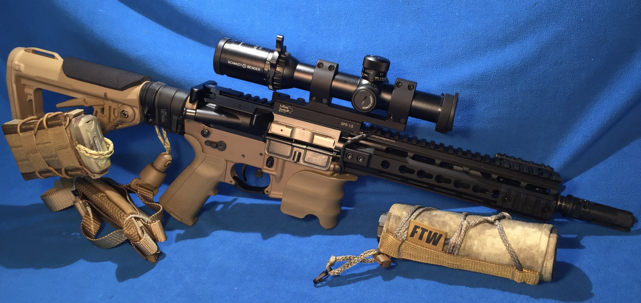

    A few of the various AR receiver styles, 9mm; .300BO; 5.56.
    The 9mm round is generally right at the speed of sound out of a common pistol, suppressed its pretty quiet. A Wilson Combat 7" Glock-based and Rock River Arms 4.5" shown, suppressed mostly bolt cycling noise heard.

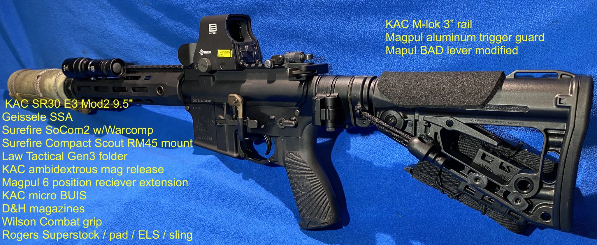

    My short .300 BO using suppressed rounds, all I hear is the bolt cycle!
    Even really short 5.56 is going to have supersonic muzzle velocities; the 4.5" has ~ 1900 fps using Black Hills 50 gr. TSX specific for the caliber short barrel. My FN 5.7 pistol 4.5" barrel has a 2250 fps muzzle velocity.
    A FDE Primary Weapons System (piston) and KAC shown.
    16" HK 5.56 and Rock River Arms 4.5" shown. The 16" has a 3,000+ fps muzzle velocity, hard to suppress, the sound "crack" is softened.
    It's hard to beat at suppressed SBR .300 BO, which would be my choice of the three calibers, generally accepted to be effective against 2 & 4-legged varmints.
    Folding stocks are the bomb.

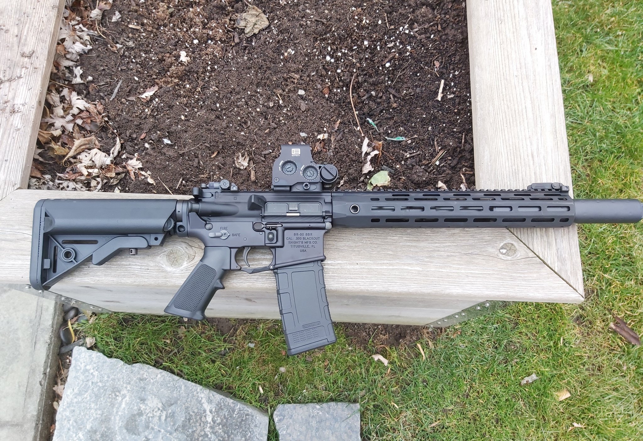

    I have several, but the quietest is my 16” 300 blackout with a Wilson Combat Whisper suppressor. It’s one of my favorite to shoot as well.

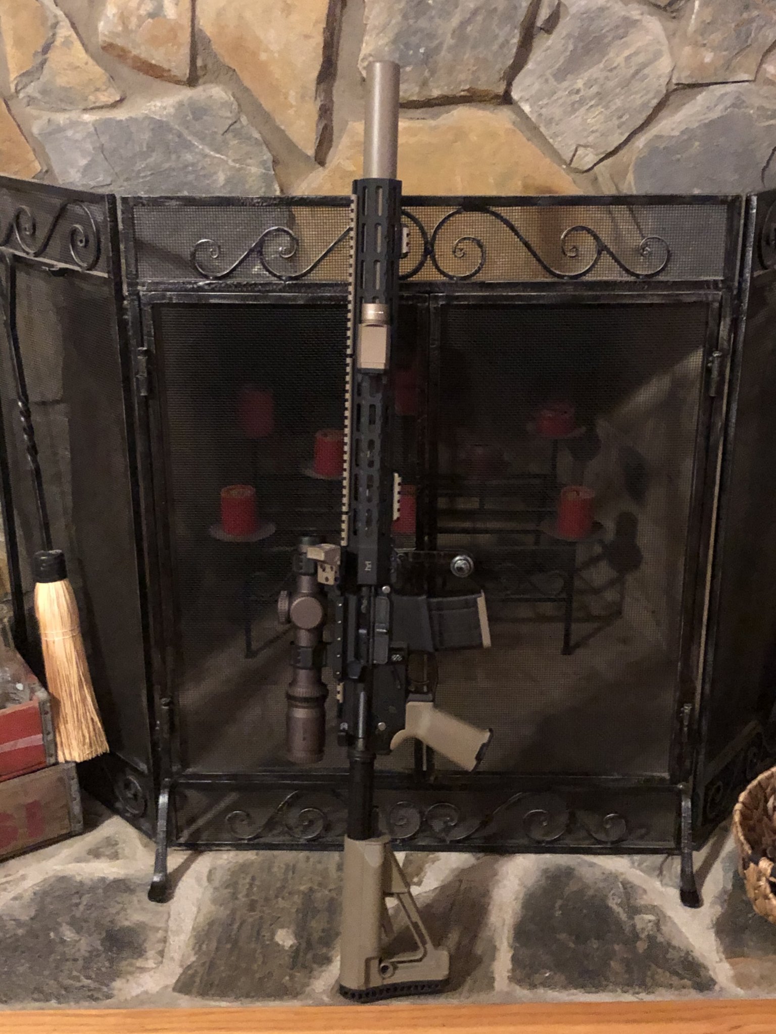

    If you want movie quiet, 22LR bolt action
    Then a bolt 300BO.

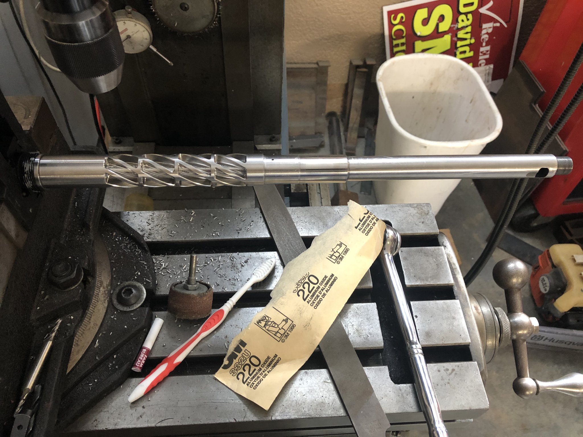

    AR suppressed, 300 BO shooting subs

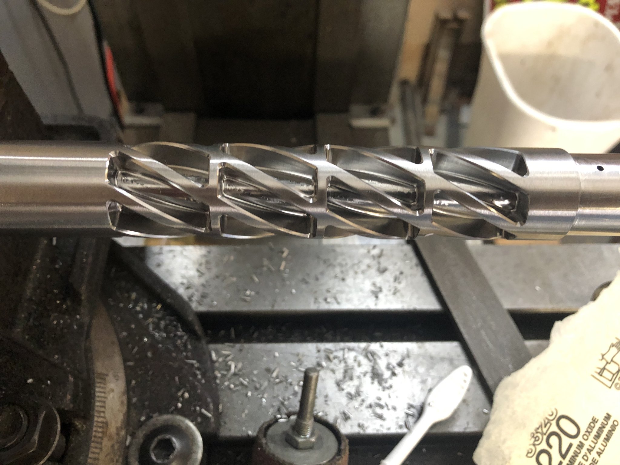

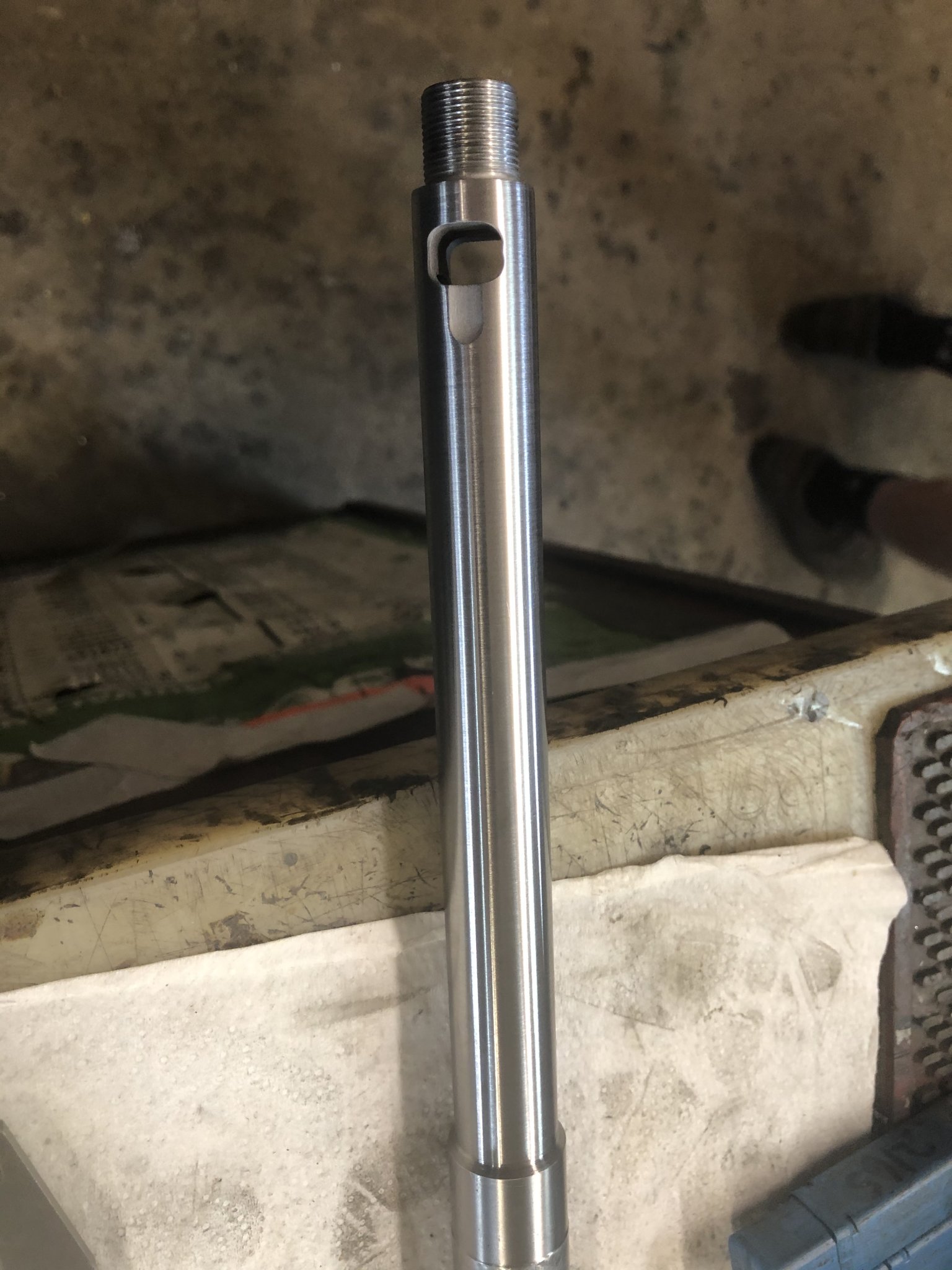

    AR 556 suppressed is more for hearing protection and noise reduction. You’ve gotta adjust your expectations. All the ARs will have the port noise, no getting over it. I just got through building my last AR with a reflex style OTB Can with a break and SLP adjustable gas block and JP captured recoil buffer. I need to work on adjusting the gas system a little more, but it’s very quiet for a supersonic 556. Not playing with subsonic loads on this one. Can goes over barrel almost back to the gas block.
    Barrel has just a little bit of machine time on it, with LRI finishing it off with
    The x-pattern fluting to drop a bit of weight.

    The 9mm builds are harder to tune quiet, but get there. I have 2, one with a SiCo Omega9k for tiny and one with a SiCo Octane9. Mine are blowback. But since I built mine CMMG and others have created delay blow back uppers closer to HK MP-5 performance. The HK delay roller lockback is the quietest semi 9mm I know of. The 147 HST is very good, but I have to give the win to the 300BO subs with a good can.
    I have one 300BO that is tiny, uses a Rugged Razor and is hearing safe, but louder than some of my 5.56 builds even with subs. An adj gas block helps and you need a big can. A 9" can meters around 120db, less than 7" can is over 130db. That is a huge difference.
