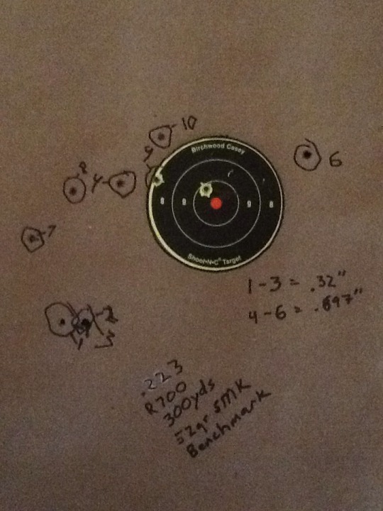

Range Report R700 223 52gr SMK Ladder tests. Help?
Sorry. How bout this?
Ryan
  • 980A745F-7CFE-45CC-A10F-B849107FE957-1713-000001A3066BFBA4_zps6800cdf2.jpg
Not ladder test but some interesting info on the 52 gn SMKs.
The Army used a Mann devise to test their ammo. For 5.56 its a heavy barrel (the one I got from the CMP is a KART) on a Remington 700 action. To test the devise they use 52 SMK's in Remington cases, pushed by 25 grns of 3031 and get groups between .18 - .20.
I tried that load in my Mann devise and it does seem to work.
No. My next step is 5 shot groups with the specified loads stareing in the middle. I dont know if its right or not but hell. Whats the worst? I have to shoot more?
Ryan
Yep, sorry. I'm the tard here. I did quite a bit of reading on ladder testing after I posted on this thread.
Your theory looks sound from what I've read. Are you going to try the same ladder again to verify your results?
