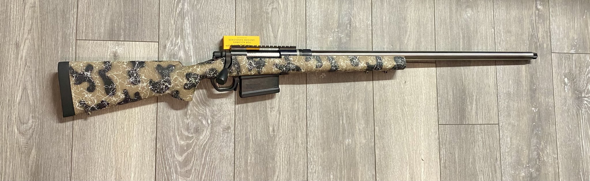

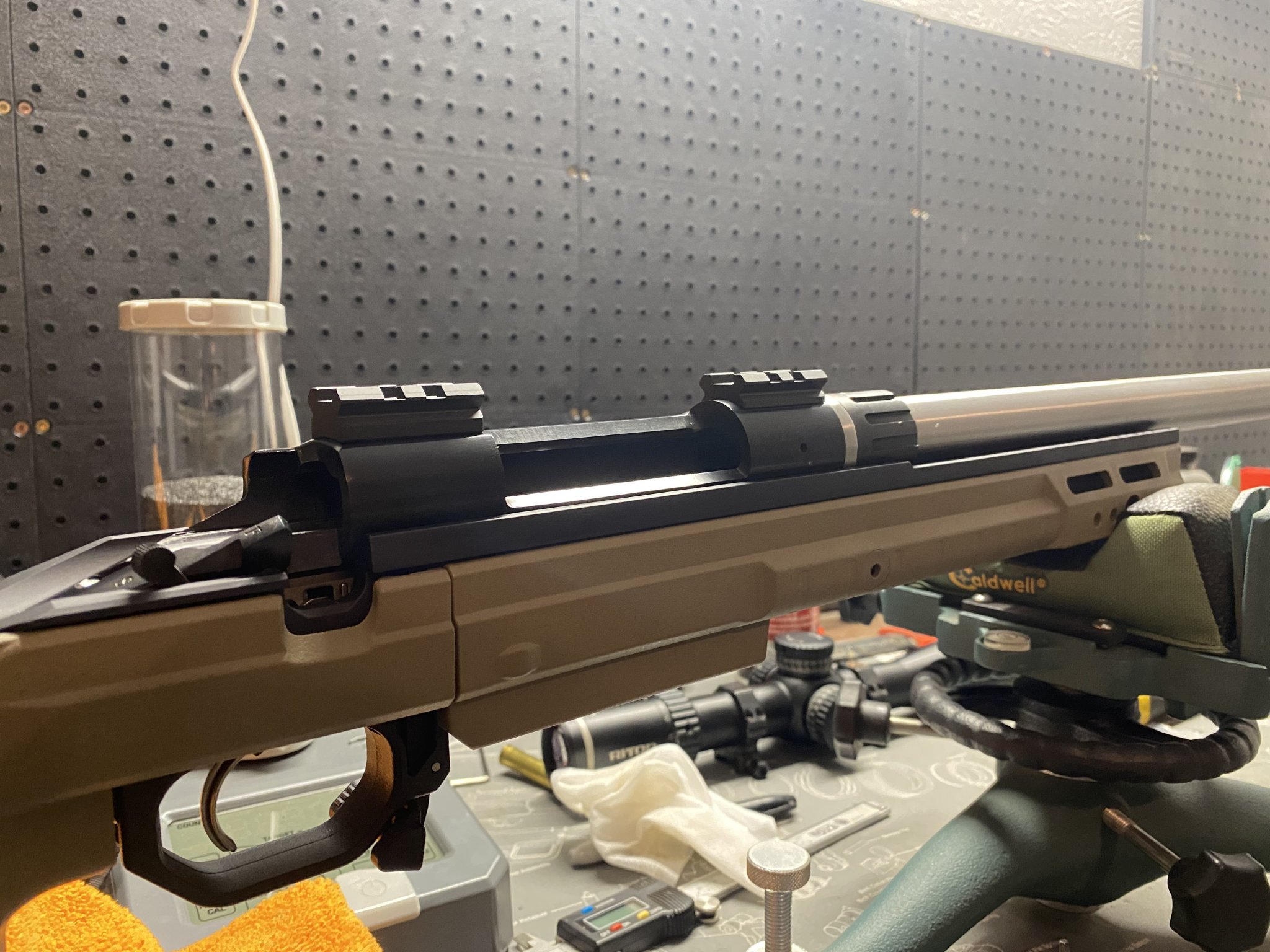

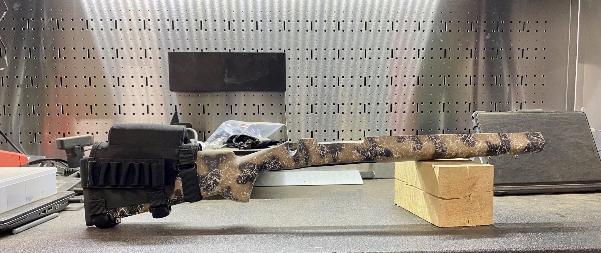

Ordered a 300 PRC Mcgowen 28” 1:8 twist Mcgowen #8 contour threaded barrel. Hopefully it will be in by this fall. Here’s the stock I will be using H&S bedded stock. All I need is a detachable mag kit. The H&S ones are on back order.

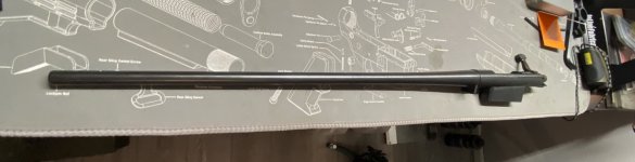

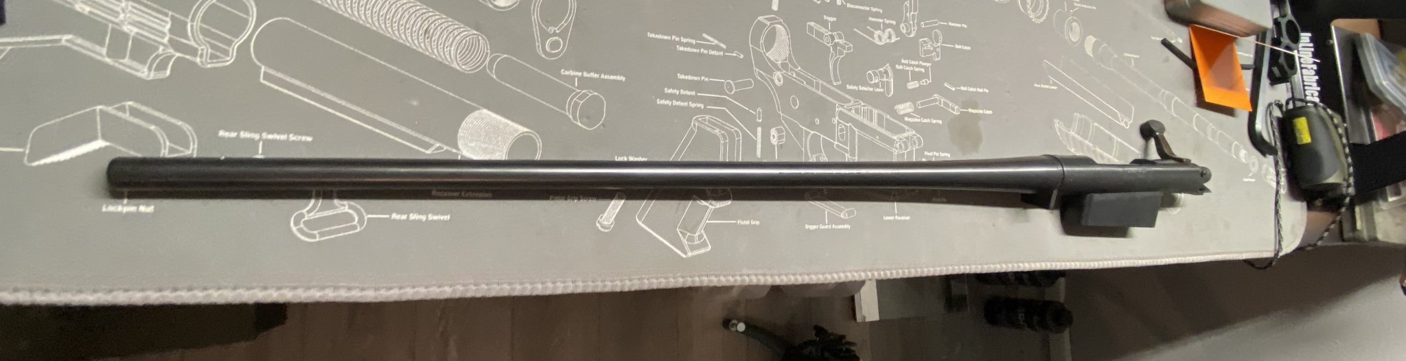

I have seen a few way to remove the factory barrel. What’s the best way, I don’t need to save the recoil lug or barrel. I have a external action wrench and can put the barrel in a vise.
Reactions: pabrousseau
You put the barrel in the vice and the action in the wrench and turn it off.
I put a 6’ pipe as a breaker bar over the action wrench handle and it never takes that much physical effort. Just make sure everything is tight so it doesn’t shift.

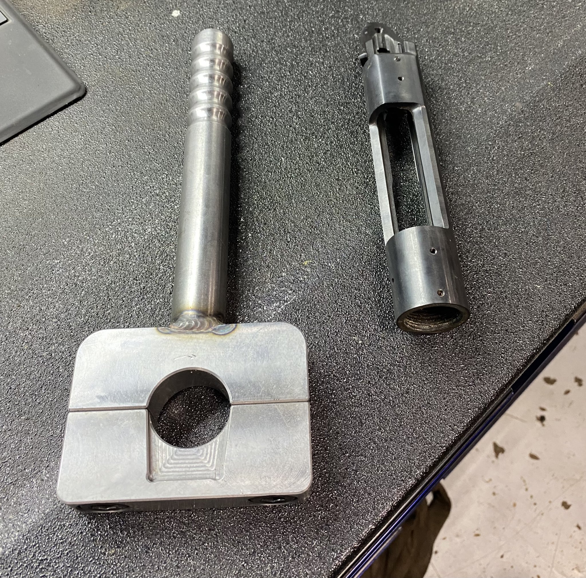

I had an old 700 ADL in a 7mag I’m re barreling to 300 Prc as well. I trued up the action yesterday and finished sleeving the bolt today. I still need to cut it for the Wyatt’s box. The old barrel was a bitch to get off of this one, it was corroded up pretty good on the threads. I am going with a 1:8 Kreiger at 24” on this one. It will also have the first AG Composites stock I have used if it would show up. Two weeks late already.

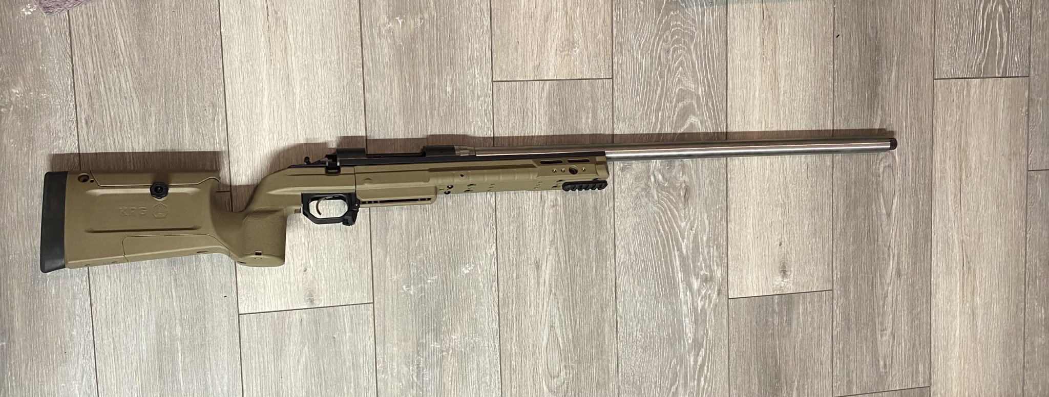

Since I’m waiting on the 300 PRC, I decided to get a standard long action bolt and use my 28” 308 barrel for the time being. This is a Magpul bottom metal, it didn’t need any modifications which I was surprised.

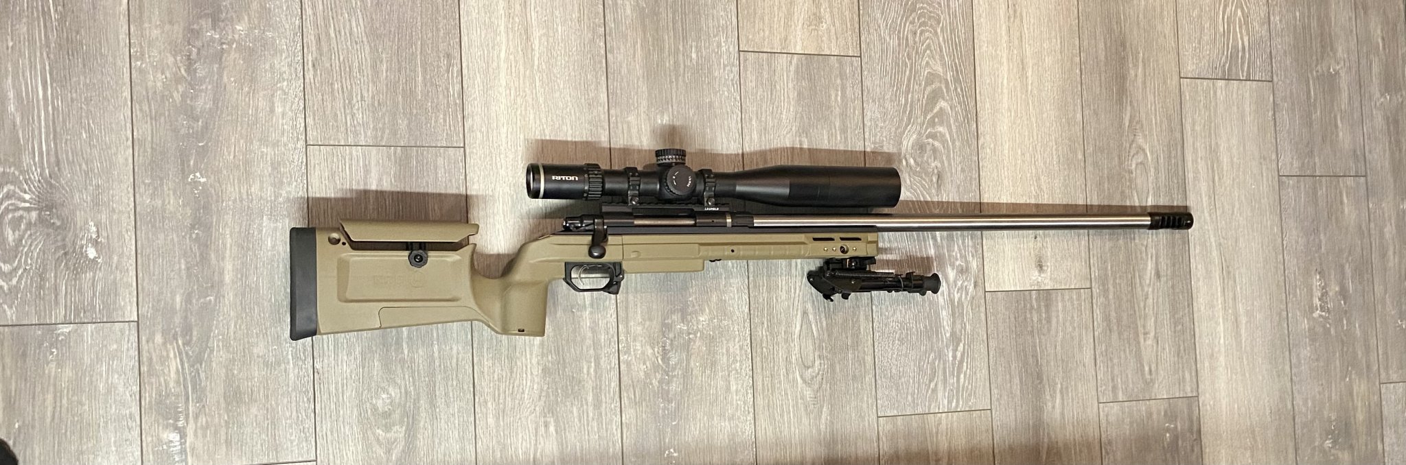

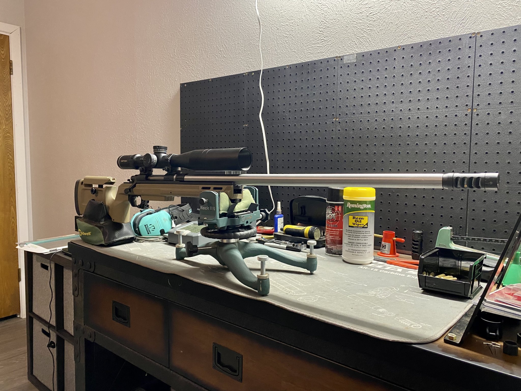

The build is so close I can smell the gun powder. Just need a mag

Wow man that’s awesome, I will send you a pm! This community here has been great for a newb like myself!
Big shout out to @MikeRTacOps for sending me a set of two piece bases! These are definitely my favorite bases and I might just have to switch out the 1 piece bases on my other rifles. Called him yesterday to tell him thanks and he returned my call today. Told me if I need anything else to just let him know! Will definitely be doing business with him.

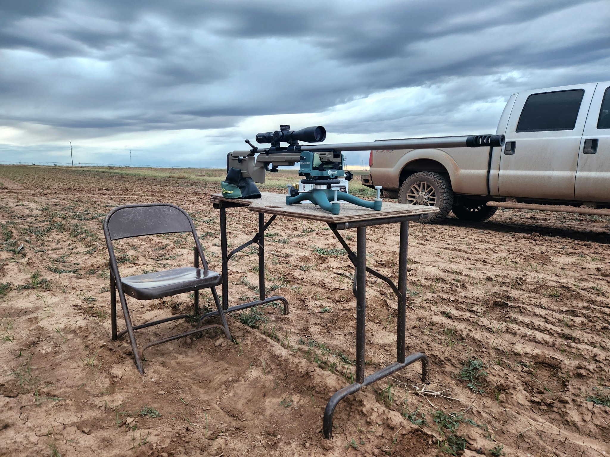

Took the rifle out today and got it sighted in shooting factory 300 PRC Hornady 225 ELD M. 🔥🔥🔥
