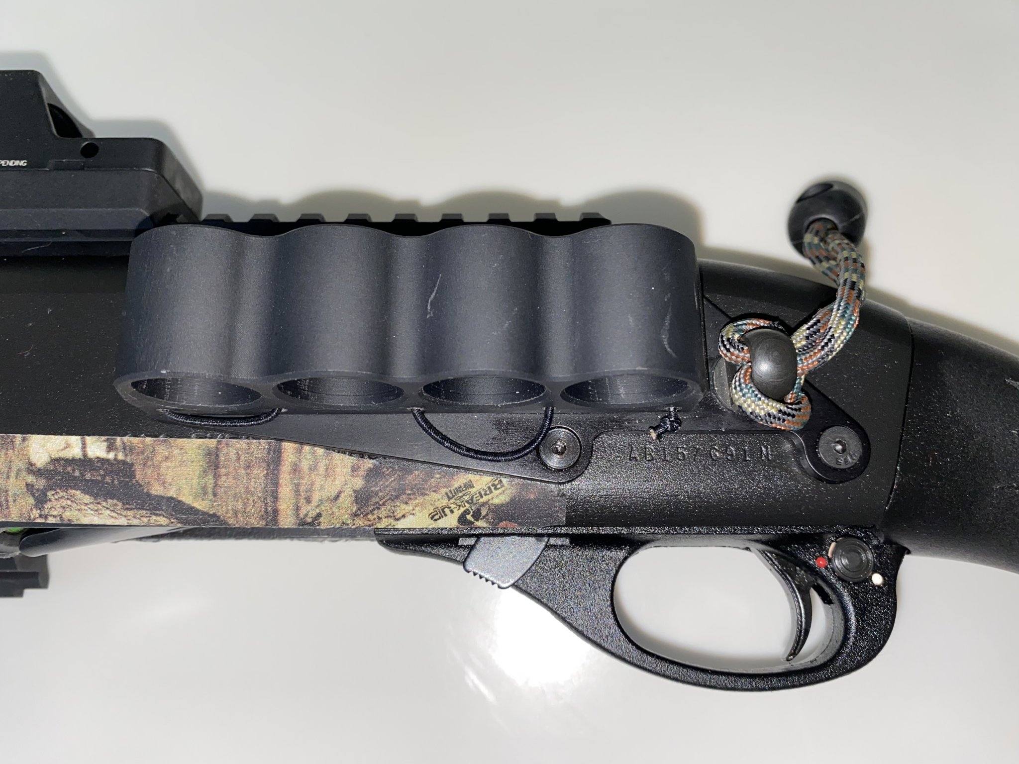

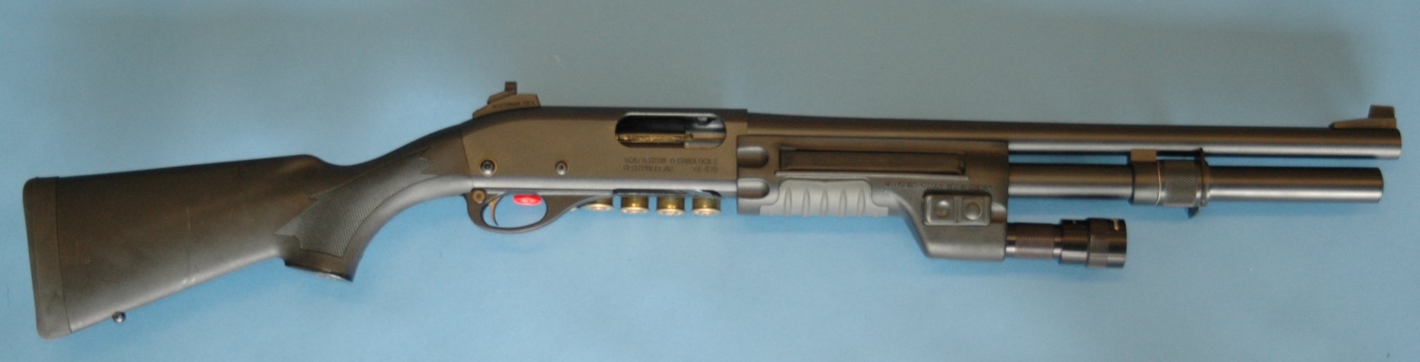

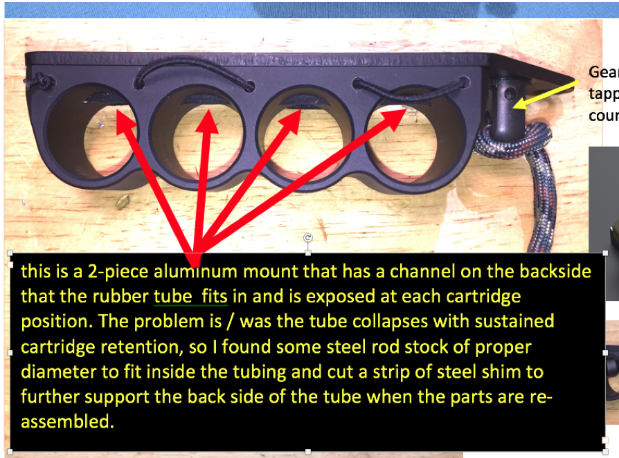

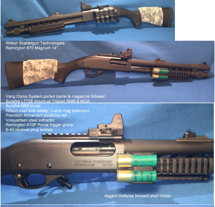

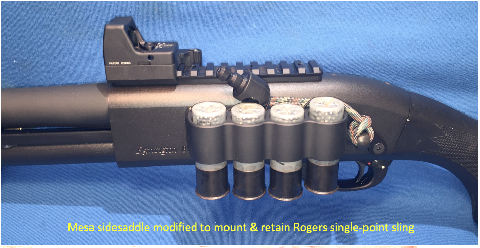

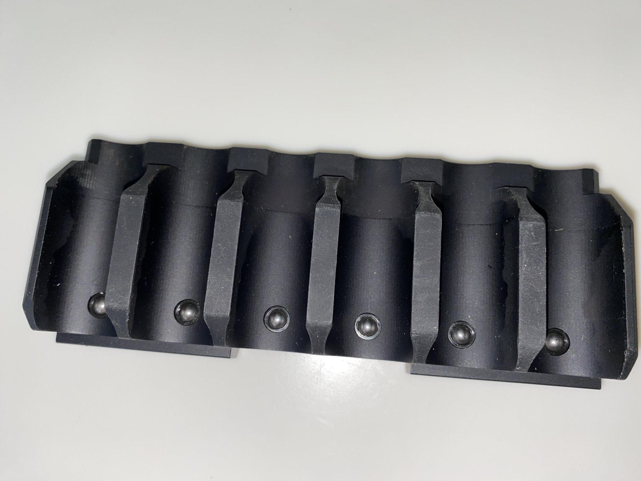

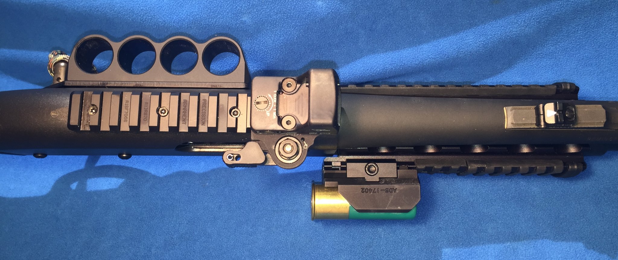

I used a Mesa SideSaddle that I also modified to optimize cartridge retention. Years ago I started out with the 18" Wilson Scatterguns Technologies 870 and quickly decided the weight of the filled extended magazine tube combined with the bulky surefire forend was not only heavy to support it really was sluggish getting the weight to move / stop on target transitions. Modified it to 14" with a 4 shell sidesaddle and 2 shell Asgaard forward shell holder (which are really handy for fast single loading or change cartridge choices); providing a total of 12 rounds (5+1), sidesaddle=4, forward holder=2) available on the gun.
A common problem with rigid side saddles is either too much retention friction slowing down extraction efforts or too little friction allowing them to fall out upon recoil. Mesa uses a rubber tube that fits within a channel , exposing the tube at each cartridge holder to provide the friction; problem is when cartridges are retained there for a short period of time, the tube compliantly compresses with the consequence of less retention force.
Maybe the best sidesaddle is made by Asgaard Defense that I use on a 14" Benelli M4 Entry; instead of rubber / silicone friction points they used ball bearings which of course did not suffer prolonged retention problems.
I also find that 4 cartridge sidesaddles usually sufficient for most course of fires.
I am surprised to hear Sig course requires a sidesaddle.

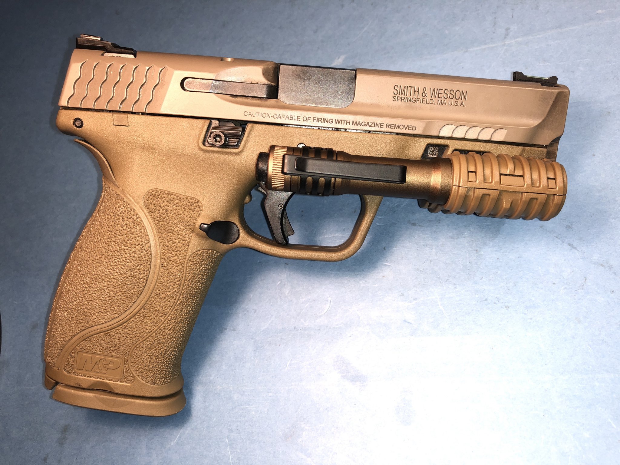

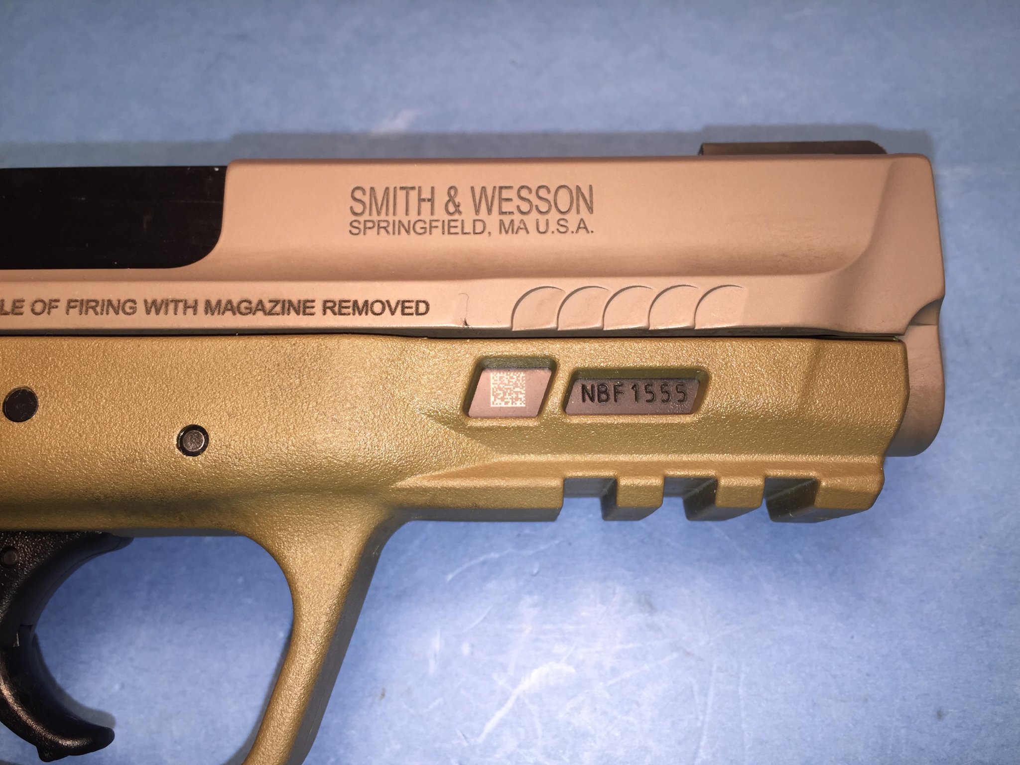

Riddle-him- this: I guess shooting an M&P with a rail light that covers the Serial No. would be prohibited as well?

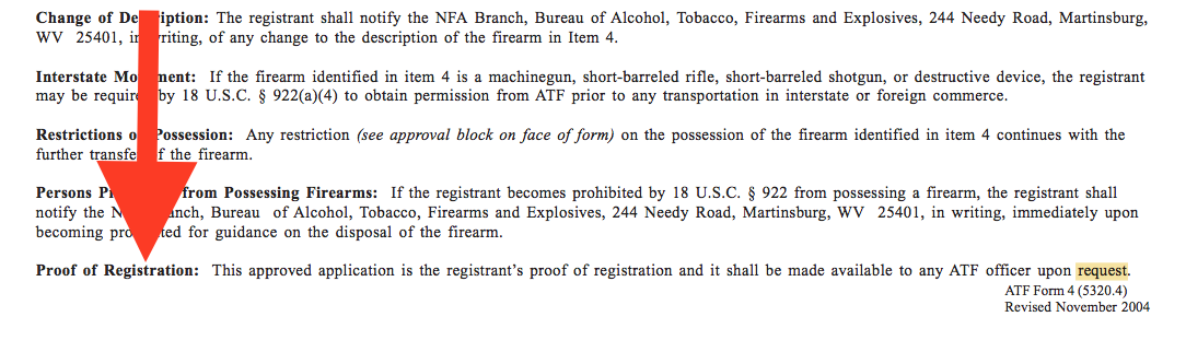

Only BATFE agents have the authority to "make available to see your ATF registration", it does not state you must produce it right there in then, in fact you could send by fax / email later in the day to the agents regional office. Such a registration is not like a driver's license that is required to be produced roadside. The BATFE registration is more like a IRS 1040 tax form to be produced as necessary, certainly no one carries theirs about with them. I do however keep a photo of all BATFE stamps on iPhone to show a BATFE agent, so legal theory does not ruin my day, just in case.

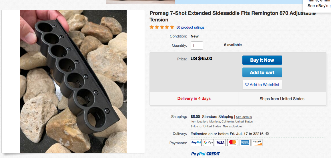

I don't have any special links for the side saddle. I did see this one that has adjustable tensioning.
