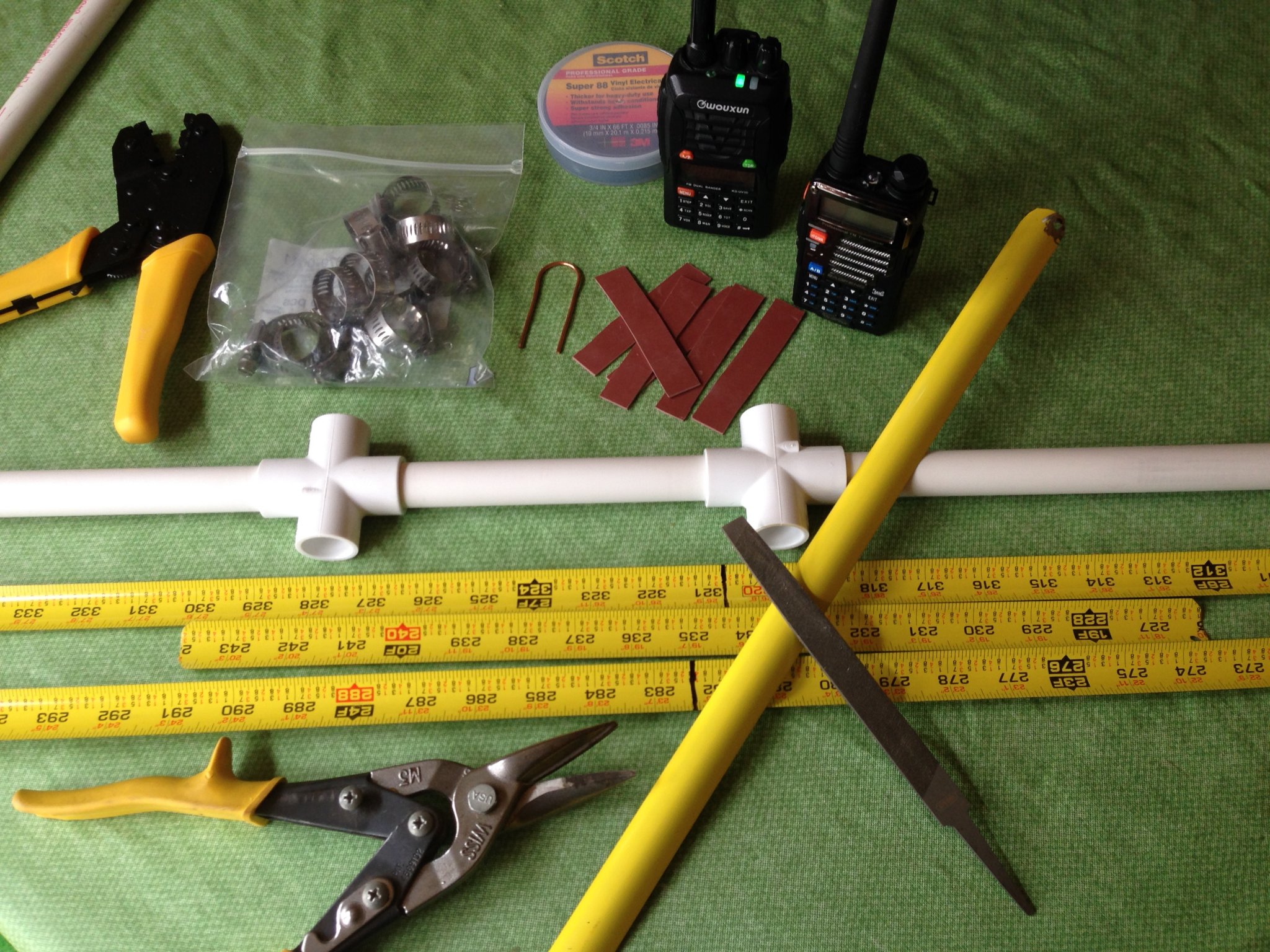

    This is what we've put together so far. I still have to pick up some cable and some 'ends' to connect to different hand-helds. Figuring about 6' of cable, or for those who've used these before, what do you suggest? 2', 3', thoughts? Just trying to make it convenient to use.
    Going to put an 'end' on it, and seeing as I have two different portables (and each have different antenna connections) I was going to make a 'transition piece' for each of them. Is there a 'standard' antenna connection for me to think of using, and then make up little 6" 'transitions' or whatever, to match whichever radio I'll be using this with. Now and in the future?
    We've a Yeasu 6 here, and a Feng 5x so far. One day we'll have a mobile and a marine and a base/tower. Point is, I'm trying to make this antenna as 'ambidextrous' as I can. As opposed to 'dedicated'. Simply because, I've no idea which radio I should dedicate this to, IF that were to be a good idea or not. I don't even know that answer, hence why I'm trying to make it work for everything now, and in the future.

    2.5'-3.5' works good.
    I'd do a BNC on the coax then get the correct SMA/BNC for the transceivers. Looks good so far, just make sure you get a good connection to the steel tape an you should be on your way. Have you ever hunted hidden transmitters before? If not there are some good fox & hound videos on you tube. One thing some don't point out is once you get real close or the signal is strong an bouncing off local stuff, move the VFO slightly off freq an the receiver will not get over loaded. Much like narrowing your receive beam to a pin point RDF.
    Reactions: Sean the Nailer

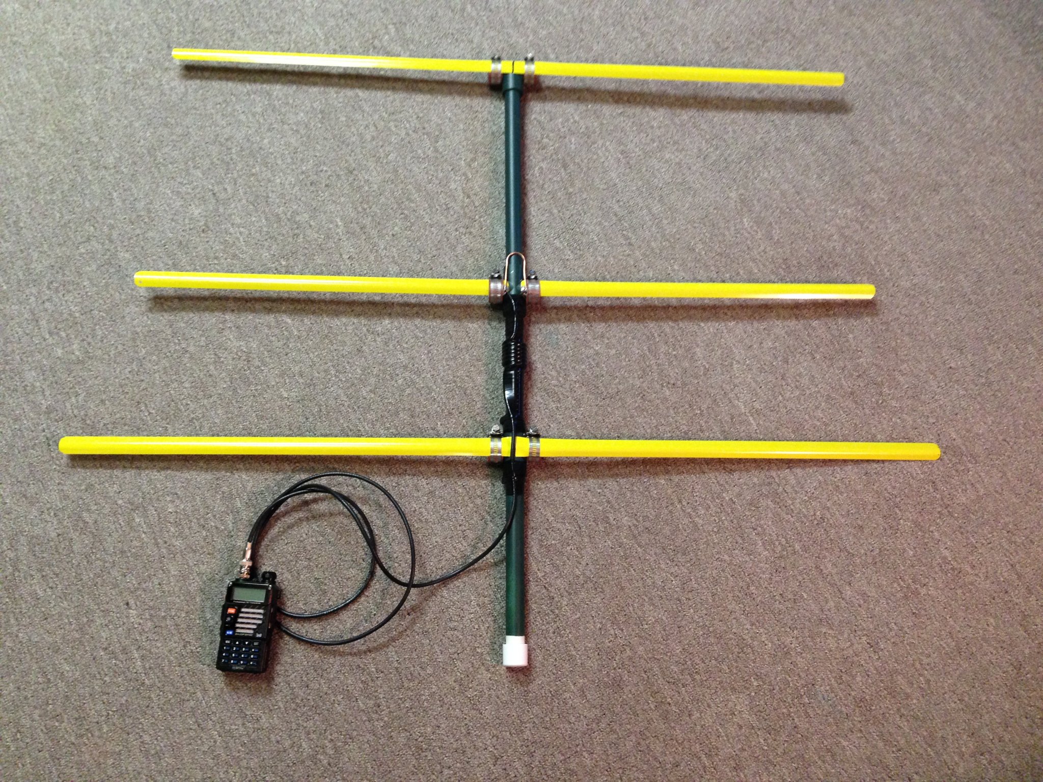

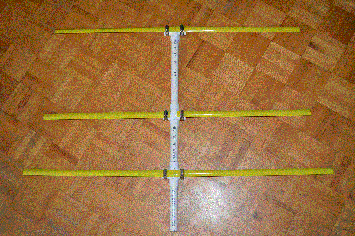

    Soldered this all up last night. Hoping to connect with someone local here, that knows more about these things than I, possibly has a SWR meter (that's what it's called?) and is able to give me a hand to test/tune/tweak this project.
    I'm hesitant to connect it to my Yaesu yet, as I know that I don't know what I'm doing, and I REALLY don't want to fry anything. Only antenna connection I've got so far (from local supplier) is for the Yaesu radio. Do have the BNC connections though.

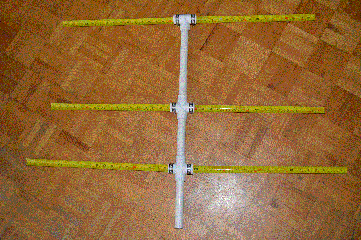

    These tape measure Yagi antennas work great for direction finding and focused transmitting. I've made HT to HT distance connections where standard hi-gain whips will not even clear the noise floor on open squelch. That connection was using the Yagi on one side where the other had just the hi-gain. Adjusting the polarization horizontal vs vertical orientation will also help cut the signal reception and going slightly off frequency will help cut too for narrowing down detection signal azimuth.
    The wound coax taped over choke was suggested if being used for transmitting at the time we made these antennas. Instructions were pulled some web found instructions. I still think about picking up a semi-commercial made version too.

    Very nice job on radius'ing the ends, that is an area that is very important.
    Yea the wound coax makes a good RF choke, encase RF is running the skin(coax). Most HT's even set to high with the SWR way off will not bite much at all. A base station running above 25 watts will get your attention though. However if the antenna is 50 ohm at the feed point the odds of RF running the skin is low if it's fed with 50 ohm feed line. The other thing you can do is add Ferrite's either before soldering or the ones that snap on thereafter. I like them before with heat shrink right at the feed point, makes a more compact package.
