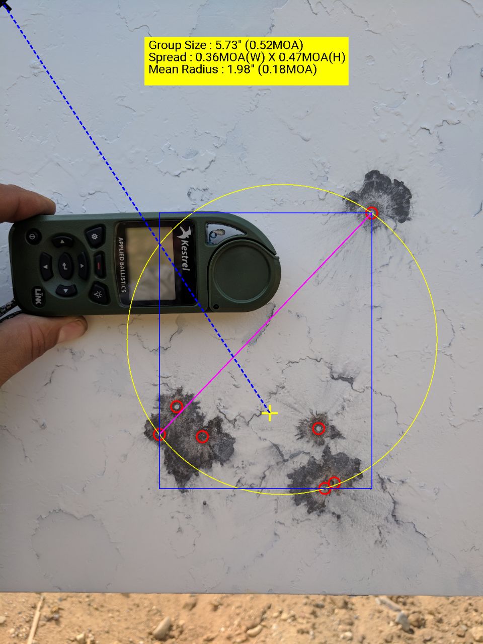

Buy it. It will shoot. I have the 26" 7.5T and it shot lights out for 2500+ rounds. I have plenty of load data for 90 SMK, 88 ELDMs, 80 Berger's, 80 SMKs, 75 ELD, 75 BTHP, 73 ELDM and 69 SMKs if you need starting points.
Here is what mine produced with 88 ELD handloads shot at 1050yds:

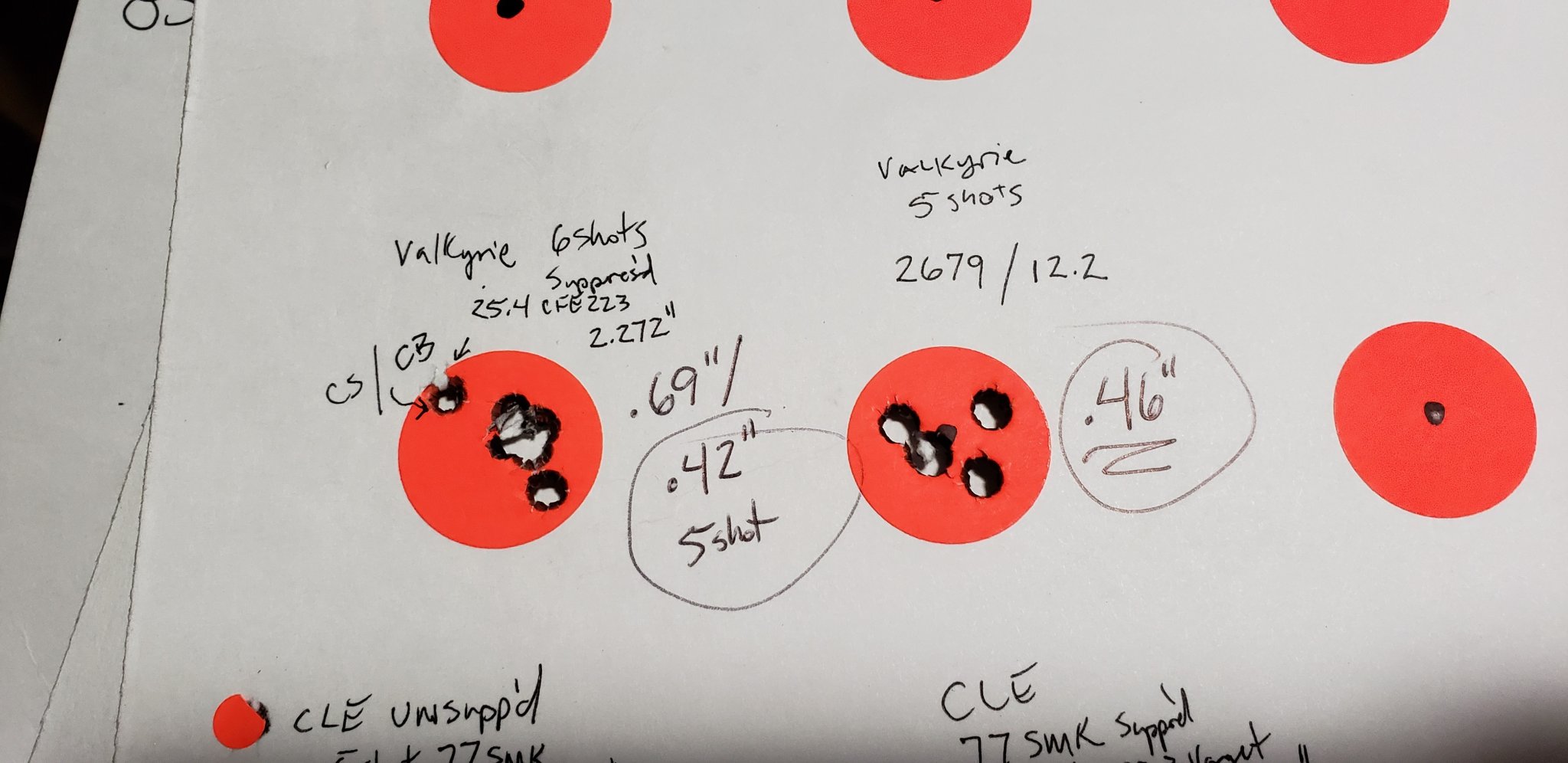

Here are some 100yd groups from that load:

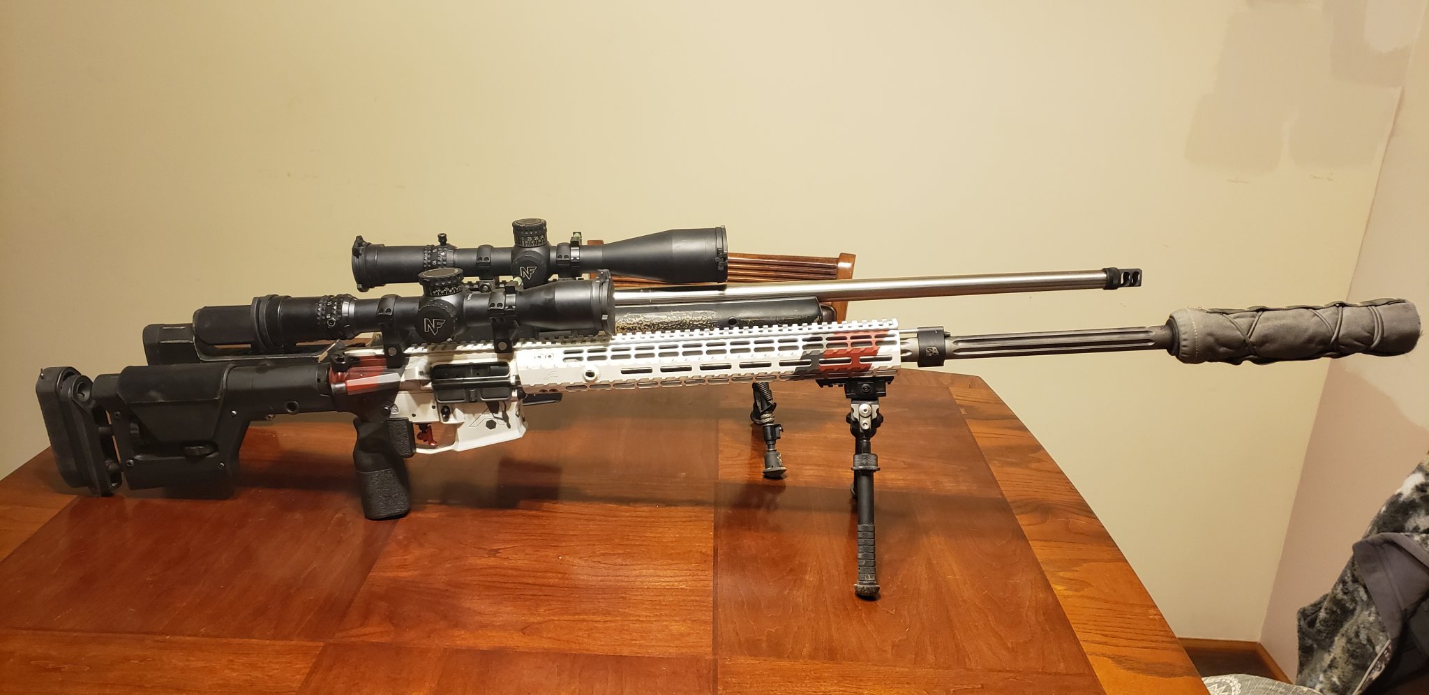

And here is rifle next to my 26" bolt 6.5CM:
