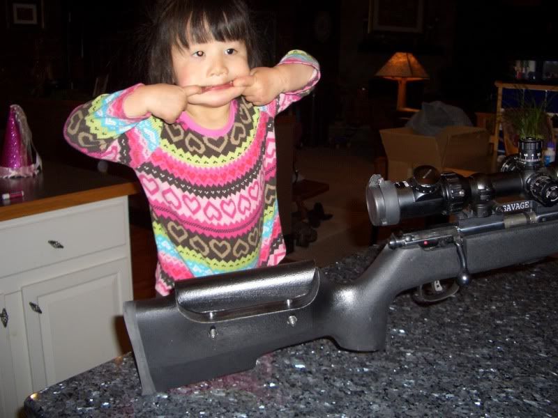

I just finished the mods described in the link up top. Took me about 2 hours. I own a well equipped cabinet shop, but we don't have a scroll saw so I used a coping saw. Tough to get a clean cut. It's not near as clean as the ones in the link, but it's not an eyesore and it's extremely functional.
As soon as the paint is dry and I put the rifle back together, I'll post up some pics of the finished product.

<div class="ubbcode-block"><div class="ubbcode-header">Originally Posted By: Tim K</div><div class="ubbcode-body">Finished product. The set screws are too long, but I'll fix that tomorrow.
</div></div>
hahahaha....did she not like your stock work ? looks good to me.

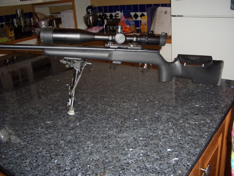

Nice work phideax. I planned to do a similar upgrade to my tacticool. What size nut inserts did you use? Where did you get them? Did you compress and glue them in or only glue them? Did you drill through the top of the stock prior to cutting the guide holes? If not how did you line up the rods and guide holes and still have an intimate fit of top and bottom? Sorry about all the questions. Some of the answers were not apparent on the tutorial link.

<div class="ubbcode-block"><div class="ubbcode-header">Originally Posted By: TrapperJ</div><div class="ubbcode-body">Nice work phideax. I planned to do a similar upgrade to my tacticool. What size nut inserts did you use? Where did you get them? Did you compress and glue them in or only glue them? Did you drill through the top of the stock prior to cutting the guide holes? If not how did you line up the rods and guide holes and still have an intimate fit of top and bottom? Sorry about all the questions. Some of the answers were not apparent on the tutorial link. </div></div>
I used 1/4-20 inserts. They have coarse outside threads and simply screwed into the stock. They were in the screw isle at the local hardware store. No glue.
I drilled the holes in the cheek piece first, then used dowel transfer points to mark the appropriate locations on the stock. If you don't have those, you could make some by buying some short bolts of the same size and pitch and cutting them so they just clear the cheekpiece, then grinding points on them to transfer the location.
