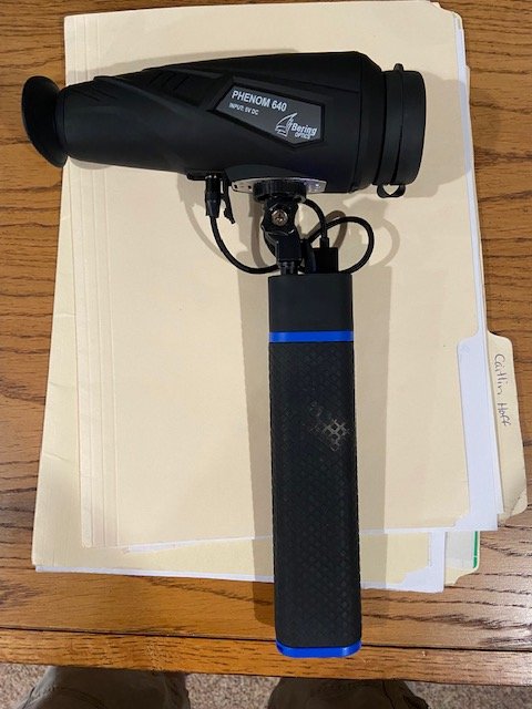

Phenom showed up today. Seems like an impressive device. Just did a little looking down in the creek on the shady side of the house. I'm nervous of getting that big objective out in direct sunlight so will have to wait a few hours to have a real look around.
Enjoy, I love mine. Let us know your impressions after you use it.
One thing I wanted to point out was your guys site and I think most of the other ones I'd looked at have it listed as a 2.5x and its a 2x. I've seen the nox 35 also listed as a 2.0 when N-vision has it as 2.5. I don't care and the mag is perfect but somebody might.
So to the device I'd say its the most performance you can get for your $ right now. Imige quality is up there with the nox and I'd assume triji and iray stuff. The image is different than the nox and I think they will compliment each other.

The reason for the confusion is when Bering Optics originally released the Phenom, it had a 17µm sensor and the unit had 2x base mag and a 17° FOV. Earlier this year Bering released their Phenom 12µm which has a 13° FOV and has a base mag of 2.5x. If you purchased it from Night Goggles, all of our Phenoms currently being sold are the newer 12µm, 2.5x. Bering is no longer actively producing the Phenom with the 17µm sensor. However, a lot of Bering's documentation and even their website still shows the specs for the 17µm version.
Gotcha. Yeah its from you guys. They might want to look into that. Mine is listed as 2.0x and 12um. Also 12.5° fov.
It works good so whatever.
