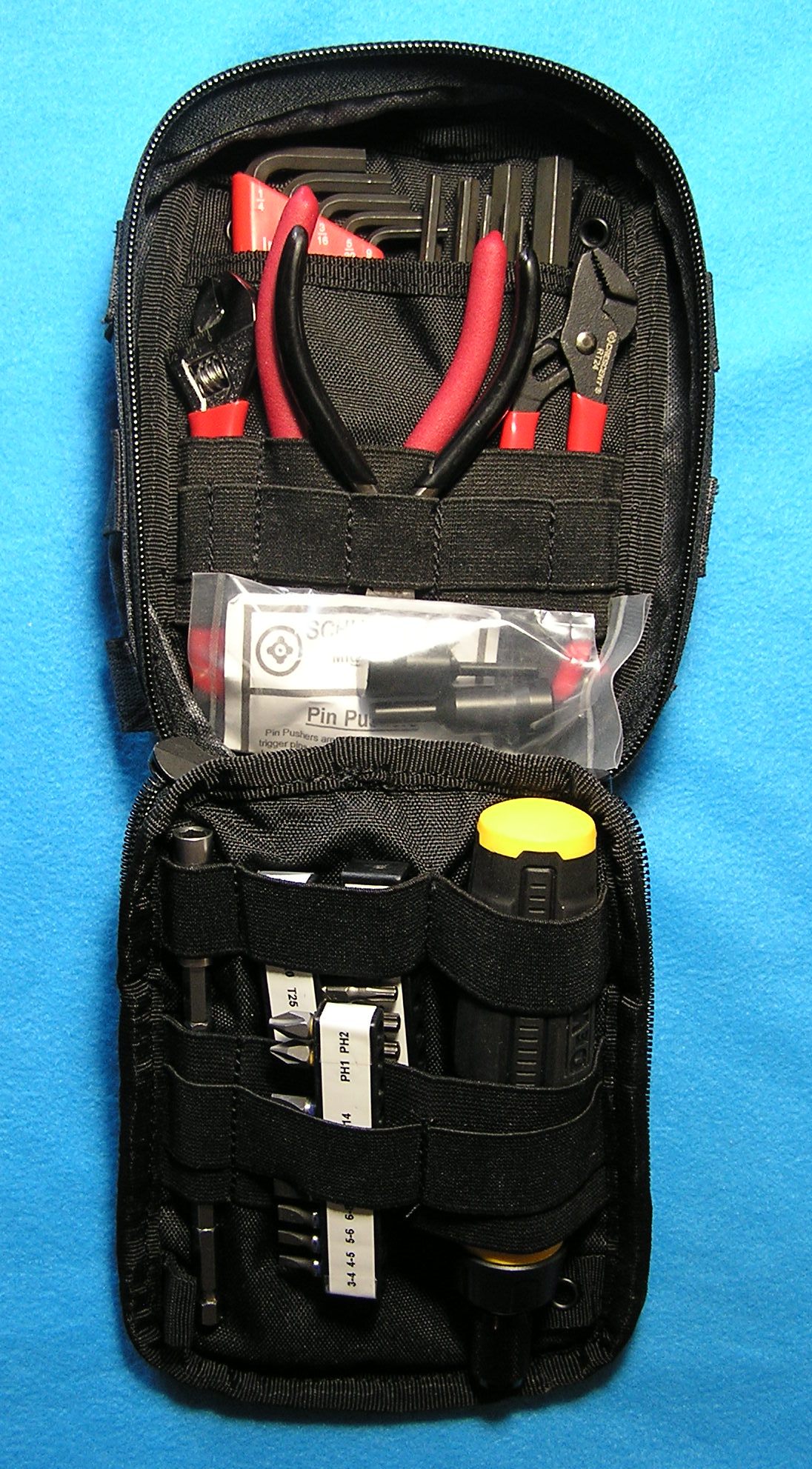

    I am constantly surprised about the number of people that do not carry a basic tool kit in either their gun case or range bag when they go to the range. I can be at an indoor or outdoor range and hear people asking others if they have a Torx or Hex wrench or even a screwdriver and not only does the person needing the tool not have it but the people they are asking don’t either. So I thought I would share with everyone a tool kit that I put together a couple years ago that I carry in my range bag. It is complete enough to get through the common problems but not too big and heavy to solve every problem that could possibly occur. It has worked out well for me and I have never had a need for anything else. I hope this can be helpful to others looking to do something similar.
    I have another small bag that contains a small amount of gun oil and cleaner as well as patches, jags, lens pen, etc., just in case. Also, in each of my gun cases I also carry tools specific to that gun, like Fix-It sticks for my Sphur mounts, the tiny hex wrench’s for lasers, etc. There is no sense carrying those tools, and the additional bulk and weight, in the range bag if I am only shooting pistols for instance.
    I have included the manufacturer of each tool along with the manufacturer’s part number and what the cost of each tool was, minus shipping, when I purchased it. The bag weighs 2 lbs 13 oz and the loaded dimensions are 6” Wide x 7.5” Long x 3.5” Thick. The total cost was about $205 plus some shipping costs. As a note, the reason I chose the screwdriver handle that I did was because I wanted to be able to get to the socket head cap screw that secures an AR-10/15 handle and still be short enough to fit in the tool bag.
    DescriptionManufacturerMFG Part NumberNotesCost
    Side Utility Pouch - TyphonKryptekCUKR18-A158-TYPIncludes Unit Patch
    $49.99​

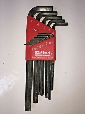

    Hex Key Set Short - SAEEklind10111.050 - 1/4 - 11 Tools
    $5.35​

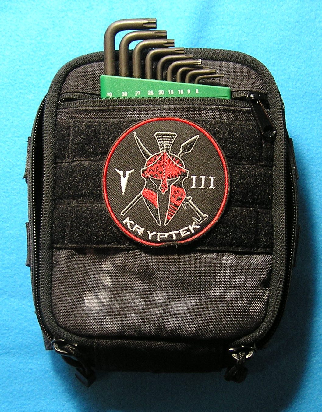

    Torx L-Key Set - ShortWiha36394T8, T9, T10, T15, T20, T25, T27, T30, T40
    $28.24​

    Thanks for your response and suggestion. Yes, I am thinking about adding a small hammer. I haven't because "so far" I haven't needed one. I probably just jinxed myself by writing that. :LOL:

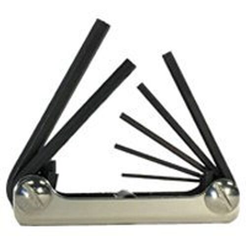

    But random question: as most may have seen, hex wrenches screw and multiply faster than pigs. I always seem to end up with so many random hex wrenches of unknown size. What does the group do to help quickly figure how what sizes they are? I have some slow/manual ways but would be great to speed through them quickly and label them.
    Reactions: DustBun
    Great post, and also dog pile on the borka kit, I dont leave home without it.
    Something like this,
    or this.
