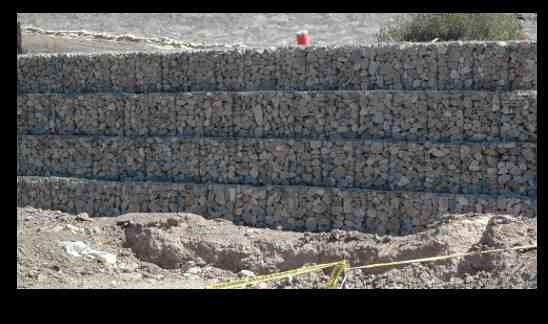

Almost sounds like something such as a gabion style basket could be used to create the nesecary berm with cutting down on its size. Never heard of these being used on a shooting backstop - berm but I've always been curious and thought that they'd be slick. Anyone have experience using these? Possibly even line the basket with fabric and use a clay fill in front of some filled with rock?

Never heard of a gabion basket until now. Looks like a wire basket filled with rocks. I don't think I'd want to shoot into that for sure. I understand where you said line it with fabric then fill with sand, but I'd still not want to use it for a backstop, I could see for the sides of a C shaped berm maybe, but if I were going to do that, I'd rather make a wall of tires filled with sand instead of that, probably make a good backstop too.
