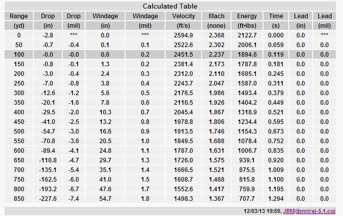

If you increase the BP to about 31 inHG or decrease altitude to 2600 you start to get close.
Are you sure you have 2.75" above the bore centerline.
If I use a 2.0" height over bore (typical for most receivers/rings/scope setups), the field trajectory you saw is nearly nuts on with what JBM spits out, +/- 0.1mil. I'd remeasure your height over bore.
Beyond that, your chrono numbers are probably your biggest source of error, but it looks close enough to make you dangerous if that height over bore number is the source of the error.

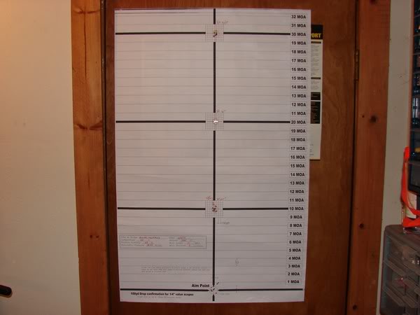

The FIRST thing you need to do is a full-range scope elevation tracking test, by setting up a tall target at 50 or 100 yards, and ensuring the scope tracks. I don't care if you have a Simmons, Bushnell or Bender.
All exterior ballistic measurments and calculations rely on this being correct, and it shall not be skipped.
It's kind of like tyring a new camshaft in an engine down on power and smoking - before doing a compression/leakdown test. The compression/leakdown tells you instantly whether or not you even have an engine to begin with.
Good advise! I skipped this step.

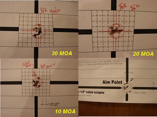

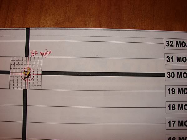

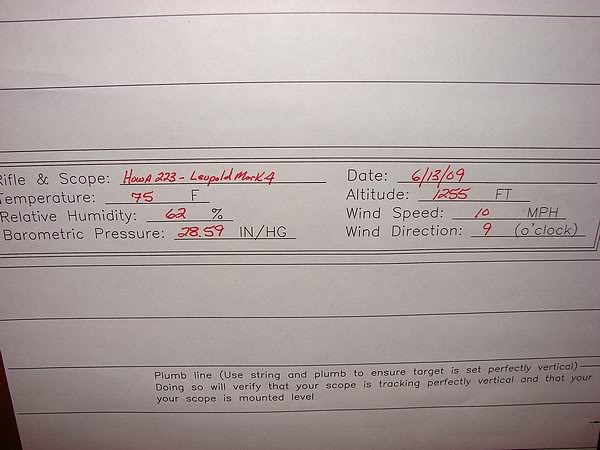

Here is a copy of the target I drew up for scope confirmation of tracking.
Set the target at 100yds, make sure the target is plumb (I use a string and
plumb bob). Aim at bottom of target and work your way up on your come ups.
Then run it all the way back down and ensure it zero's.
Target has to be set at 100yds exact.
Terry
