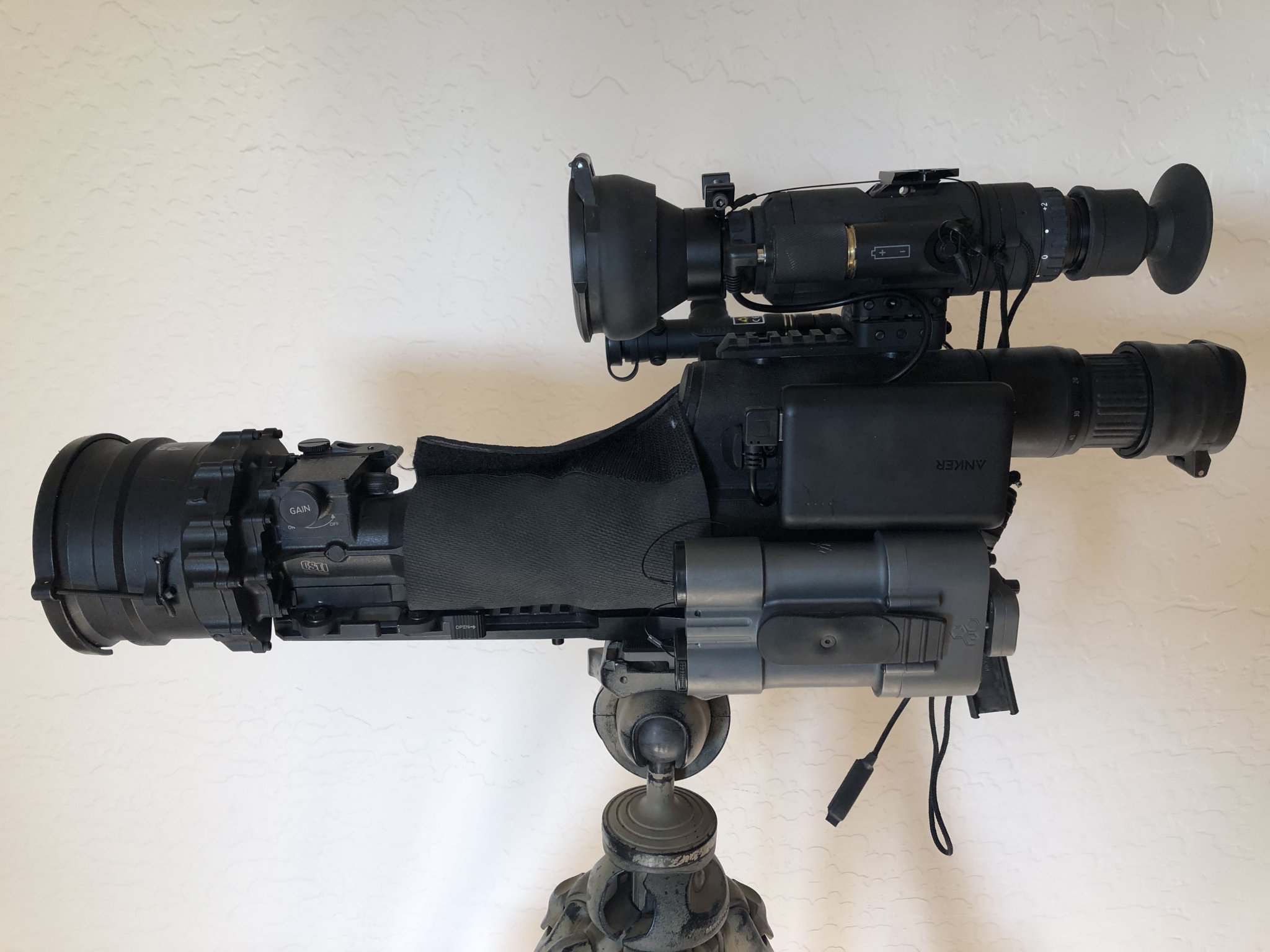

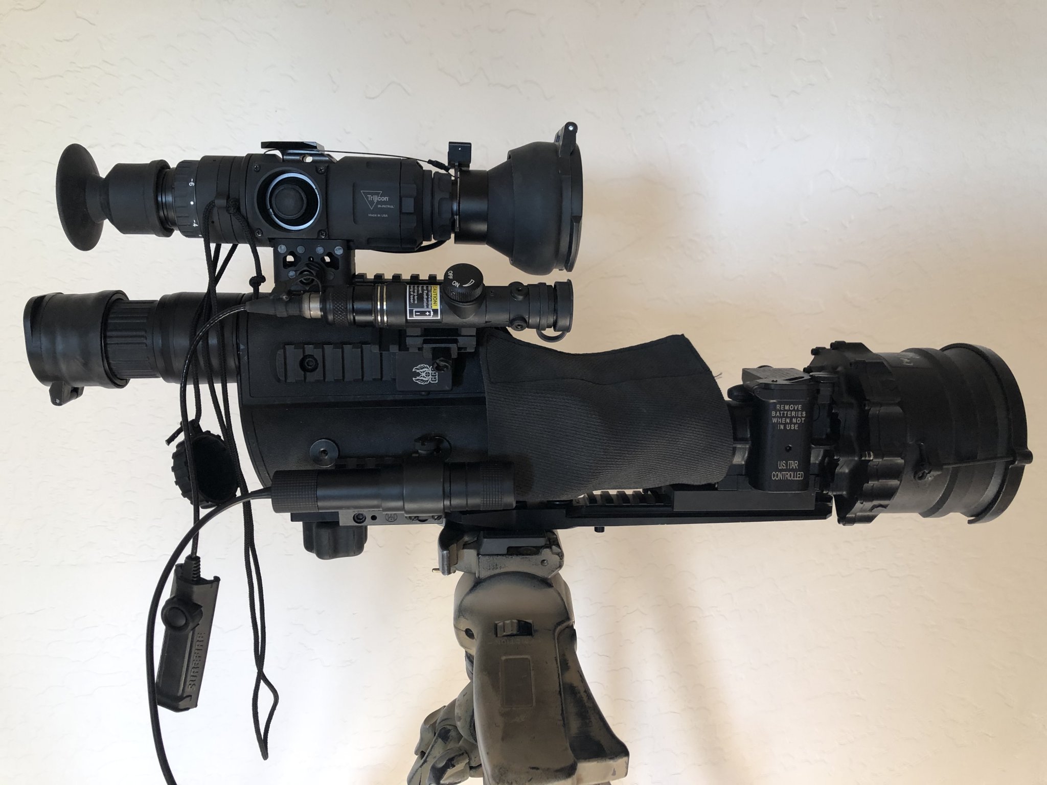

I slave a Raptar-S via TracIR to a SkeetIR-X or UTM-X. I have put together a “prototype” twin bino Skeets, both with TP 2-4x afocal magnifiers, and the Rap-S with TracIR cable. This give you true in-display ranging and AB firing solution. The Rap-S can also be slaved via BT to a Kestrel, if desired. I’ve been able to range ~4Km reliably in some harsh conditions that no Vis/NV-only would be able to see or detect.

@CoryT - thanks for sharing this Bud. Can you break this down a bit for me to understand what all equipment is shown here, how it comes together and is used,..thanks. If you can do the same for vector set up that will be great as well. In case there is some youtube video/link, that will be super convinient. Appreciate all the help.
On top is an M300W with a 3x optical magnifier, this is running off the Anker battery pack. Thermals eat batteries like candy, so you really want external battery capabilities. Below the battery pack is a Silencerco Radius LRF. No longer made, next closest thing is a Wilcox RAPTAR. On the optics rail there is a PVS-27. The bottom end magnification on the Leupold spotter is 12x, the 27 provides quite a good image. On the right side there is a Luna ELIR laser illumination. I run that, or a DBAL-A2 or a MAWL.
This provides thermal and I2 on the same mount and the LRF is slaved to the spotter reticle. The Radius uses a 905nm laser, so I can see the beam on the target.

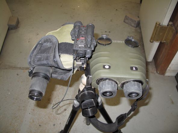

The Vector setup is a bit cleaner. Spotter on the left cowitnessed to the Vector. Then an Attila 200 for laser pointer and illum. With the standard Vector, we connect a PVS 14 to the right eyepiece and set the display to night mode. The spotter can have either a clip on like the 27 or another PVS-14. Using the right mounts the 14s are basically locked in place. Then I just scan with the thermal from a neck lanyard.
I normally wear a bino NVG, like the DTNVS where I can flip up one side to view either the Vector or the spotter. I often don’t bother with the spotter though, only using that if I’m planning on shooting past 600-800, otherwise the Vector does the spotting no problem. Now with just that on the tripod, I can just fold the legs and pickup and move. The big spotter setup is too bulky to really do that.
